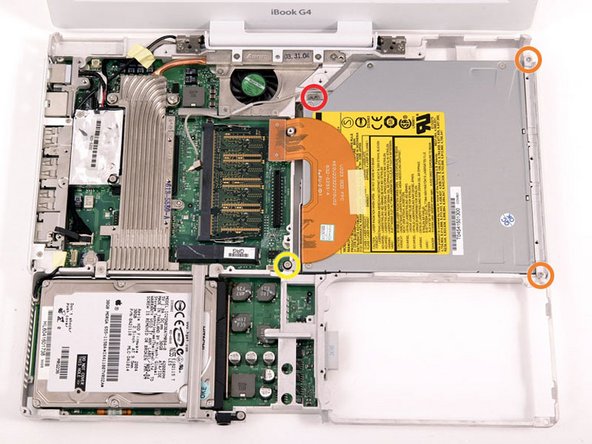

Add Note Edit Step 36 — Optical Drive  ¶
  • Remove the following 4 screws:
    • One 3 mm Phillips in the channel between the optical drive and fan.
    • Two 6 mm Phillips from either end of the drive bezel.
    • One 6 mm Phillips with a collar from the bracket extending from the lower left corner of the drive.
Image #1

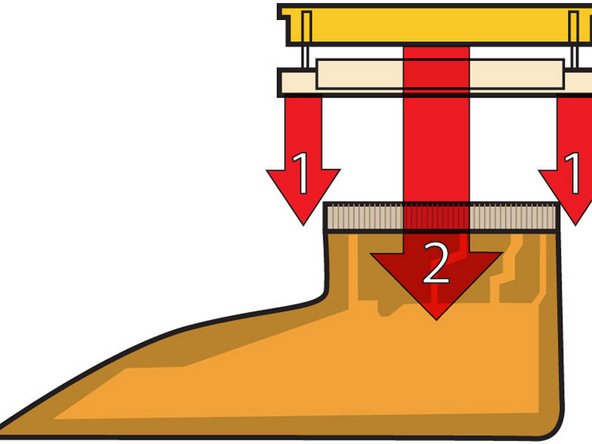

Add Note Edit Step 38  ¶
  • This is a diagram of the ribbon clamp connector you will disconnect in the next step.
  • 1) With your fingernails, grasp the locking bar on either side and pull up a small amount (about 1/16" or 2 mm).
  • 2) After disengaging the locking bar, slide the cable out of the connector.
Image #1

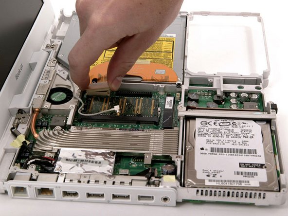

Add Note Edit Step 39  ¶
  • Release the optical drive ribbon clamp as described above. Slide the optical drive ribbon out of its connector.
Image #1

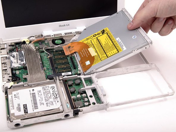

Add Note Edit Step 40  ¶

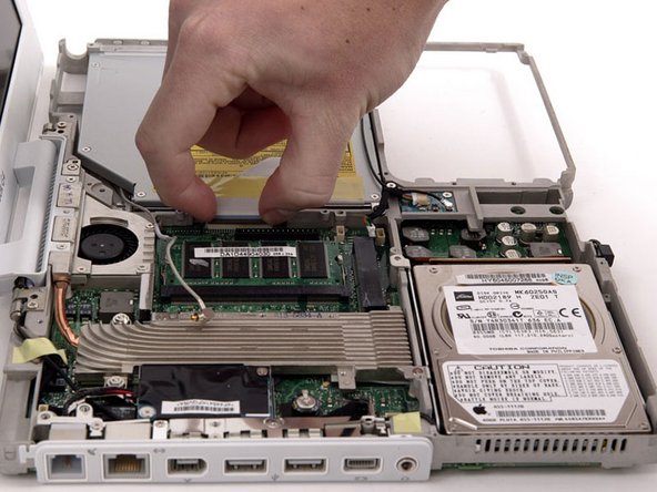

  • Lift the optical drive from the metal framework.
Image #1
