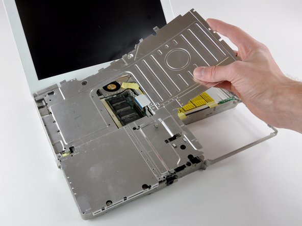

Image #1
Add Note Edit Step 28 — Top Shield  ¶
  • Remove the fifteen 3 mm Phillips screws securing the top shield to the computer.
Image #1
Add Note Edit Step 29  ¶
  • Lift the top shield up from the right side, minding the upper left corner, which may catch on the metal framework.
