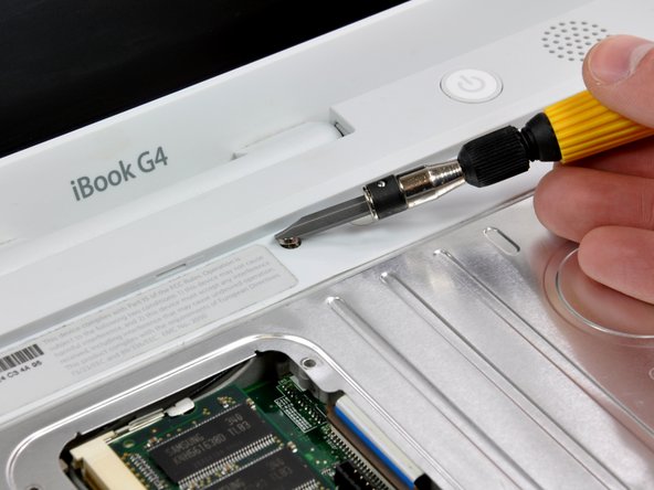

  • Pull the keyboard release tabs toward you and lift up on the keyboard until it pops free.
  • If the keyboard does not come free, use a small flathead screwdriver to turn the keyboard locking screw 180 degrees in either direction and try again.
  • Flip the keyboard over, away from the screen, and rest it face-down on the trackpad area.

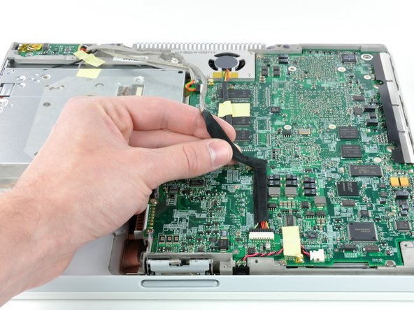

  • Deroute the cable from around the optical drive, removing tape as necessary.
  • Disconnect the DC-In cable from the logic board and angle the DC-In board out of its compartment.

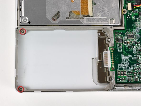

  • Remove the two 3 mm Phillips screws inside the left edge of the battery tray.

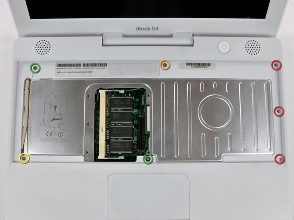

  • Remove the following 7 screws from the edges of the keyboard area.
    • Three 2 mm Phillips along the right edge.
    • One 4.5 mm Phillips underneath where the magnet was.
    • One 6 mm Phillips with a small head in the lower left corner.
    • Two 6 mm Phillips with large heads, one in the upper left corner and one in the middle.

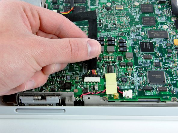

  • Using the sharp end of a spudger, disconnect the connector for the blue and white power cables. Again, be careful to pry up only on the connector.
  • The key is to apply force in two directions, down to keep the surface board connections intact, up to release the connector.
  • The upper case is now free and can be removed from the computer.
