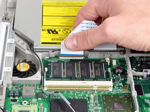

    • Pull the keyboard cable up from the logic board, holding the cable as close to the connector as possible.
    • Make sure that you reconnect the keyboard cable before replacing the RAM shield.

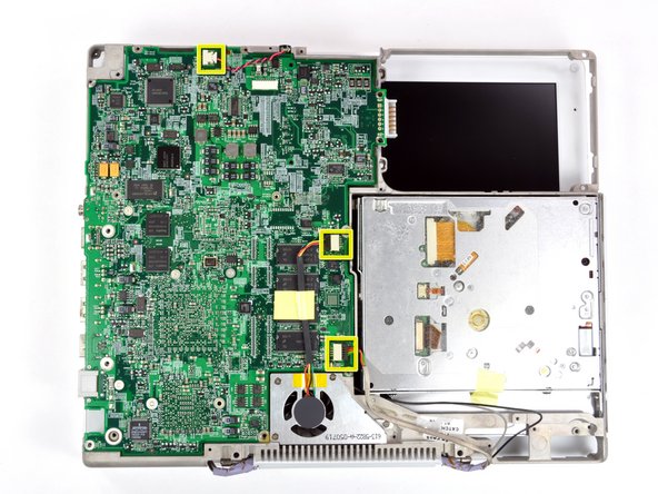

    • Before you can yank the upper case off, you must disconnect the trackpad connector, the blue and white power cable, and speaker cable as described in the next steps. Be especially careful with these cables; never pull directly on the cables, but use a spudger to pry up the connector directly.
    • Carefully lift the upper case slightly and move it toward the front of the computer to reveal the trackpad connector. Use a spudger or your finger to disconnect the trackpad connector hidden beneath the white plastic tab.
    • After disconnecting the track pad connector, carefully rotate the upper case away from you and rest it against the display.

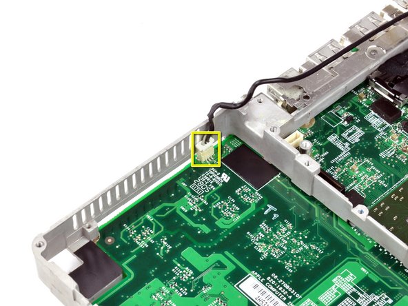

  25. iBook G4 12" 1.33 GHz Logic Board Replacement: step 26, image 1 of 1
    • The connectors at the ends of the following cables are attached very firmly to the sockets on the logic board. Pulling directly on the cable will either separate the cable from its connector or the socket from the logic board.
    • Use the sharp end of a spudger to disconnect the speaker cable connector.

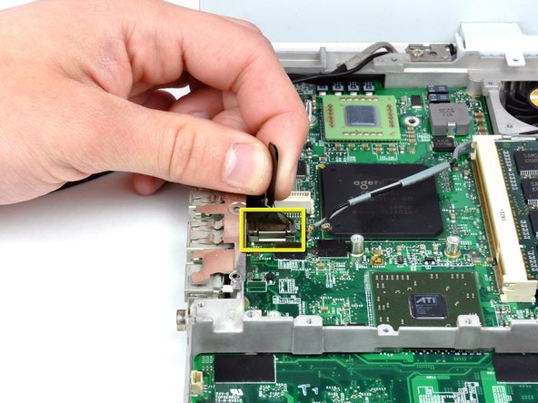

  26. iBook G4 12" 1.33 GHz Logic Board Replacement: step 27, image 1 of 2 iBook G4 12" 1.33 GHz Logic Board Replacement: step 27, image 2 of 2
    • Using the sharp end of a spudger, disconnect the connector for the blue and white power cables. Again, be careful to pry up only on the connector.
    • It is very easy to break the connector from the board, so be careful.
    • The key is to apply force in two directions, down to keep the surface board connections intact, up to release the connector.
    • The upper case is now free and can be removed from the computer.

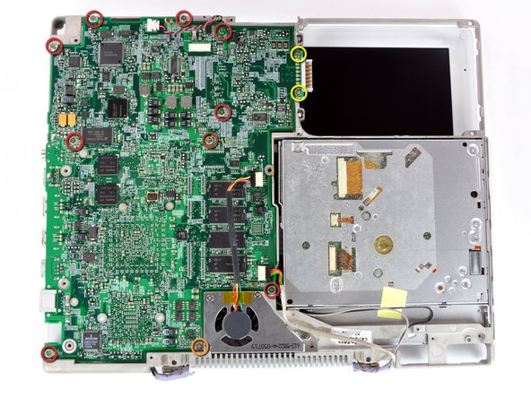

  34. iBook G4 12" 1.33 GHz Logic Board Replacement, Heat Sink: step 35, image 1 of 1
    • Remove the following three screws:
    • Two 3mm Phillips screws.
    • One 7.5 mm Phillips screw.
    • Lift the small plastic retaining bracket up and out of the computer.

    • Remove the following 7 screws and 2 nuts from the heat sink:
    • One 3.5 mm Phillips from the lower left corner of the heat sink.
    • Five 6 mm Phillips from around the fan and at the center of the heat sink.
    • One 7.5 mm Phillips at the top right corner of the heat sink.
    • Two 4 mm screw nuts with attached springs from either side of the heat sink.

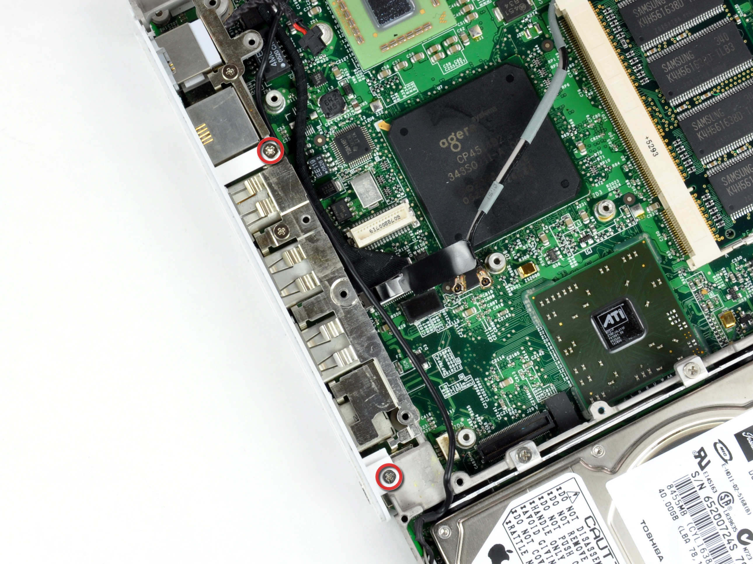

  42. iBook G4 12" 1.33 GHz Logic Board Replacement, Logic Board: step 43, image 1 of 1
    • Remove the two Phillips screws securing the white plastic fingers of the I/O bezel to the metal framework.
    • The longer screw goes into the longer finger, closer to the display.
  43. iBook G4 12" 1.33 GHz Logic Board Replacement: step 44, image 1 of 1
    • Lift up the left side of the computer and slide the I/O bezel away.

  48. iBook G4 12" 1.33 GHz Logic Board Replacement: step 49, image 1 of 1
    • The cable you're about to remove is very fragile - do not pull directly on the wires. Instead, try to pry up the connector directly, using a spudger or a small flathead screwdriver if necessary.
    • Disconnect the microphone cable at the front of the computer, between the left side of the hard drive and the metal framework.
  49. iBook G4 12" 1.33 GHz Logic Board Replacement: step 50, image 1 of 1
    • Use the black plastic handle to disconnect the display data cable from the logic board.

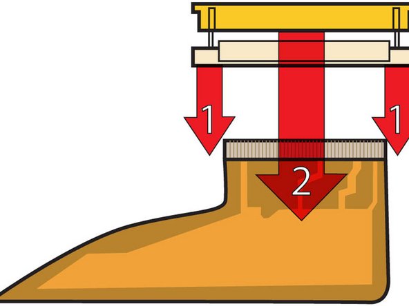

    • This is a diagram of the ribbon clamp connector you will disconnect in the next step.
    • 1) With your fingernails, grasp the locking bar on either side and pull up a small amount (about 1/16" or 2 mm).
    • 2) After disengaging the locking bar, slide the cable out of the connector.
  51. iBook G4 12" 1.33 GHz Logic Board Replacement: step 52, image 1 of 1
    • Release the optical drive ribbon clamp as described above. Slide the optical drive ribbon out of its connector.

    • Close the display and flip the computer over.
    • Remove the following 12 screws:
    • Nine 3 mm Phillips.
    • One 3 mm Phillips with a thicker shaft at the bottom right corner of the logic board, next to the fan.
    • Two 7.5 mm Phillips on either side of the battery connector.
  53. iBook G4 12" 1.33 GHz Logic Board Replacement: step 54, image 1 of 1
    • Disconnect the inverter, fan, and sleep light cables from the logic board.
    • When replacing the logic board, make sure that the inverter cable is not pinned under the logic board.
  54. iBook G4 12" 1.33 GHz Logic Board Replacement: step 55, image 1 of 1
    • Lift the logic board carefully from the computer.
    • Mind the thin metal EMI fingers surrounding the ports when replacing the logic board.
