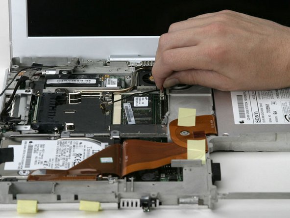

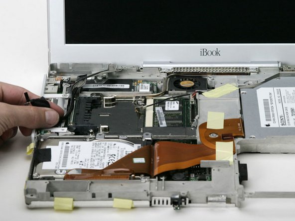

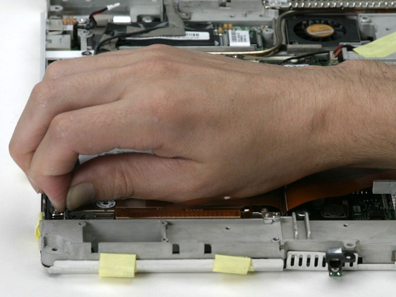

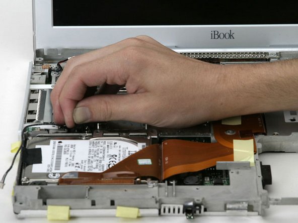

Add Note Edit Step 33  ¶
  • Use the black plastic handle to disconnect the display data cable from the logic board.
Image #1

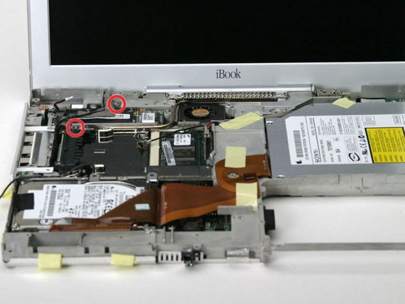

Add Note Edit Step 34  ¶
  • If you have already removed the modem, you will only need to remove one of these screws.
  • Remove the two Phillips screws securing the display data cable to the metal framework.
Image #1
Add Note Edit Step 35  ¶
  • Deroute the display data and microphone cables, removing tape as necessary.
Image #1

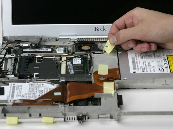

Add Note Edit Step 36  ¶
  • Peel back the yellow tape securing the inverter cable to the metal framework.
Image #1
Add Note Edit Step 37  ¶
  • Disconnect the inverter cable from the logic board.
  • Carefully deroute the inverter cable from beneath the optical drive.
Image #1

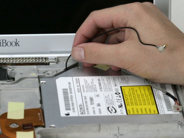

Add Note Edit Step 38  ¶
  • Deroute the AirPort antenna cable from beneath the optical drive.
Image #1

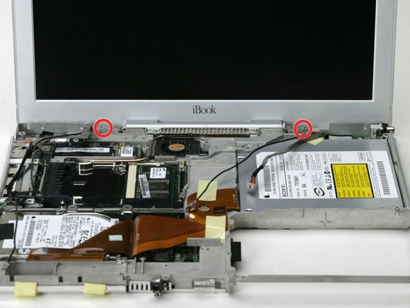

Add Note Edit Step 39  ¶
  • Support the display with your free hand removing the following screws.
  • Remove the single Phillips screw on the outer edge of either hinge (two screws total).
  • Tilt the display back to get over two small nubbins, and then slide it directly from the case and away.
