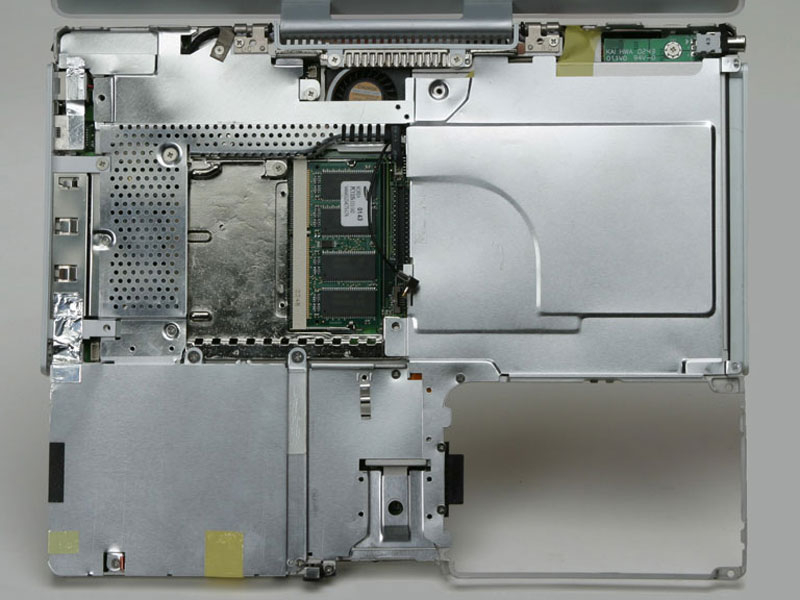

Add Note Edit Step 34 — Top Shield  ¶
  • Your laptop should look approximately like this.
Image #1
Add Note Edit Step 35  ¶
  • Remove the following 14 screws (some models may be missing a couple of screws):
    • One 2.5 mm Phillips.
    • Six 3.5 mm Phillips.
    • One 4.5 mm Phillips near the sleep light with a small shaft.
    • Two 4.5 mm Phillips with larger shafts.
    • Four 5 mm Phillips
    • If a screw is inserted in the left hole, the 14.2 mm screw in step 24 can not be inserted to hold the top case down.
Image #1
Add Note Edit Step 36  ¶
  • Peel back three strips of yellow tape in the bottom left corner.
  • Peel back one strip of foil tape in the upper left corner and another near where the trackpad connects to the logic board.
Image #1
Add Note Edit Step 37  ¶
  • Lift the top shield up from the right side, minding the upper left corner, which may catch on the metal framework.
