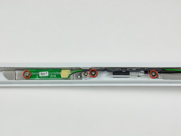

Add Note Edit Step 65  ¶
  • Remove the three Phillips screws securing the reed switch board and the AirPort antenna to the front bezel.
    • If you have a 1.33 GHz 12" G4 iBook, the reed switch board is located near the optical drive. Please skip to the next step.
  • De-route the reed switch/AirPort antenna cables around the side of the display.

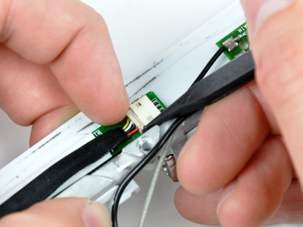

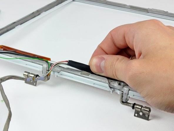

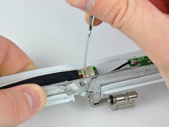

Add Note Edit Step 66  ¶
  • Gently peel the inverter cable ground strap off the cast aluminum frame of the clutch hinges.
  • While pulling the inverter cable away from its socket on the inverter board, use the tip of a spudger to push the connector out of its socket.
  • If the connector won't budge from its socket, insert a metal spudger or similar tool into the gap between the connector and its socket and twist to separate the two pieces.

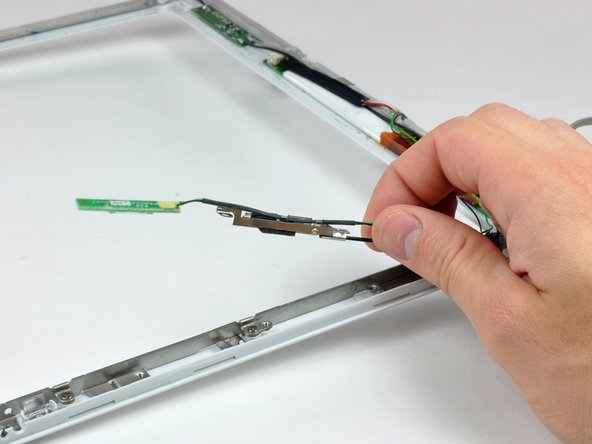

  • Remove the two Phillips screws securing the AirPort antenna to the front bezel.
  • De-route the AirPort antenna cable along the edge of the display.
Image #1 Image #2

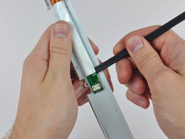

Add Note Edit Step 68  ¶
  • If you have a 1.33 GHz 12" G4 iBook, simply remove the Inverter/AirPort cables.
  • For all other models, use the flat end of a spudger to remove the antenna board from the front bezel.
  • The antenna board is very thin and delicate.
  • Remove the inverter/AirPort cables.

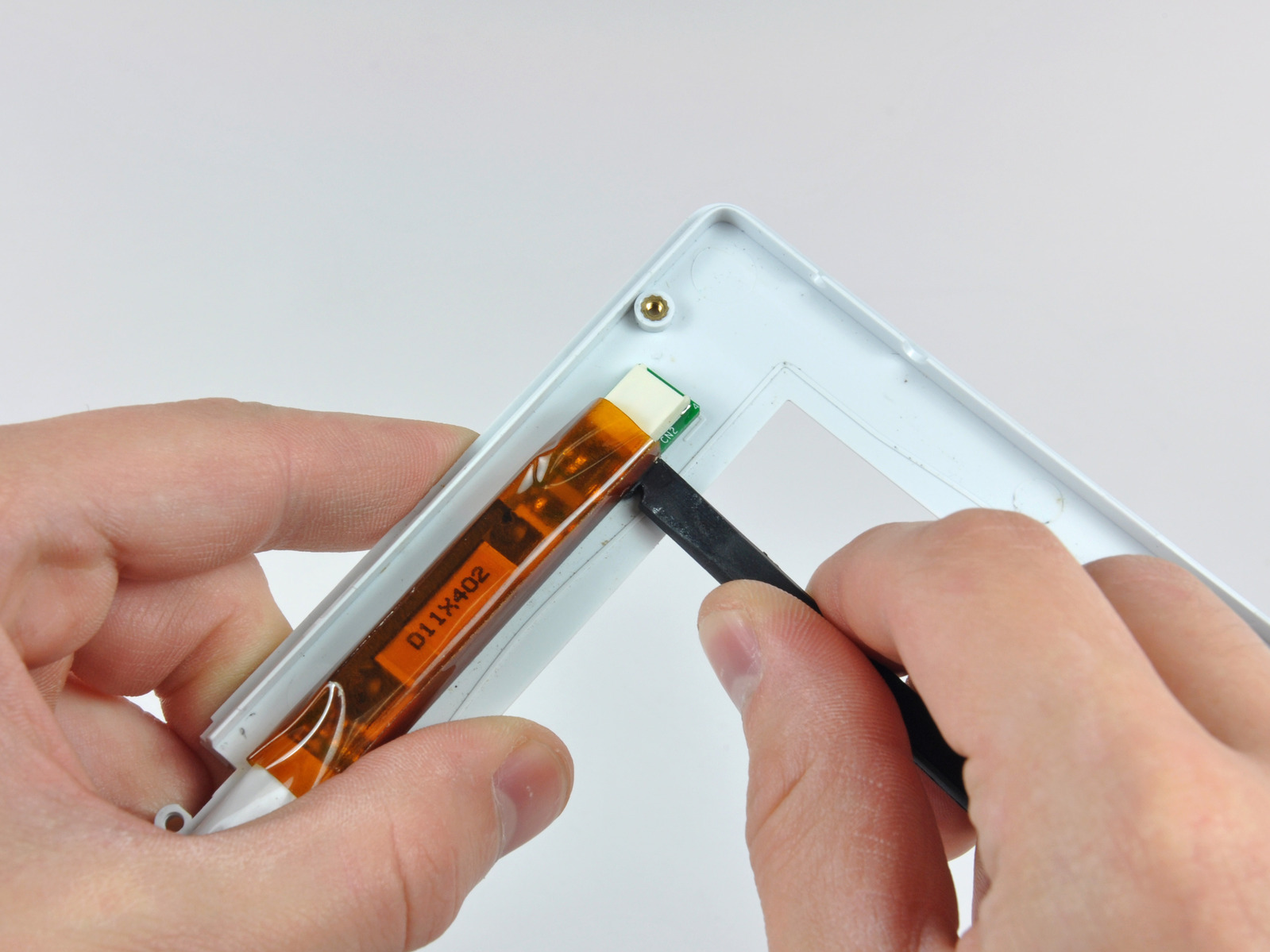

Add Note Edit Step 70 — Front Display Bezel  ¶
  • Insert the flat end of a spudger between the display inverter and the front display bezel near the center of the inverter.
  • Run the spudger along the length of the display inverter, separating it from the adhesive securing it to the front display bezel.
  • Lift the inverter out of the front display bezel.
