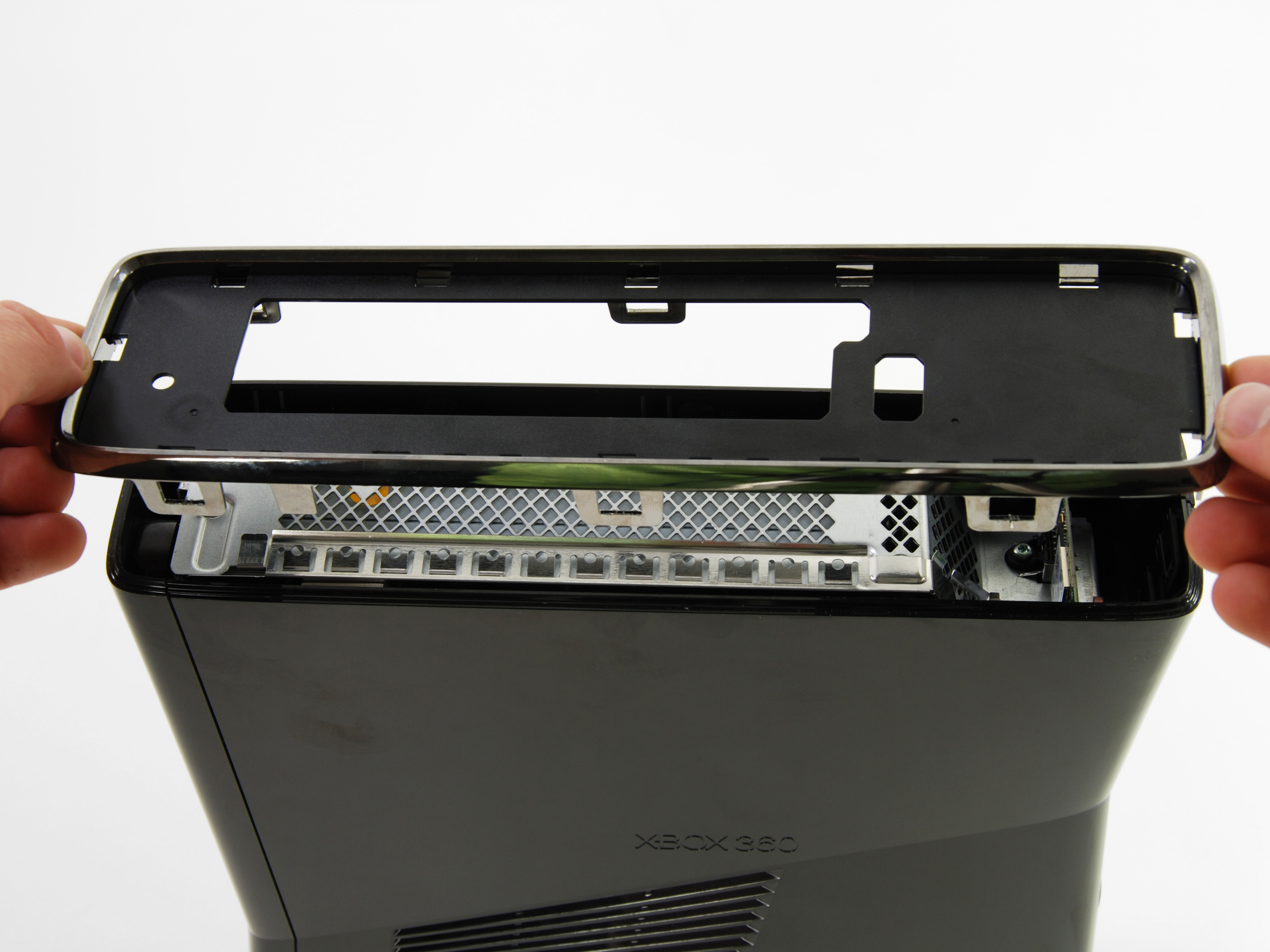

  • Rotate the console so that the rear of the Xbox 360 S is facing to the right, and the right case is facing you.
  • Insert a metal spudger through the rear-most slit on the right edge of the top bezel and between the bottom edge of the clip and the right case.
  • While lifting up on the top bezel with your fingers, rotate the spudger away from the console to free the clip.
Image #1 Image #2
Add Note Edit Step 10  ¶
  • In the same manner as described in the previous steps, release the middle and front clips along the right edge of the top panel.
Image #1
Add Note Edit Step 11  ¶
  • Lift the top panel off the device.
  • You may have to go back with a spudger and undo any clips that have re-attached to the console.
