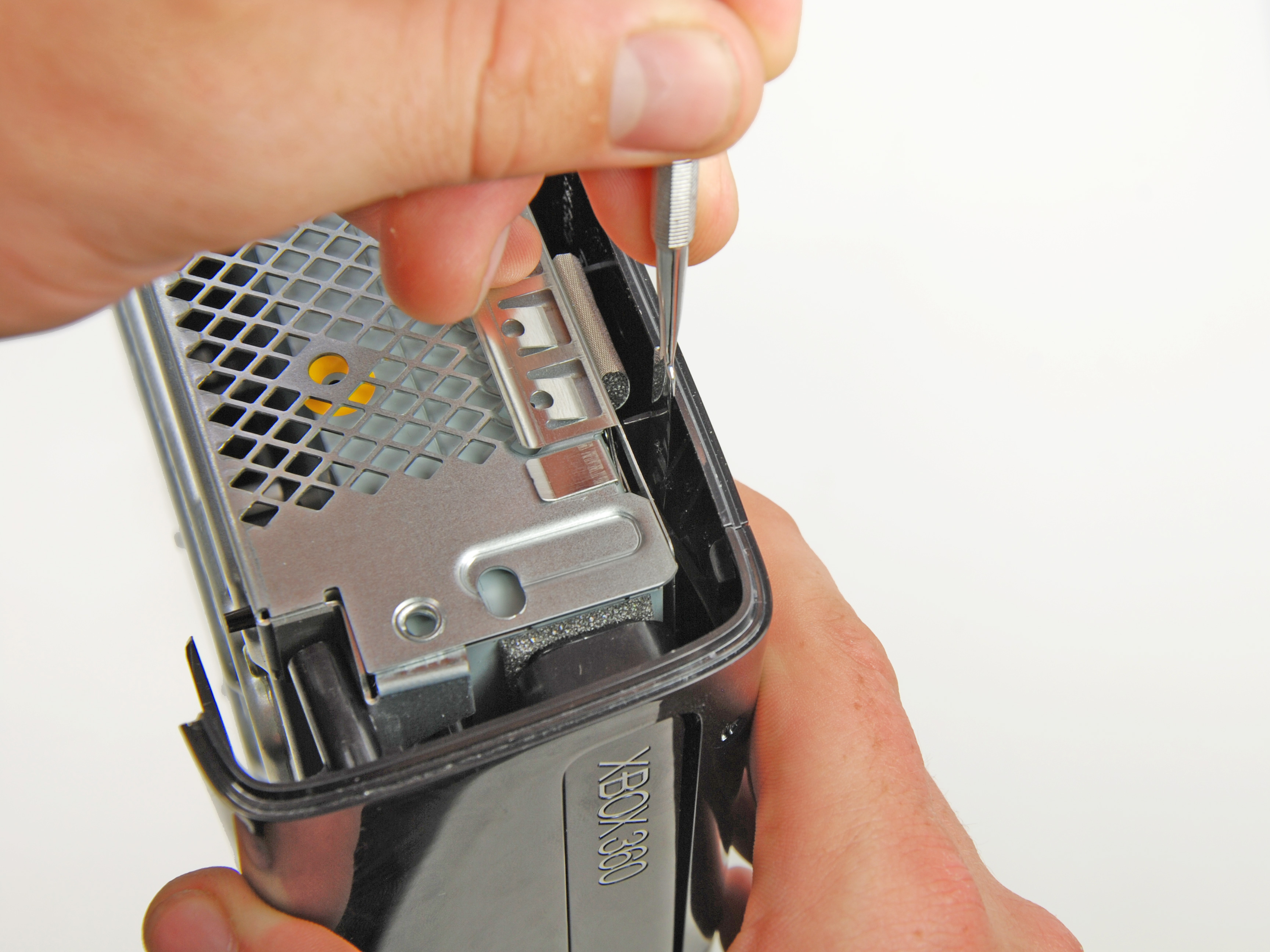

Add Note Edit Step 5  ¶
  • In the following steps, you will be releasing the six clips highlighted in red.
  • Each clip can be undone by inserting a metal spudger underneath the bottom edge of the clip. Once underneath the bottom edge, simply prying away from the console will free the clip.
Image #1 Image #2
Add Note Edit Step 6  ¶
  • Orient the console so that the left case is facing toward you and the faceplate is facing toward the right.
  • Insert a metal spudger through the front-most slit on the left edge of the top bezel and between the bottom edge of the clip and the left case, as described above.
  • Simultaneously rotate the spudger away from the console and pull up on the top bezel to free the clip.
  • You will hear a "pop" signifying that the clip cleared its catch.
Image #1 Image #2
Add Note Edit Step 7  ¶
  • Using the same method described above, free the two remaining clips along the left edge of the top bezel.
Image #1
Add Note Edit Step 8  ¶
  • Grab the entire top panel with your hands, lift up the entire left edge high enough to rest the separated clips on top of the left case.
  • You may have to go back with a spudger and undo any clips that have re-attached.
  • The top panel will not come free of the console yet.
