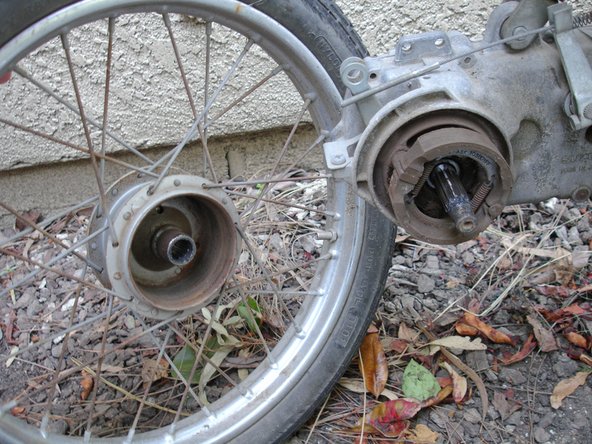

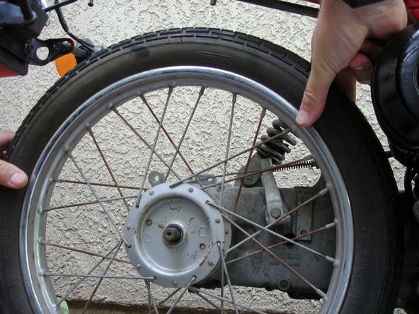

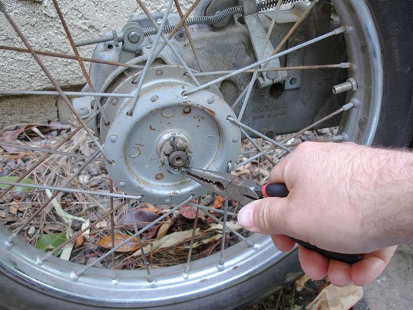

Add Note Edit Step 4 — Rear Brakes  ¶
  • Use a pair of needle-nose pliers to straighten the rear wheel retaining pin.
  • Pull the fat end of the pin out with needle-nose pliers as you hit the other end through with a hammer.
Image #1 Image #2

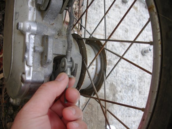

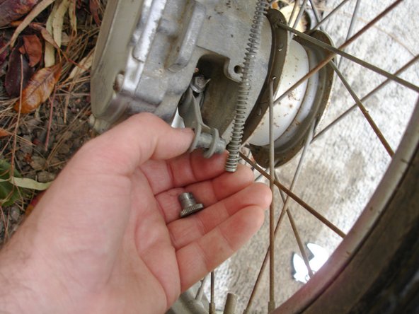

Add Note Edit Step 5  ¶
  • Use your fingers to unscrew and remove the brake cable adjustment nut.
  • Slide the brake cable retaining bracket out of the brake arm.

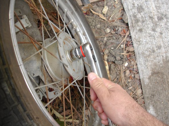

Add Note Edit Step 6  ¶
  • Use a 22 mm ratcheting socket wrench to remove the lug nut.
  • Pull the rear wheel off of the axle.
Image #1 Image #2

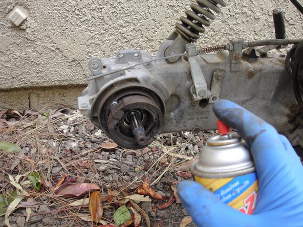

Add Note Edit Step 7  ¶
  • At this point you should suit up, as it's gonna get nasty. Solvents used for cleaning brake hardware are harmful to skin. Always wear gloves when dealing with these chemicals.
Image #1 Image #2

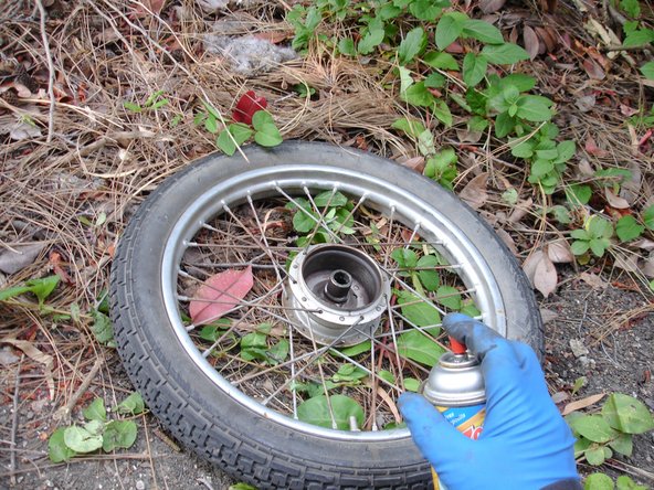

Add Note Edit Step 8  ¶
  • Thoroughly spray the the brake shoe assembly and inside of the brake drum with a brake cleaning solvent.
Image #1
Add Note Edit Step 9  ¶
  • Once the solvent has had a chance to work its magic (10 minutes or so), use a rough-grit sandpaper (100 grit or so) to clean the inner diameter of the drum. Rinse and repeat until you are satisfied with the cleanliness of the drum.

Add Note Edit Step 10  ¶
  • Attach the two brake shoes and springs together. First put both springs through one of the shoes, then loosely attach the other side of the springs to the other shoe.
  • Apply silicone grease to the round and flat bolts on the brake drum assembly.

Add Note Edit Step 11  ¶
  • Be careful with this part, as the brake shoes are under load. It took me a couple of tries (and different methods) to accomplish this properly.
  • Carefully spread apart the round side of the brake shoes and place them through the round bolt on the brake drum assembly.
  • Then, spread apart the flat side of the brake shoes and place them through the flat bolt on the brake drum assembly.
  • The shoes should now be sitting as shown.

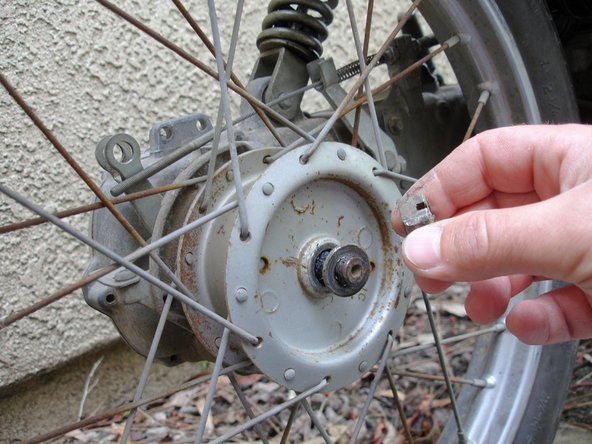

Add Note Edit Step 12  ¶
  • Place the wheel back on the axle. Make sure that the thread of the axle matches up to the thread of the wheel.
