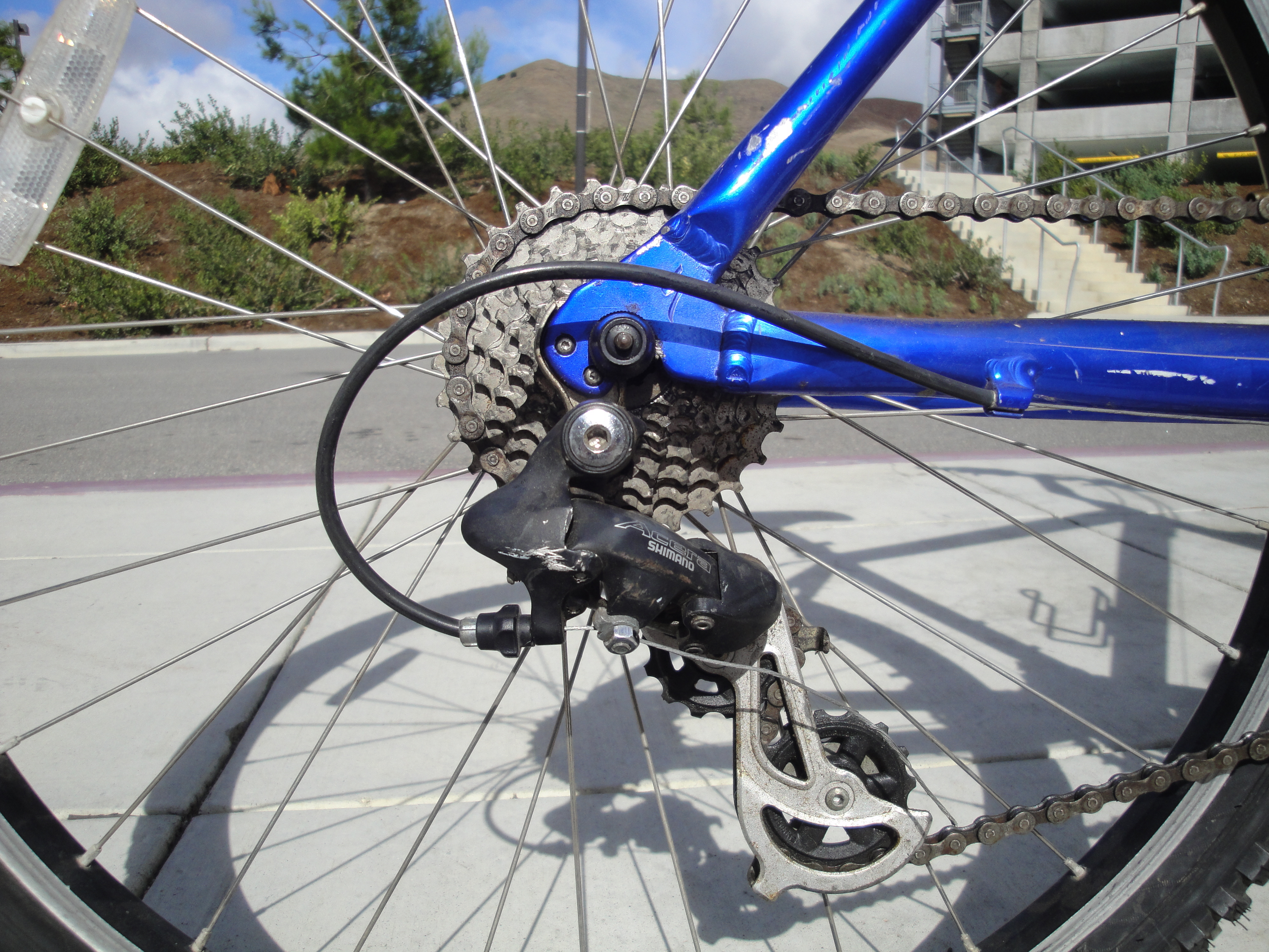

Add Note Edit Step 1 — Rear Derailleur  ¶
  • Bolt the derailleur to the mounting tab with an Allen wrench.
  • Be careful not to over-tighten the steel bolt, as this can strip the aluminum mounting tab.
Image #1 Image #2 Image #3
Add Note Edit Step 2  ¶

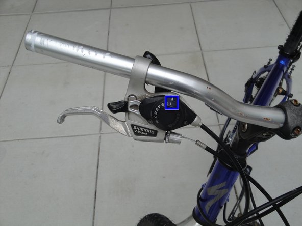

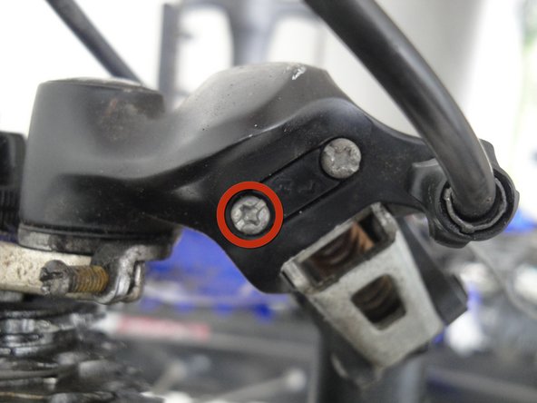

  • Shift the rear derailleur into the highest gear(smallest sprocket).
  • Align the rear guide sprocket of the derailleur with the highest gear (smallest sprocket), by tightening or loosening the screw labeled "H".
Add Note Edit Step 3  ¶

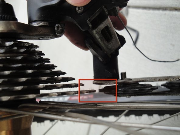

  • Shift the rear derailleur into the lowest gear(largest sprocket).
  • Align the rear guide sprocket of the derailleur with the lowest gear(largest sprocket), by tightening or loosening the screw labeled "L".
Image #1 Image #2
Add Note Edit Step 4  ¶

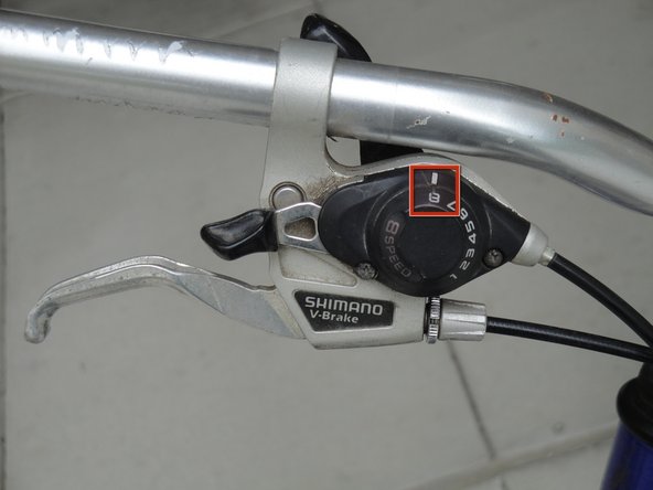

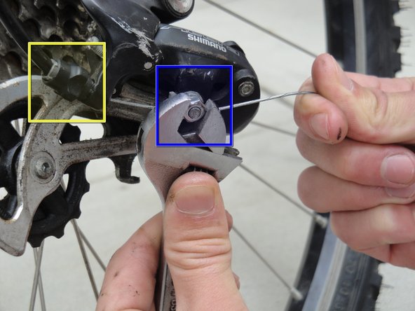

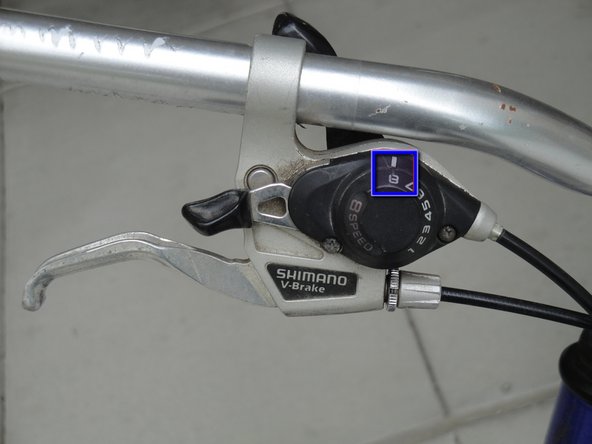

  • Shift the bike into the highest numbered gear.
  • Slide the cable through the barrel adjuster screw until the cable housing bottoms out.
  • Pull the slack out of the cable while clamping it down with the nut that is attached to the derailleur.
Add Note Edit Step 5  ¶

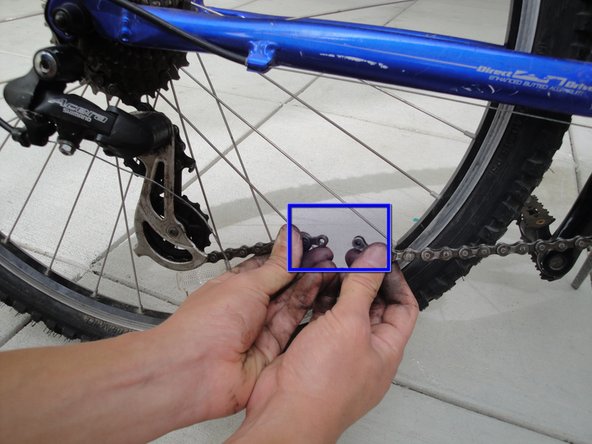

  • Route the chain around the chain rings, cassette, and derailleur.
  • Reconnect both ends of the chain using a master link or a chain cutter tool.
  • See the chain connection guide.
Image #1
Add Note Edit Step 6  ¶
  • Fine tune the derailleur by tightening or loosening the barrel adjuster screw. Loosening this screw causes the derailleur to move slightly towards a larger sprocket, while tightening it moves the derailler towards a smaller sprocket.
  • Shift through each gear while pedaling. The derailleur should move the chain one gear over each time you shift up or down.
  • If the chain skips or makes noise when you are not shifting, use the barrel adjustment screw to fine tune the derailleur alignment.
  • Repeat the previous steps until the derailleur shifts smoothly and makes a minimal amount of noise.
