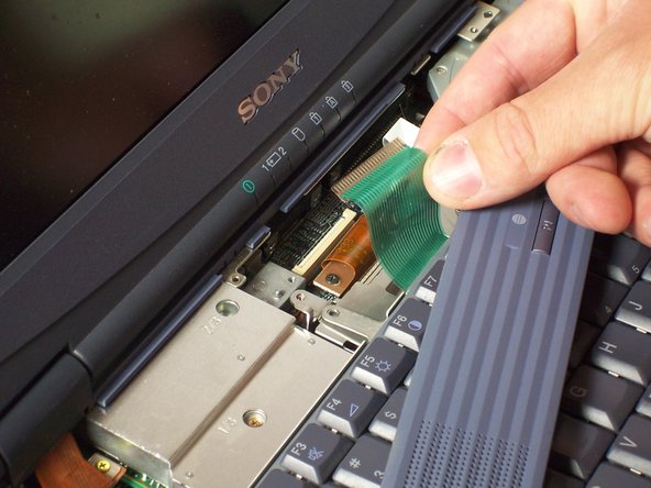

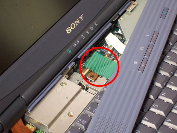

  • Locate a green ribbon cable which attaches the keyboard to the motherboard.
Image #1
Add Note Edit Step 7  ¶
  • To unplug the ribbon cable, use your fingers and a pair of tweezers to lift up the white bar near the connection to the motherboard. It only needs to be lifted up slightly to unlock the ribbon cable.
Image #1
Add Note Edit Step 8  ¶

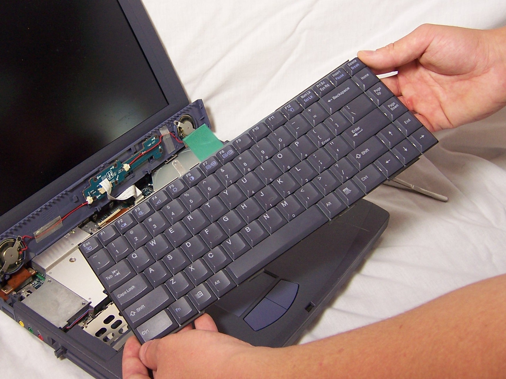

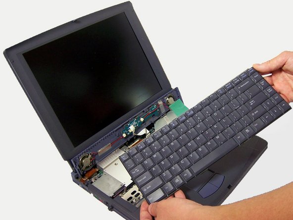

  • Now, you can pull on the ribbon cable and it will detach from the motherboard.
Image #1
Add Note Edit Step 9  ¶
  • Your keyboard is now free. You can either clean it, make repairs, or install a new keyboard.
