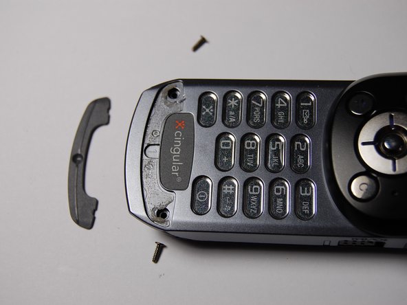

  • Flip the phone over and slide it open.
  • Using the prying tool, remove the plastic piece covering the microphone.
  • Locate and remove the two 6mm screws located under the plastic piece and remove them using a small Phillips screwdriver.

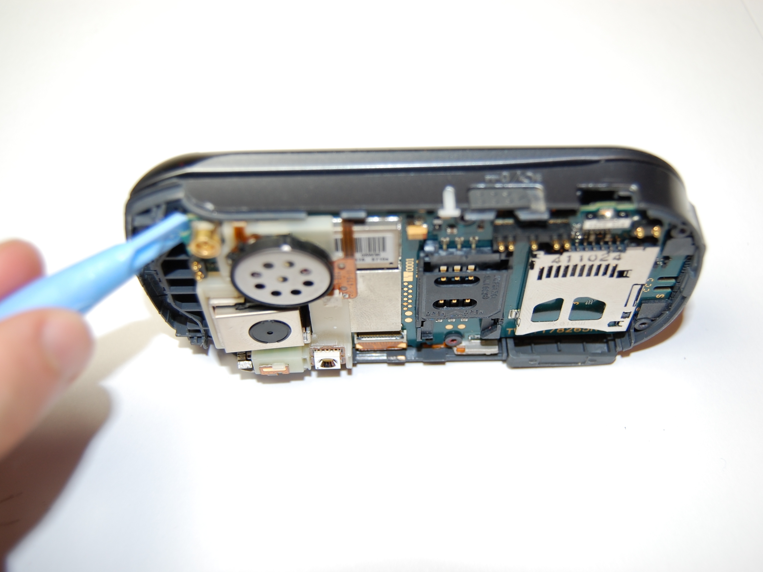

  • Use the plastic opening tool to remove the black plastic cover from the rest of the phone.
  • It is best to start from the bottom of the phone by the memory card slot.
  • The cover should pop out of place by the four corners of the phone. There is no need to use excessive force as this may cause the plastic to break.

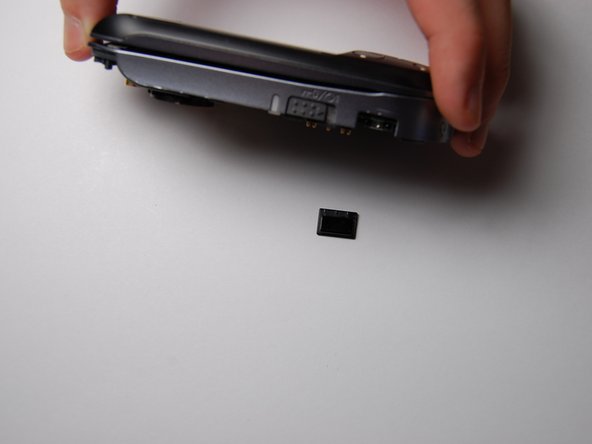

  • Once the back cover is removed, remove the small black piece shown in the picture.

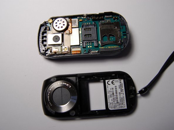

  • Using the plastic opening tool, slide around the motherboard to loosen it.
  • Lift the motherboard up but not completely because in order to remove the motherboard you need to lift and pull it out.

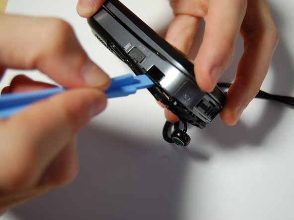

  • Using the plastic opening tool, separate the connectors to the screen.
  • Make sure to note the orientation and location of each cable before disconnecting. This will ensure that the motherboard will be reconnected properly.
  • Once the old motherboard is removed insert the new one if desired, and then reassemble the phone.
