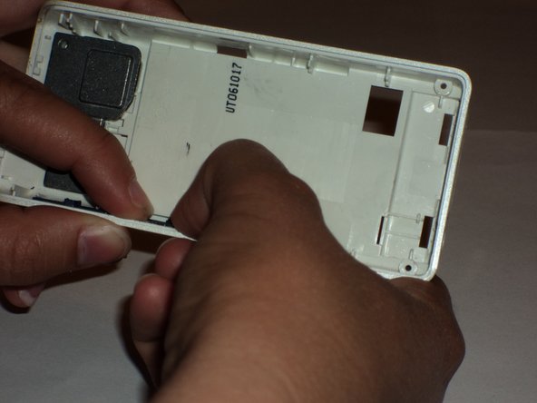

Add Note Edit Step 9  ¶
  • Push on the volume button with both of your thumbs. Wiggle the volume button back and forth as you push upwards.
  • The volume button will pop out.

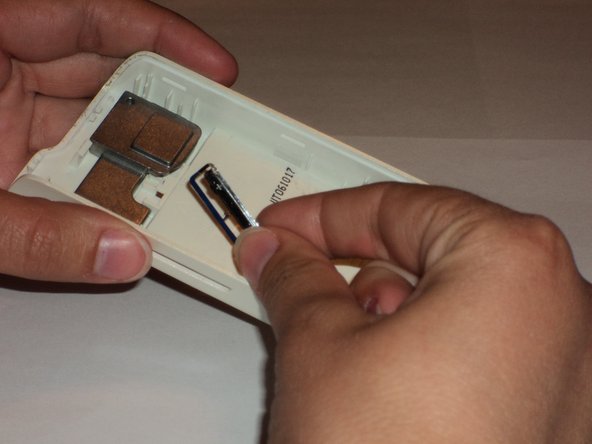

Add Note Edit Step 10  ¶
  • Remove the volume button from the device.

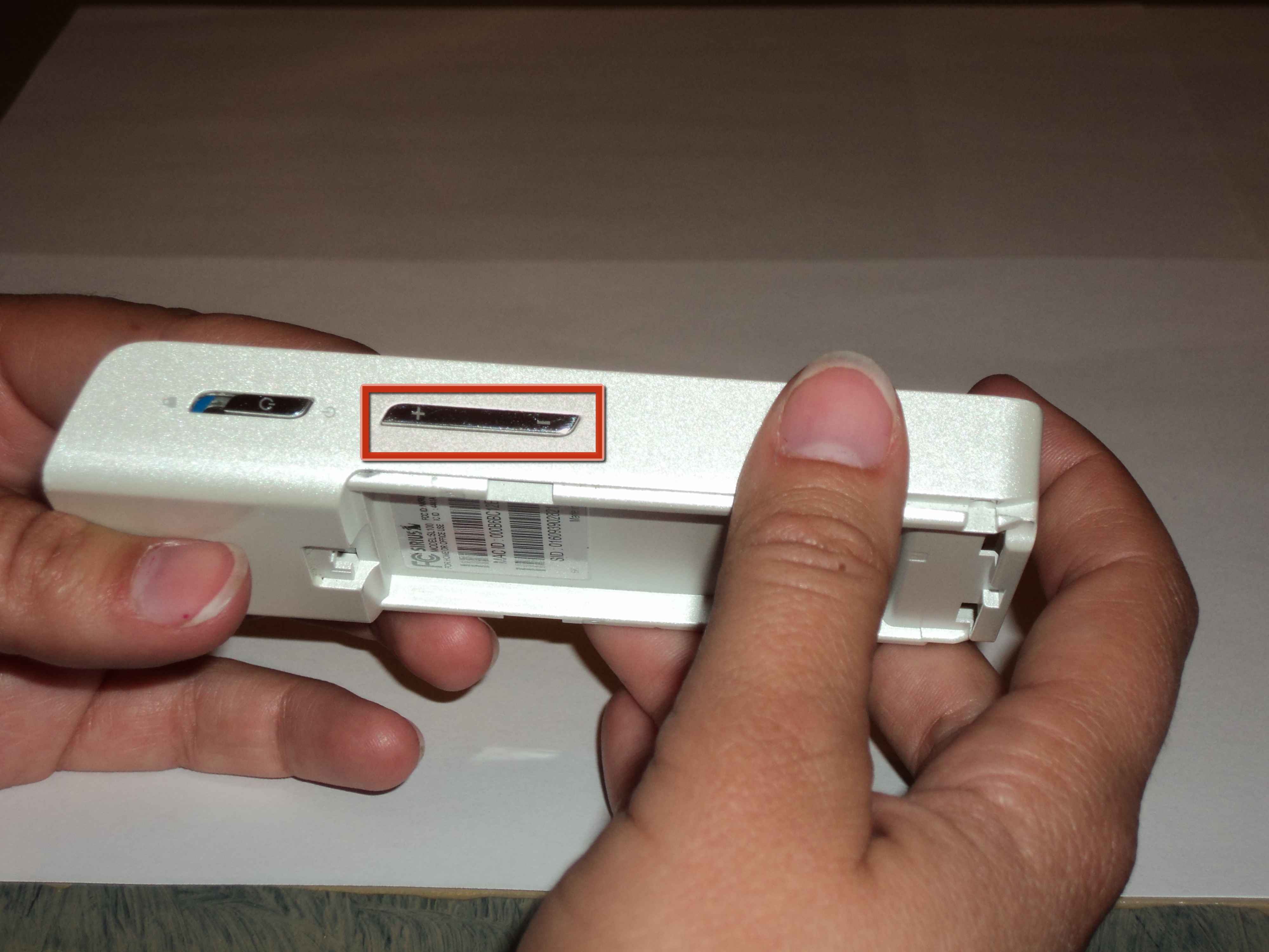

Add Note Edit Step 11  ¶
  • Slide the new volume button into the slot for the volume button.
  • Make sure that the volume button is oriented correctly. An easy way to check this is to hold the volume button in place and look at the side of the device.
