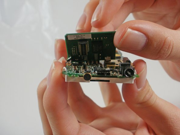

Add Note Edit Step 7  ¶
  • Pull the front cover away from the rest of the device.
Image #1 Image #2

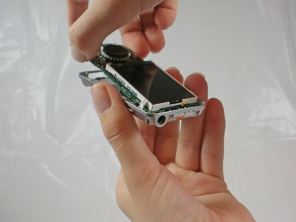

Add Note Edit Step 8 — Memory Board  ¶
  • Near the charging port, pull the case away from the motherboard to create clearance to remove the motherboard.
  • Use the spudger to push the motherboard in and pop the metal edge of the charging port up and inside the plastic case.
Image #1
Add Note Edit Step 9  ¶
  • Pull the bottom of the motherboard up and then out.
Image #1
Add Note Edit Step 10  ¶
  • On the back of the motherboard, there is a rectangle of rubber.
  • Peel the rectangle off slowly.
Image #1
Add Note Edit Step 11  ¶
  • Under the rubber rectangle, there is a strip of black tape.
  • Peel the tape off about halfway so that it is no longer attached to the memory board.
Image #1
Add Note Edit Step 12  ¶
  • Carefully peel the memory board away from the rest of the motherboard
