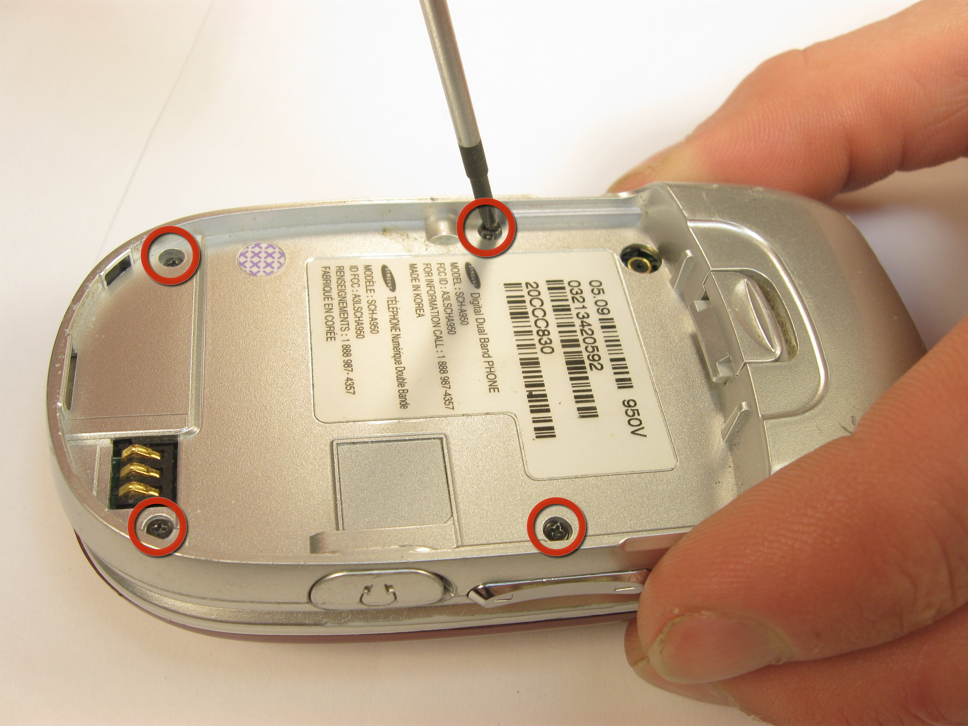

Add Note Edit Step 3 — Volume and Camera Buttons  ¶
  • Unscrew the four phillips screws underneath the battery using a phillips #00 screwdriver.
Image #1 Image #2
