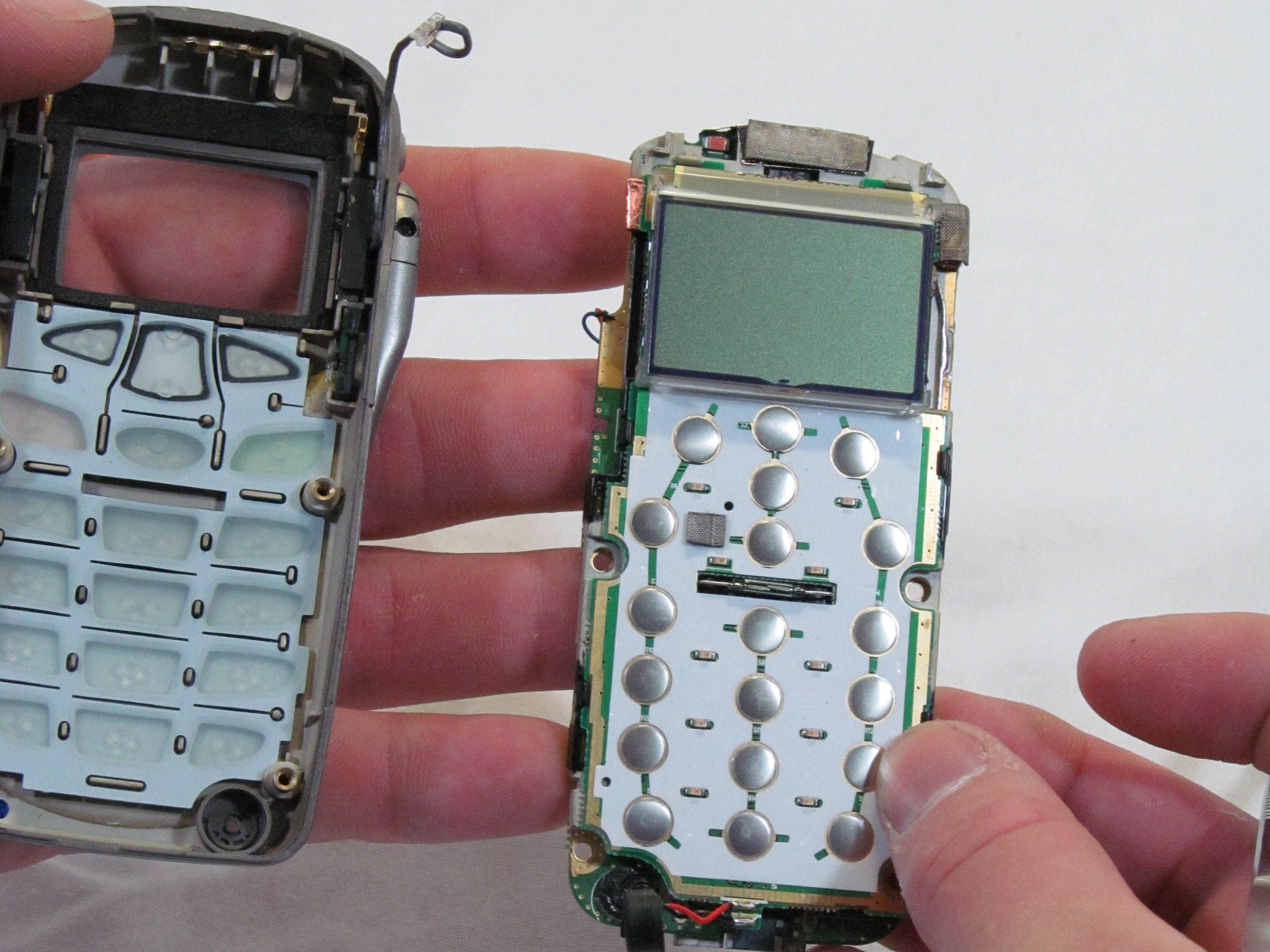

Image #1
Add Note Edit Step 12  ¶
  • Turn the front cover over, gently prying the logic board away from the front cover. It will remain attached by two wires from the front of the board.
Image #1 Image #2
Add Note Edit Step 13  ¶
  • Work the microphone out of its socket on the front cover; it will remain attached to the logic board, its wires are soldered.
  • The logic board is now removed from the phone. Congratulations.
