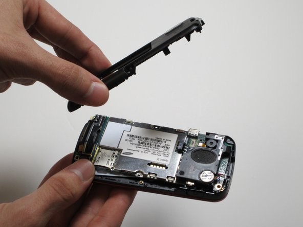

Add Note Edit Step 1 — Motherboard  ¶

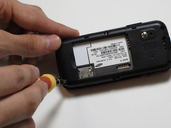

  • Remove the backplate and battery to the phone.
Image #1 Image #2

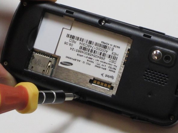

Add Note Edit Step 2  ¶
  • Begin to unscrew the six screws.
Image #1 Image #2

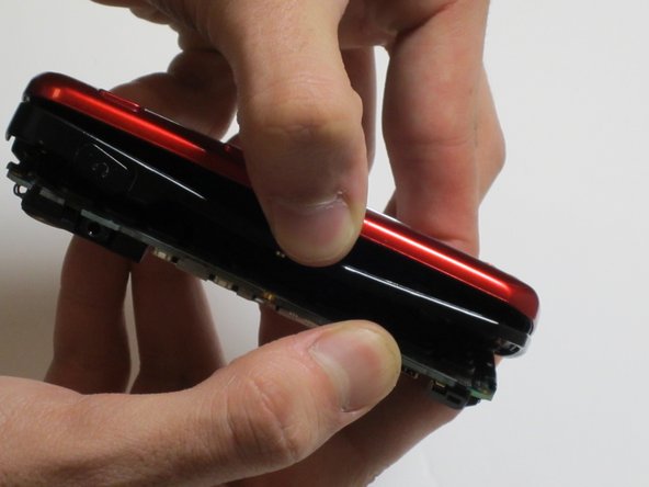

Add Note Edit Step 3  ¶
  • Remove casing from back of device.
Image #1 Image #2

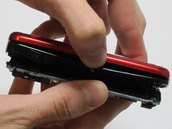

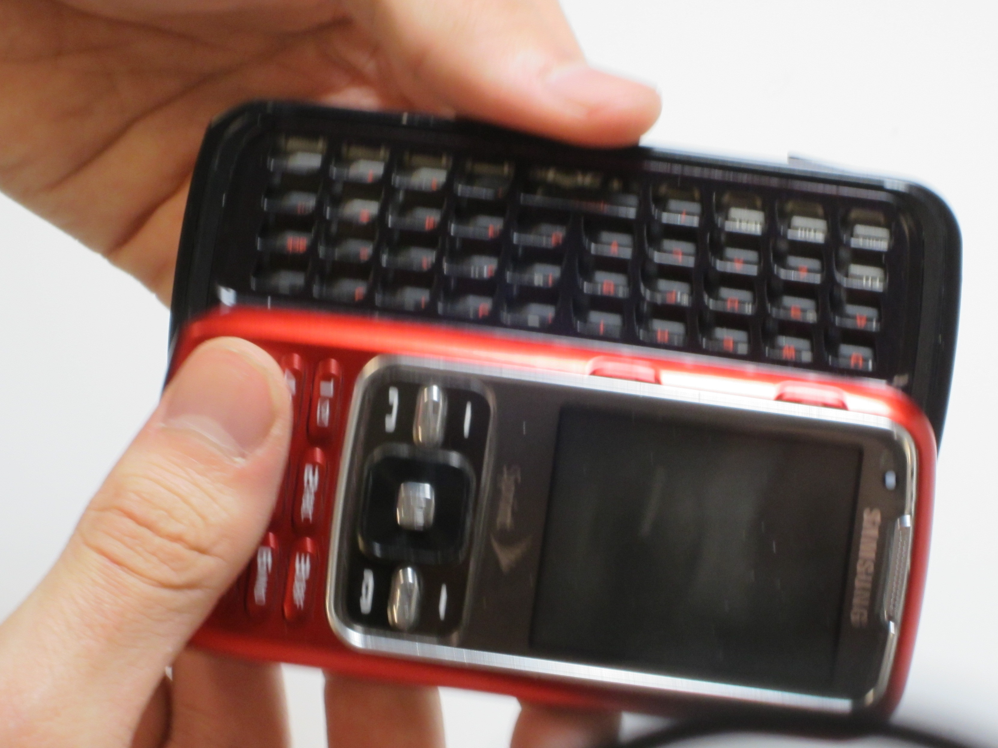

Add Note Edit Step 4  ¶

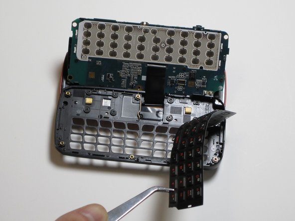

  • Separate the back component of the phone from the keyboard and screen.
  • Expose the middle of the phone and keyboard pad.
Image #1 Image #2 Image #3

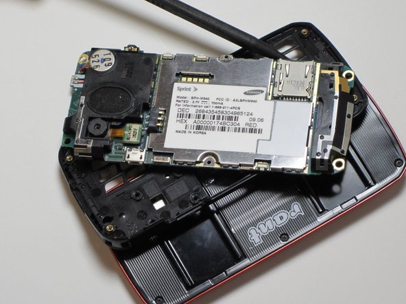

Add Note Edit Step 5  ¶

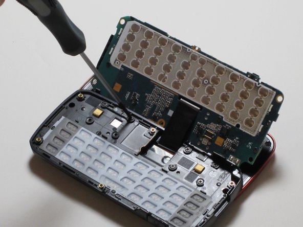

  • Unscrew remaining screws
  • Remove keyboard padding
  • Expose motherboard
