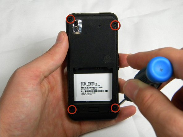

  • Remove the four 4.45mm screws at the corners of the phone.
Image #1 Image #2

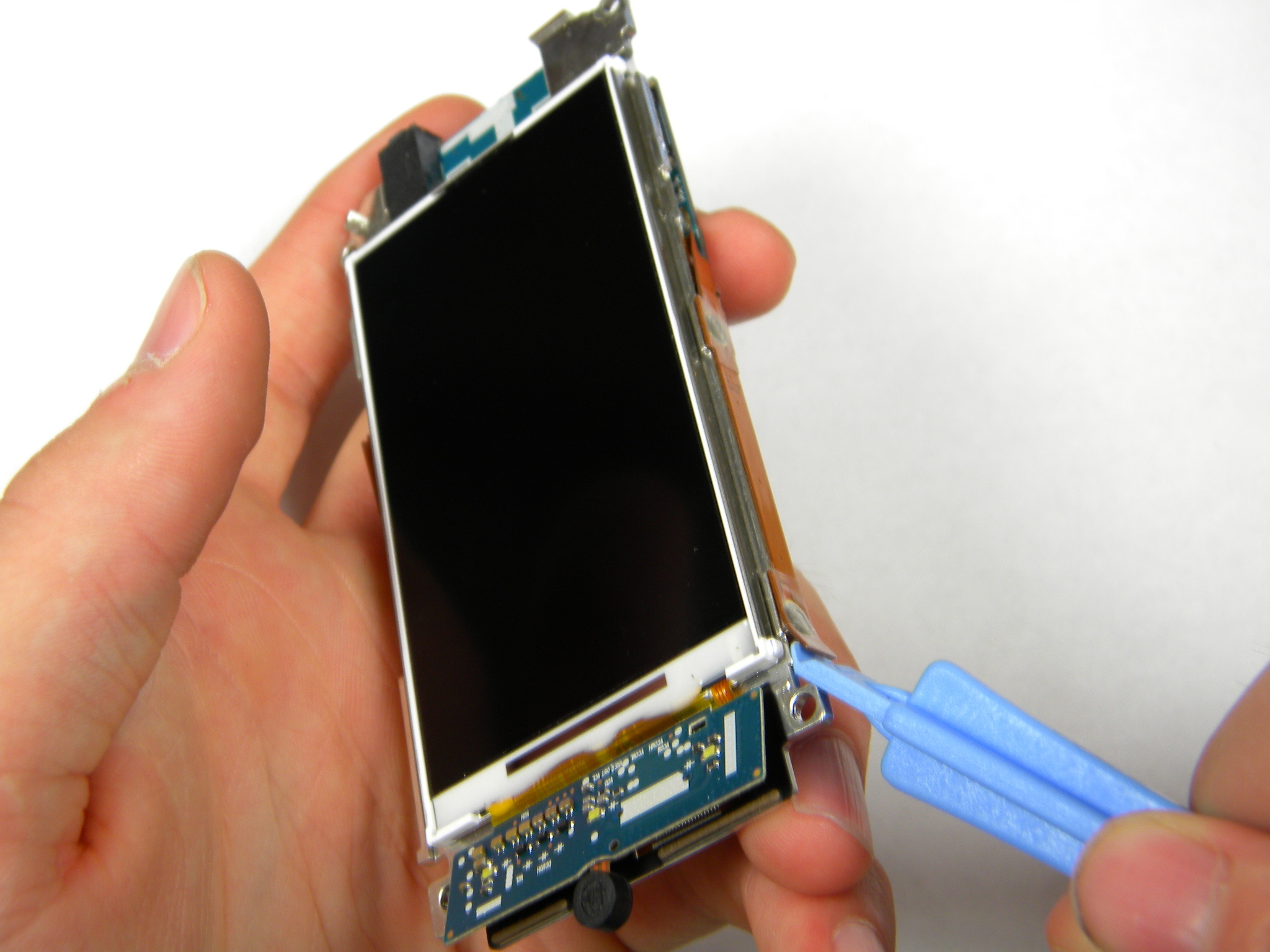

  • Use the plastic opener tool to unhinge the locks around the edges of the phone.
  • Do not worry about the inner components of the phone, they are not connected to this case.
Image #1
Add Note Edit Step 5  ¶
  • Lift the casing off of the phone.

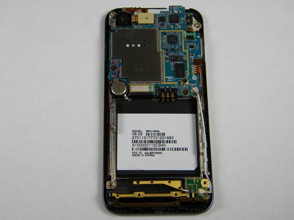

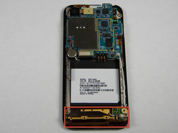

Add Note Edit Step 6 — Antenna  ¶
  • With the screws removed, locate the antenna.
Image #1
Add Note Edit Step 7  ¶
  • Using a phillips-head screwdriver, remove the 4.50mm screw holding the antenna in place.
Image #1
Add Note Edit Step 8  ¶

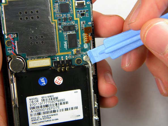

  • Using the plastic opener tool, squeeze gently on the antenna cable connector and lift to remove the connector from its position.
