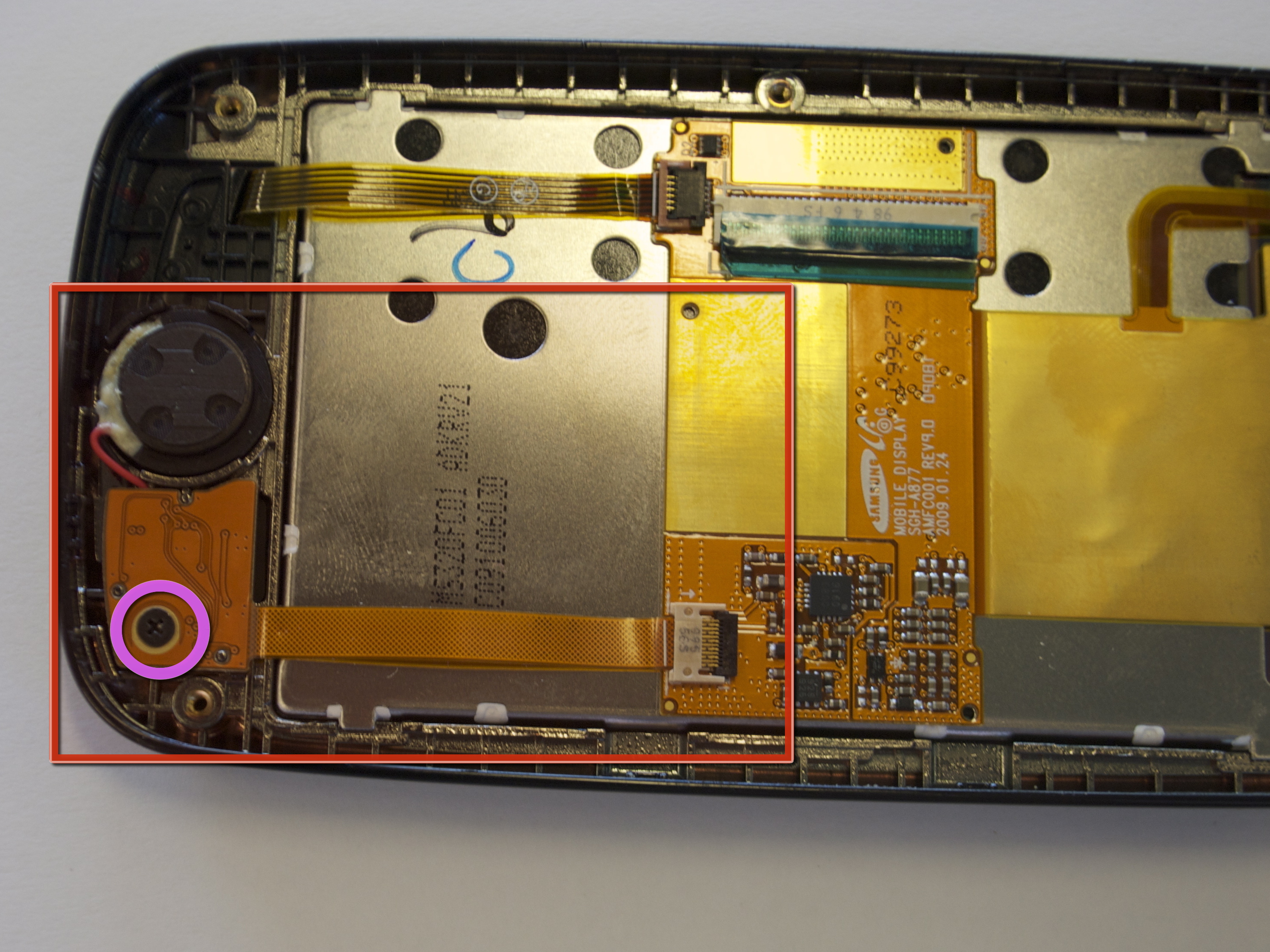

Add Note Edit Step 14 — Ear Speaker  ¶
  • Remove the single screw.
    • This screw is 2.25 mm in length.
  • Lift the black tab at the end of the ribbon.
  • Gently pull the speaker and ribbon free.
