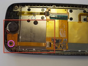

How to remove & replace the phone's ear speaker.

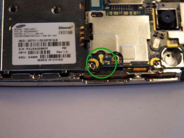

  • To free the circuit board, remove the black wire that is holding it down.
    • You can remove the wire by gently prying up the gold terminator that is attached to the green circuit board. A gentle tug is all it will take.

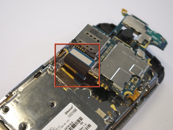

  • The circuit board will still be held on by a blue and black ribbon that is removed by gently pulling it upwards.

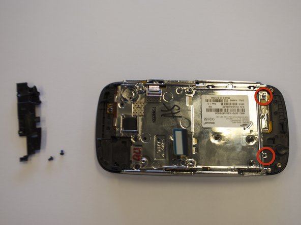

  • Remove the two base screws along the edge of the silver piece, where you just removed the black end piece.
    • The screws are 2.7mm in length.
  • The bottom black end cap will snap out.

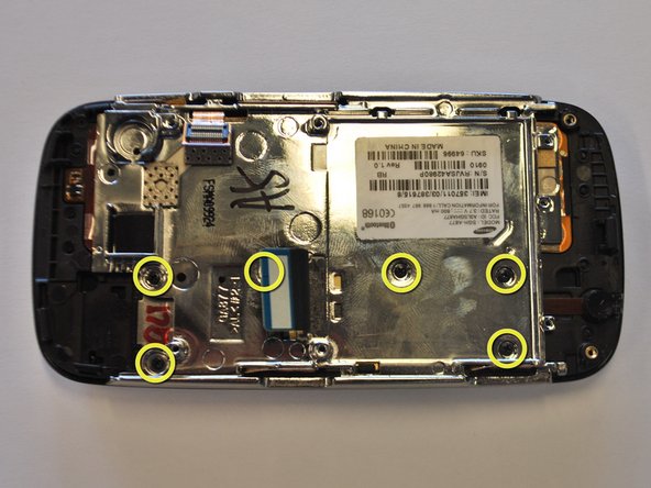

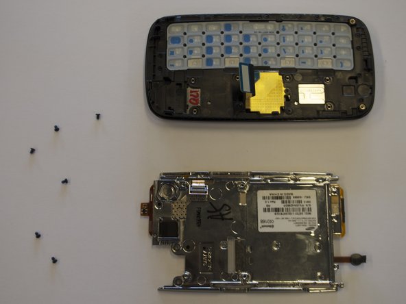

  • Remove 6 screws holding the silver plate on.
    • 2.7mm in length
  • The keys will peel right out of the screen side of the phone.
