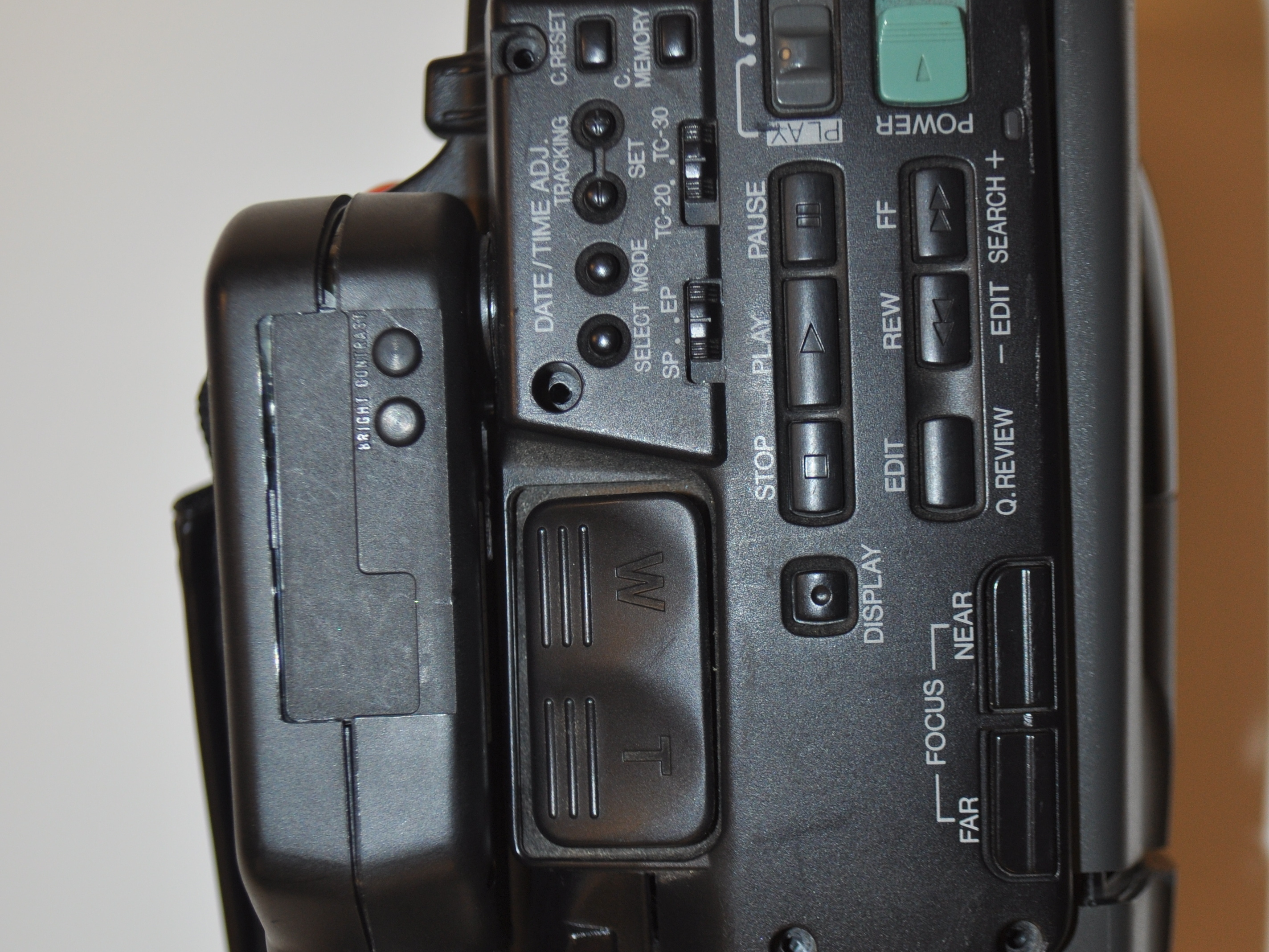

  • Examine device, locating all screws.
  • Approach device from the top, looking at the top control panel, containing Play, Pause, and Stop functions.
  • Remove the 5 small black screws along the edges of the aforementioned control panel.

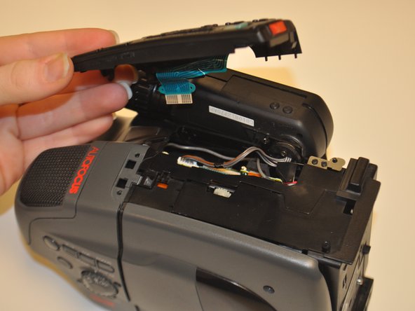

  • Wedge a small flathead screwdriver around the edges of the panel, loosening all edges until the panel pops away from the device.
  • Locate the blue circuit strip along the underside of the top control panel and disconnect it from the inner components of the device.
  • Remove the top control panel from the device.
