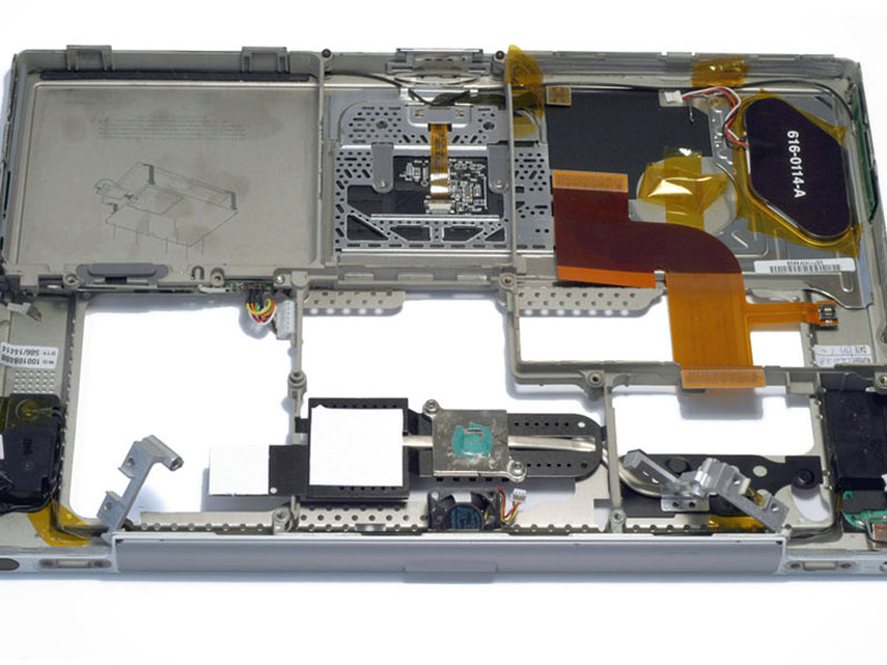

Add Note Edit Step 40 — Upper Case  ¶
  • Upper case remains.
