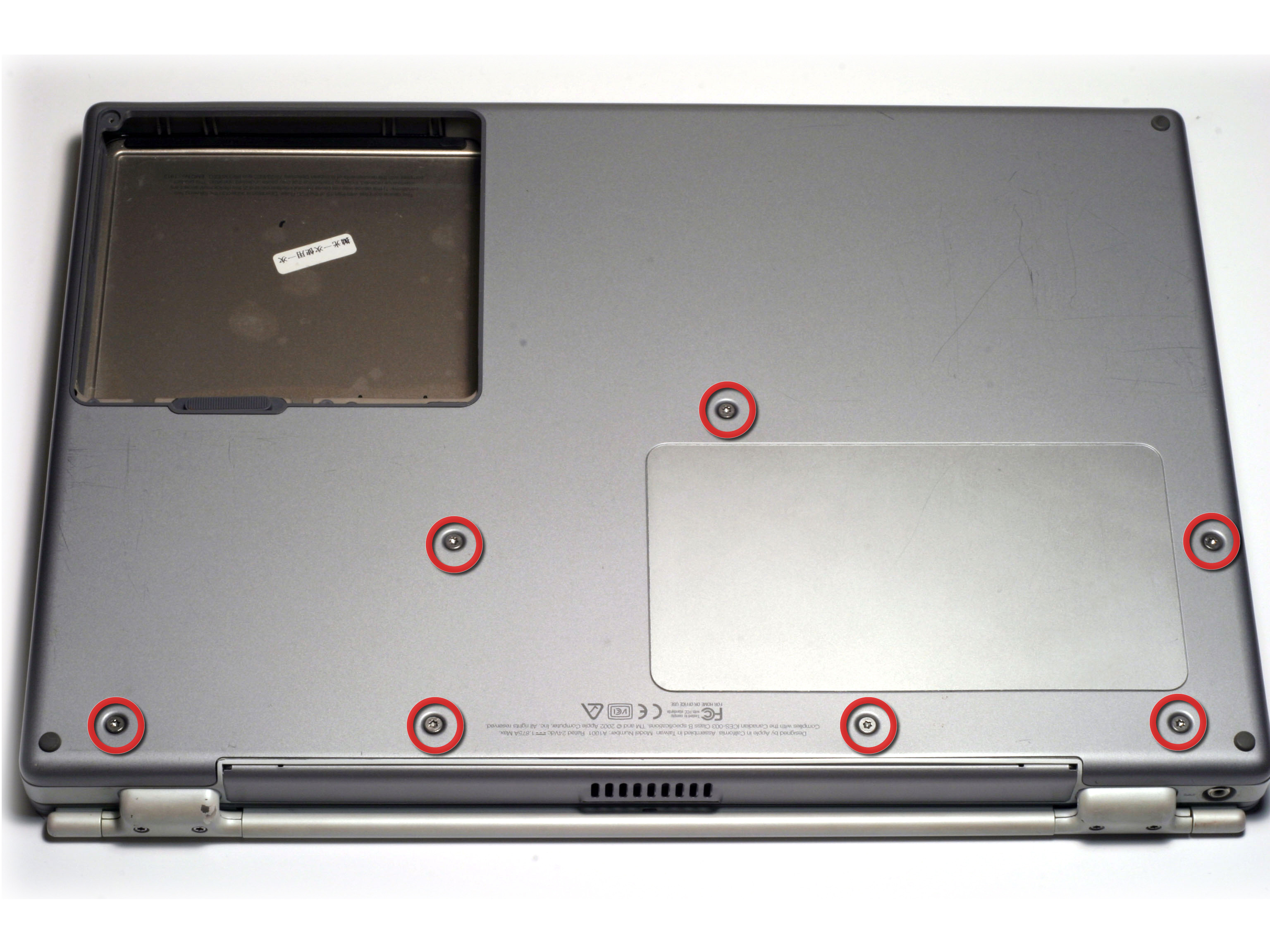

The bottom case slides off easily after removing a few T8 Torx screws.
Image #1 Image #2
  • Locate the battery release tab on the underside of the G4.
  • Slide the battery release tab to the left and lift the battery out of the computer.
Image #1
Add Note Edit Step 2 — Lower Case  ¶
  • Remove the seven T8 Torx screws from the lower case.
Image #1
Add Note Edit Step 3  ¶
  • Using your thumbs, slide the lower case away from you.
  • The lower case may stick in the front on a tab just above the center of the optical drive. Be careful as you work the case off, or you may break the thin strip of plastic just above the drive.
  • Lift the lower case off.
Image #1
Add Note Edit Step 4  ¶
  • Your laptop should look approximately like this.
