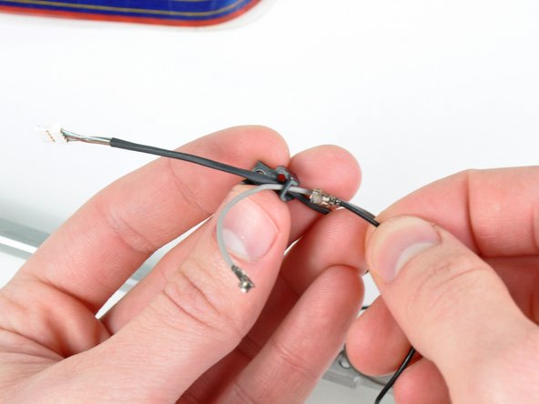

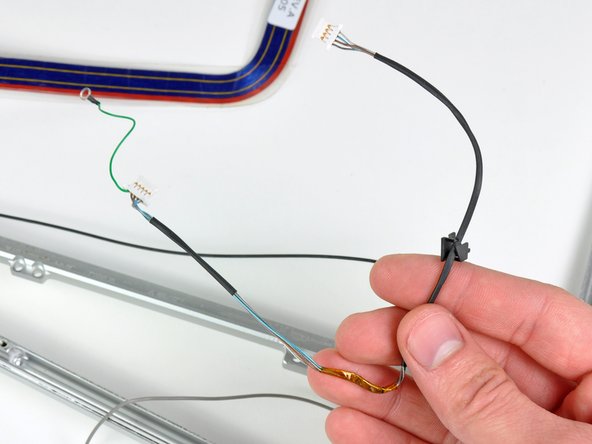

  • De-route both the black and the gray antenna cables through the black plastic cable retainer attached to the inverter cable.
Image #1

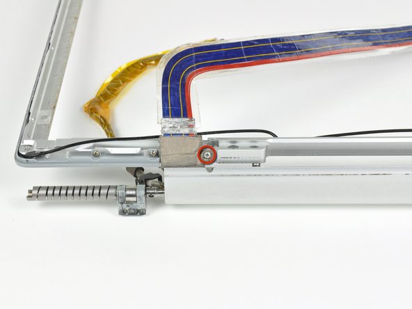

Add Note Edit Step 66  ¶
  • Remove the 2.7 mm Phillips screw securing the display data cable ground loop to the front display bezel.
Image #1

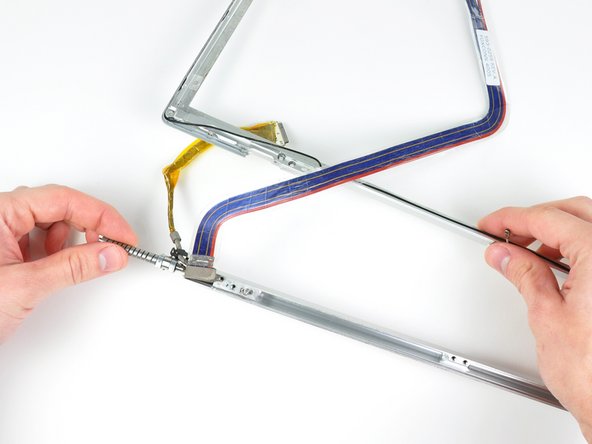

Add Note Edit Step 67  ¶
  • Remove the clutch hinges (with the display data cable still attached) from the front display bezel.
Image #1

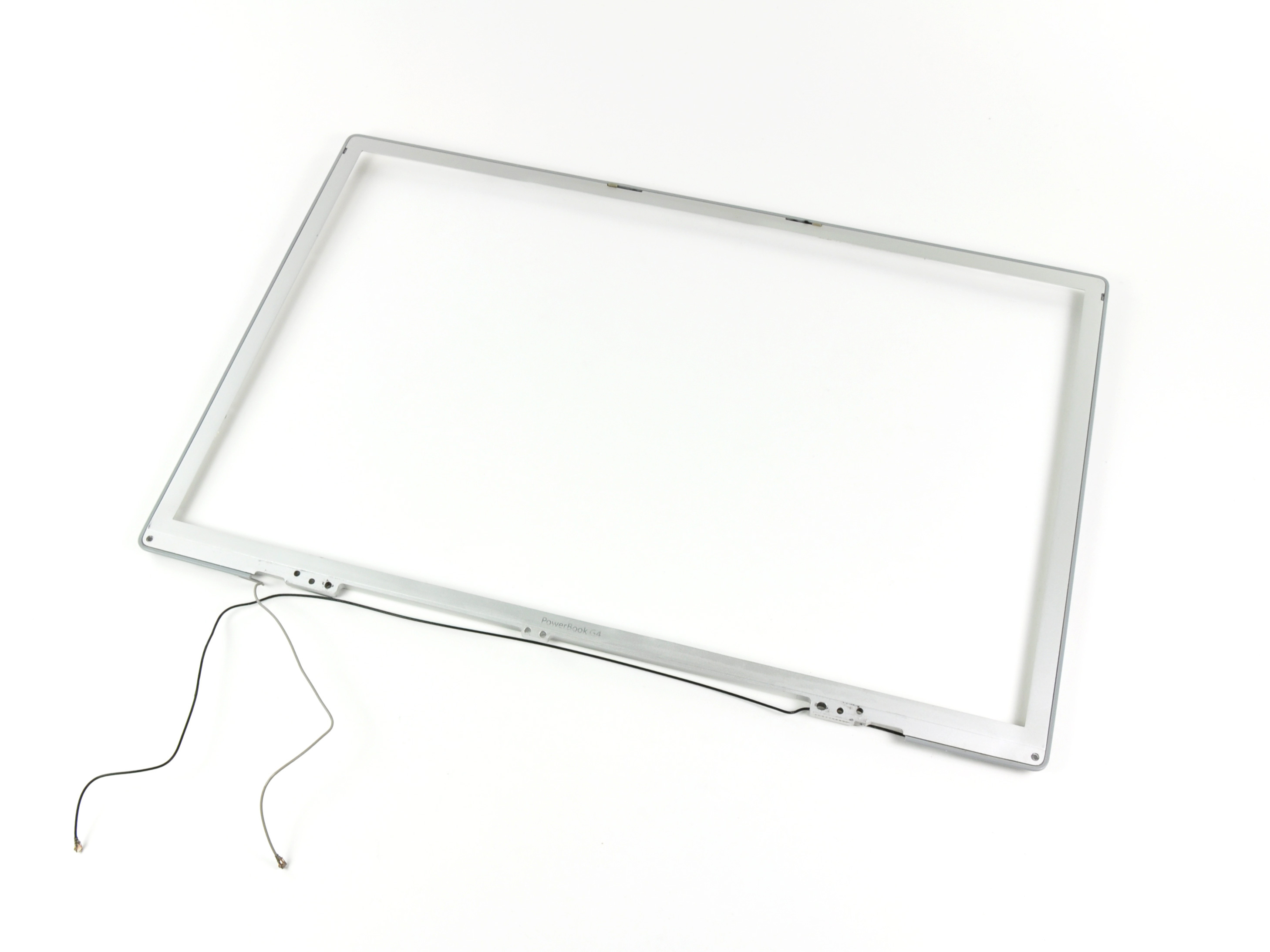

Add Note Edit Step 68  ¶
  • Front display bezel remains.
