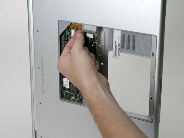

  • Lift the memory door up enough so that you can get a grip on it, and slide it toward you, pulling it away from the casing.
Image #1
Add Note Edit Step 4  ¶
  • Release the tabs on each side of the RAM chip at the same time. These tabs lock the chip in place and releasing them will cause the chip to "pop" up.
  • Pull the chip directly out from its connectors. If there is a second RAM chip installed, pop it out in the same manner.

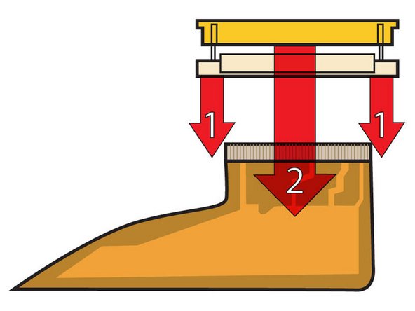

  • This is a diagram of the trackpad ribbon clamp connector you will disconnect in the next step.
  • 1) With your fingernails, grasp the locking bar on either side slide it a small amount (about 1/16" or 2 mm) towards the battery.
  • 2) After disengaging the locking bar, slide the cable out of the connector.

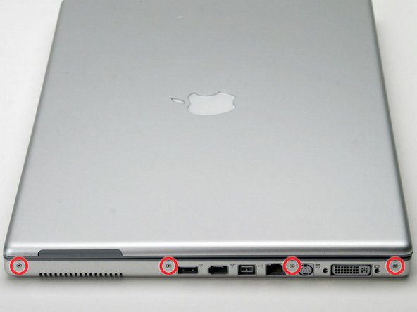

  • Turn the computer over and rotate it so that the DVI port faces you.
  • Remove the four identical Phillips screws spread along this edge of the case.

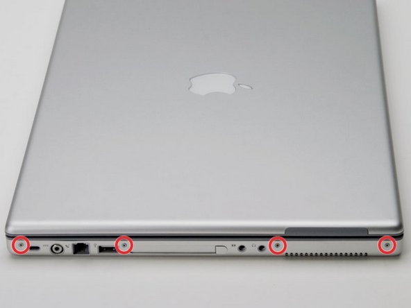

  • Turn the computer 180 degrees so that the power receptacle faces you, and remove the four Phillips screws (identical to those in the last step).

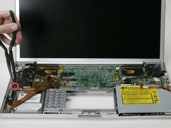

  • Remove the three 4 mm hex nuts using a nut driver or needle-nosed pliers.

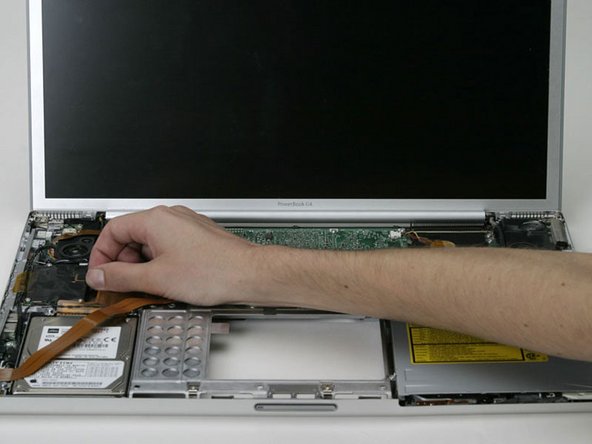

Add Note Edit Step 15 — PC Card Cage  ¶
  • Place the computer on edge (with the display open).
  • Remove the black bumper and disconnect the Airport Extreme cable beneath it.
Image #1
Add Note Edit Step 16  ¶

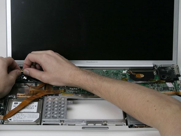

  • Back inside the computer, disconnect the Airport antenna cable at the gold connector, making sure you pull only on the gold metal portion of the connector.
Image #1
Add Note Edit Step 17  ¶
  • If you have not already done so, disconnect the hard drive ribbon and PC card cage ribbon from the left side of the logic board.
Image #1
Add Note Edit Step 18  ¶
  • Remove the four Phillips screws from the corners of the PC card cage.
  • The longer screws go on the right side of the PC card cage.
Image #1
Add Note Edit Step 19  ¶
  • In the following step, the connector you disconnected from the underside of the logic board may catch as you're pulling the card cage out. Of course, the same issue may arise when putting a card cage back into the computer.
  • Hold the PC card cage on the left side and pull it out of the computer.
