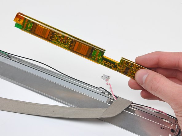

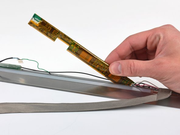

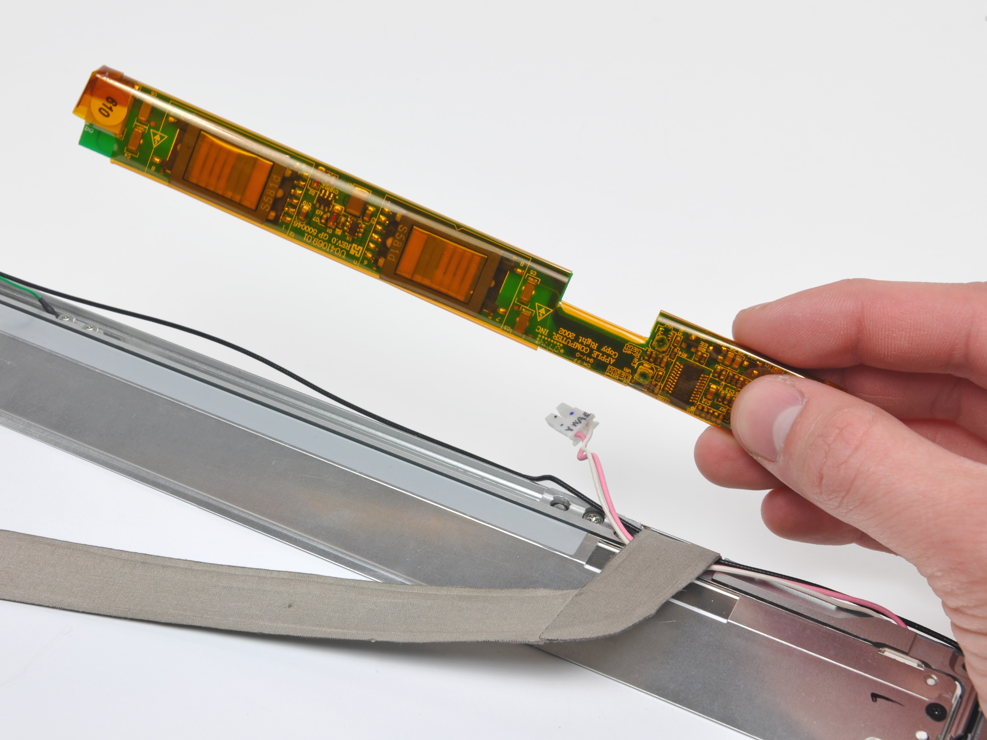

  • Carefully lift the display inverter out of the clutch cover.
  • Don't try to remove the inverter just yet. It is still attached via the backlight cables.
Image #1 Image #2

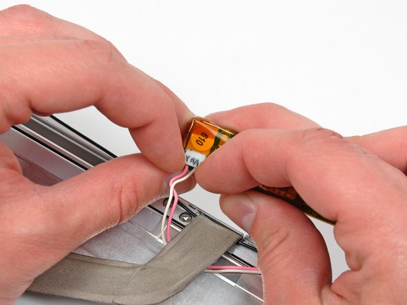

  • Use your fingers to pull the backlight connector away from its socket on the inverter board.
  • Remove the display inverter from the display assembly.
