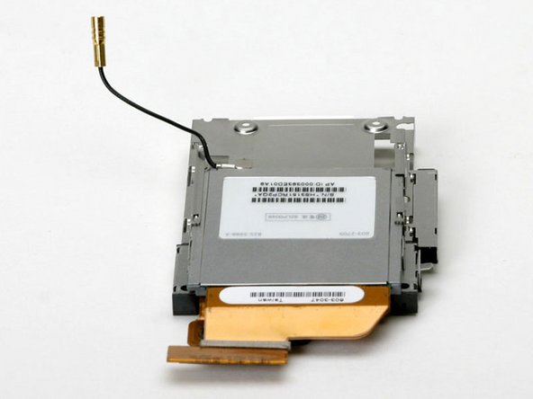

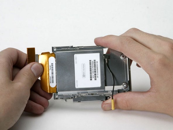

Add Note Edit Step 20 — Airport Extreme  ¶
  • Your laptop should look approximately like this.
Image #1
Add Note Edit Step 21  ¶
  • Slide the Airport card from the back of the PC card cage.
