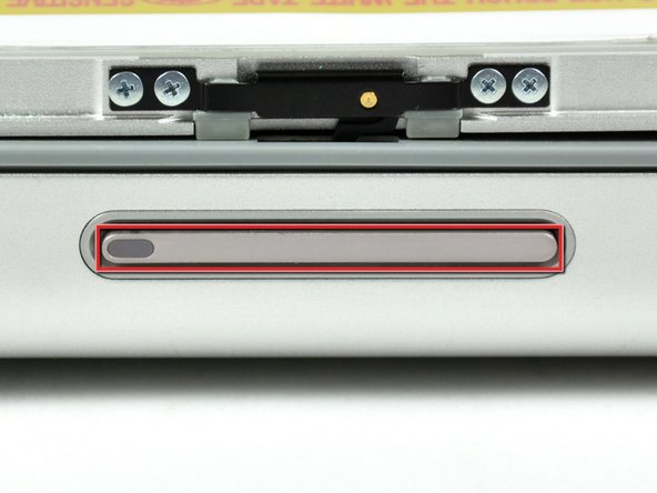

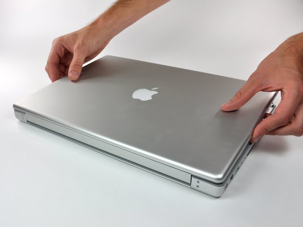

  • Use a coin to turn the battery locking screw 90 degrees clockwise.

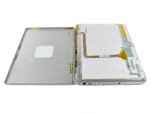

  • The following procedure allows the changing of the rear display bezel without removing the display assembly from the computer. Do not attempt to rotate the display back farther than the hinges allow or your computer may be damaged.
  • Open the computer with the display facing you and rotate the display back as far as possible.

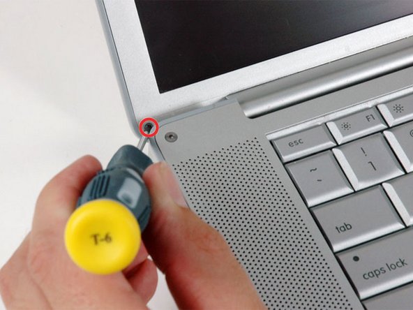

  • Remove the T6 Torx screw from the bottom left corner of the display assembly. The computer casing will not allow the screwdriver to be inserted directly into the screw, so be careful not to strip the screw.
Image #1

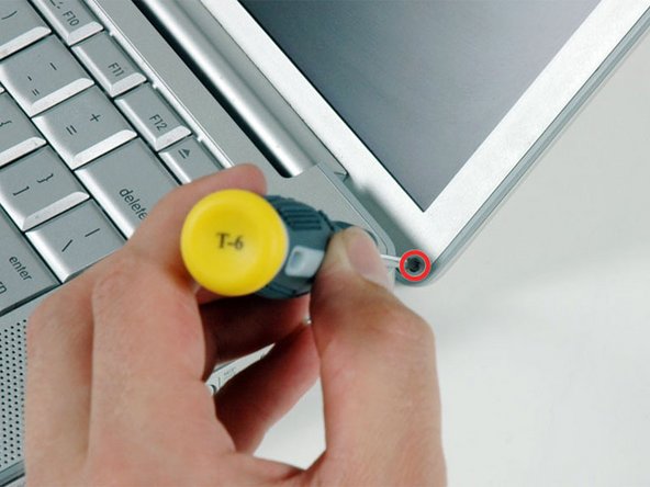

  • Remove the T6 Torx screw from the bottom right corner of the display assembly.
  • To avoid cross-threading these screws during reinstallation, use a pair of tweezers to start each screw in its hole before using your Torx screwdriver to tighten them.

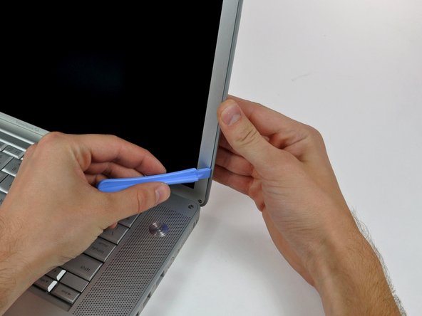

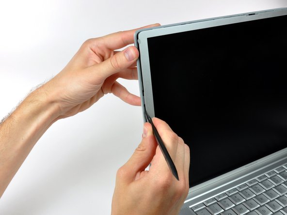

Add Note Edit Step 4  ¶

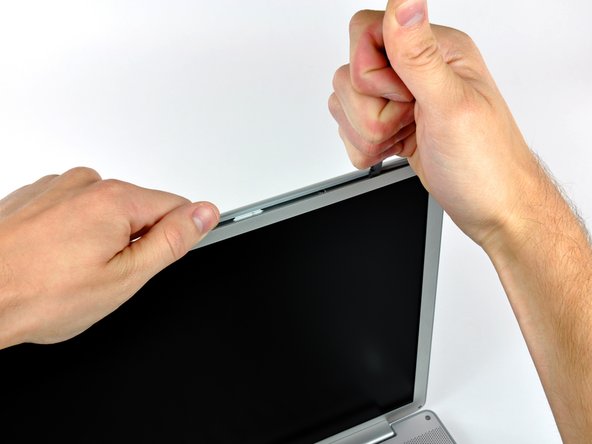

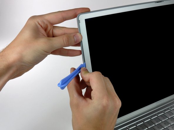

  • The next few steps require the use of plastic opening tools and spudgers that will probably be destroyed in the process. Have a few spares of each tool handy.

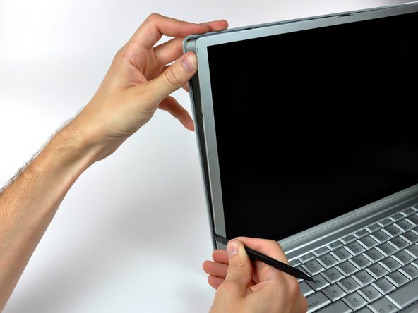

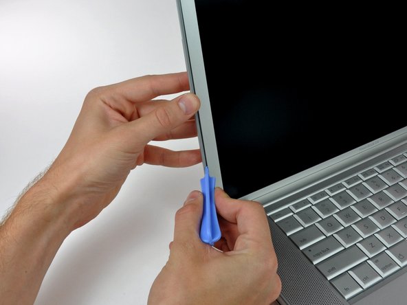

  • Insert a plastic opening tool between the left edge of the front display bezel and the plastic strip attached to the rear bezel, with the edge of the tool angled toward the LCD.
  • Rotate the tool away from the LCD to pop the rear bezel off the tabs on the front display bezel.
  • Work along the left edge of the display until the rear bezel is evenly separated from the front bezel.
  • Freeing these tabs may require some force. Be sure to support the display assembly with your other hand to avoid putting too much strain on the hinges.
Image #1 Image #2

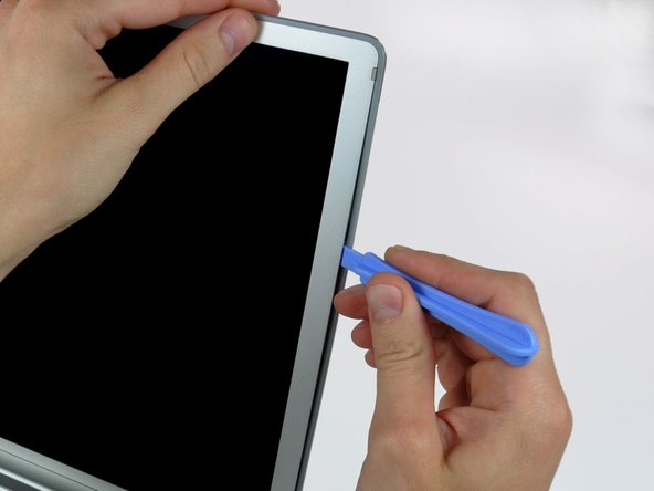

Add Note Edit Step 5  ¶

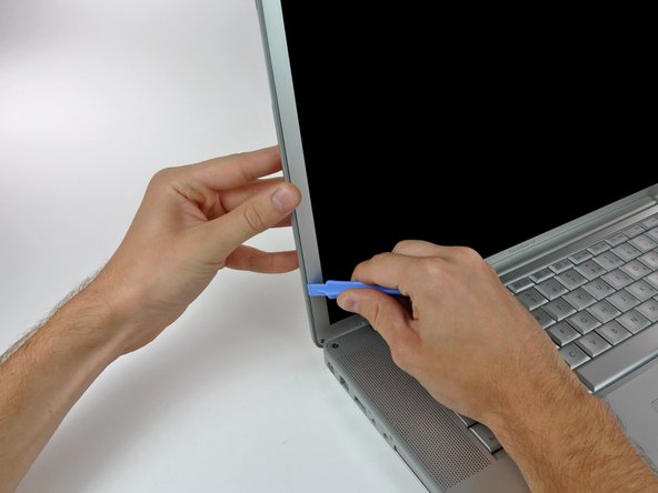

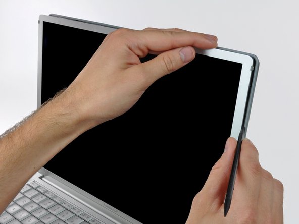

  • Insert a plastic opening tool between the right edge of the front display bezel and the plastic strip attached to the rear bezel, with the edge of the tool angled toward the LCD.
  • Work along the right edge of the display until the rear bezel is evenly separated from the front bezel.
Image #1 Image #2 Image #3

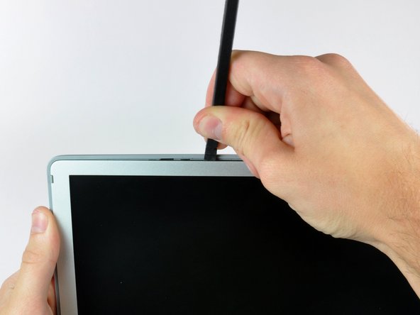

Add Note Edit Step 6  ¶

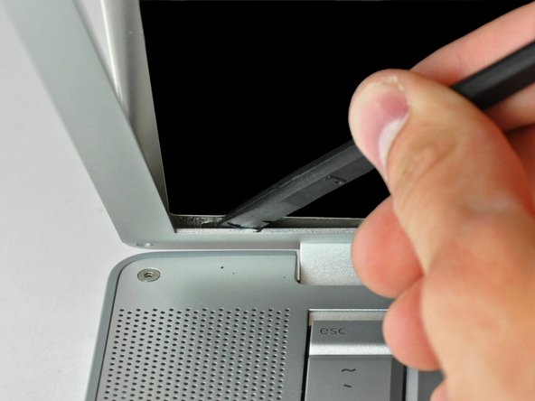

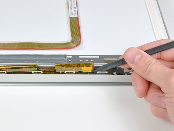

  • Insert a spudger just to the left of the hinge opening on the top edge of the display between the front display bezel and the plastic strip attached to the rear bezel.
  • Pry the rear bezel away from the front bezel along the top left half of the display.
  • If the flat end of your spudger is flexing too much, trim about .125" of the end to increase its stiffness.
Image #1 Image #2

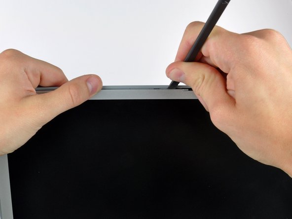

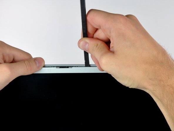

Add Note Edit Step 7  ¶

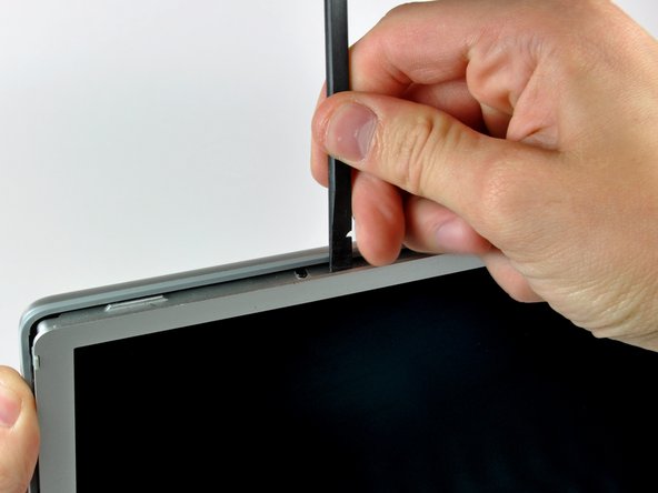

  • Insert a spudger just to the right of the hinge opening on the top edge of the display between the front display bezel and the plastic strip attached to the rear bezel.
  • Pry the rear bezel away from the front bezel along the top right half of the display.
  • To release the clips in the far left and right corners of the display, it may be necessary to run a spudger parallel to the face of the display along the top edge of the front display bezel and force it into the corners to pop the rear bezel off.
Image #1 Image #2

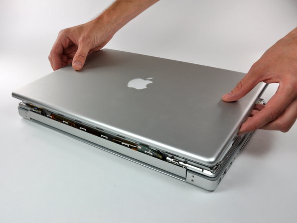

Add Note Edit Step 10  ¶
  • Close the display.
  • The rear bezel is still attached to the display by the antenna cables.
  • Rotate the top edge of the rear display bezel slightly away from the rest of the display, and then lift the lower edge of the rear bezel away from the clutch cover.
Image #1 Image #2

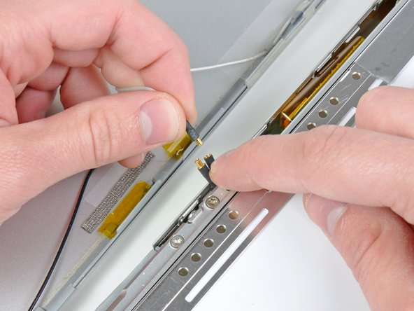

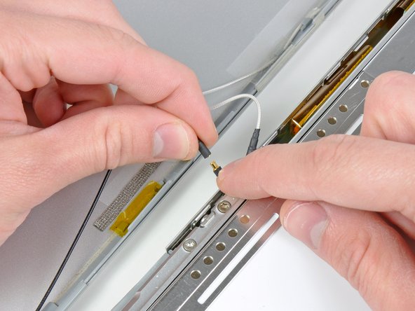

  • Disconnect both antenna cables from the rear display bezel.
  • Rear display bezel remains.

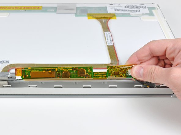

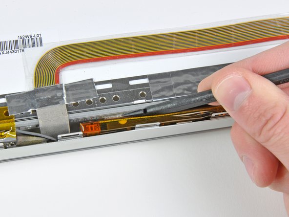

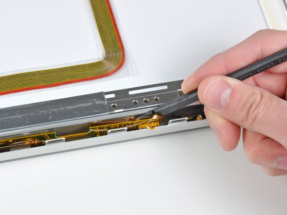

Add Note Edit Step 12 — Display Inverter  ¶
  • If necessary, use the flat end of a spudger to peel the tape securing both ends of the display inverter to the clutch cover.
Image #1 Image #2
Add Note Edit Step 13  ¶

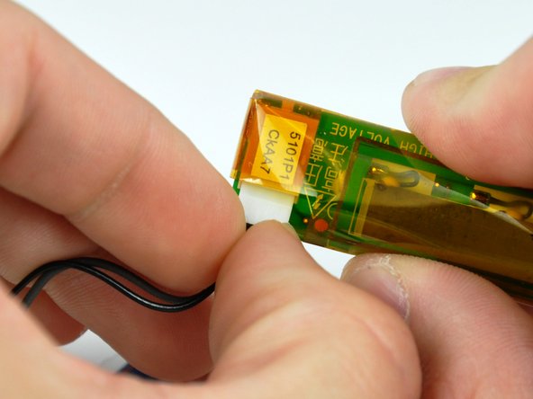

  • The inverter is an extremely thin circuit board that is very delicate and easily cracked. Take care when handling.
  • Using the tip of a spudger, raise the inverter out from the clutch cover.
  • Lift the inverter enough to reveal both cable connectors.
Image #1 Image #2

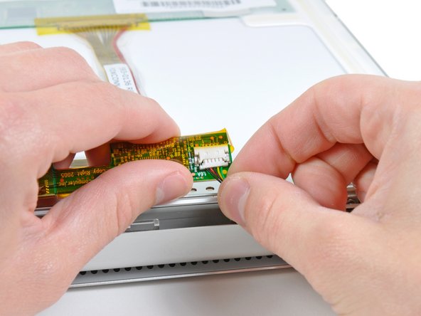

Add Note Edit Step 14  ¶
  • Disconnect both inverter cables by pulling their connectors away from the sockets on the inverter board.
  • Remove the inverter from the display.
Image #1

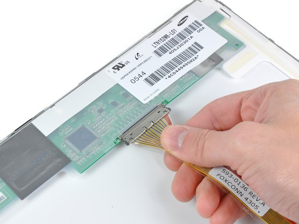

  • If necessary, remove the piece of tape covering the display data cable connector.
  • Pull the display data cable connector away from its socket to disconnect it from the LCD.
Image #1

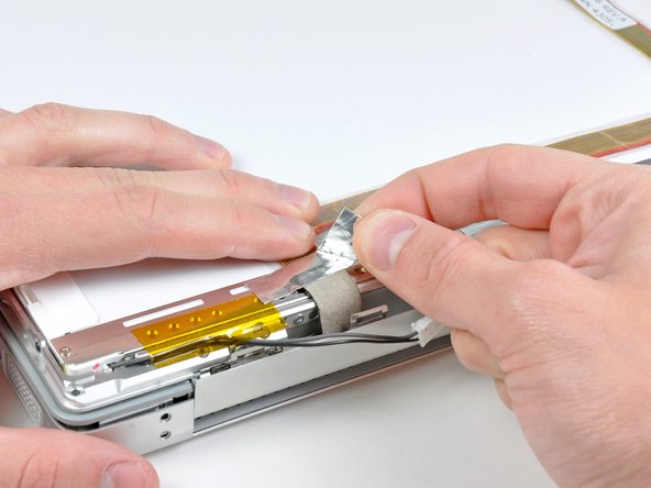

  • Remove the piece of foil tape securing the display data cable to the LCD frame.

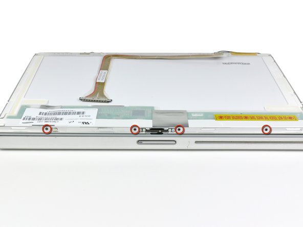

  • Remove the four small 3 mm black Phillips screws along the top edge of the display.
Image #1

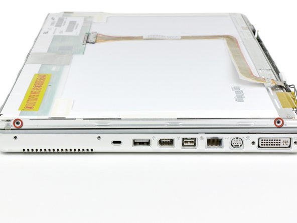

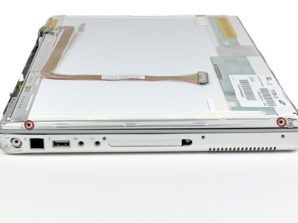

  • Remove the two small 3 mm black Phillips screws along DC-In side of the display.
Image #1

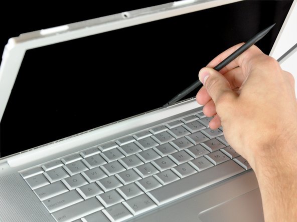

  • Press the display latch release and open the display slightly.
Image #1
Add Note Edit Step 21  ¶
  • Push the LCD away from the front display bezel near its top edge.
Image #1 Image #2

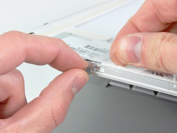

Add Note Edit Step 23  ¶
  • Remove the small magnet near the top left corner of the display, making sure to mark its orientation before removal.
Image #1

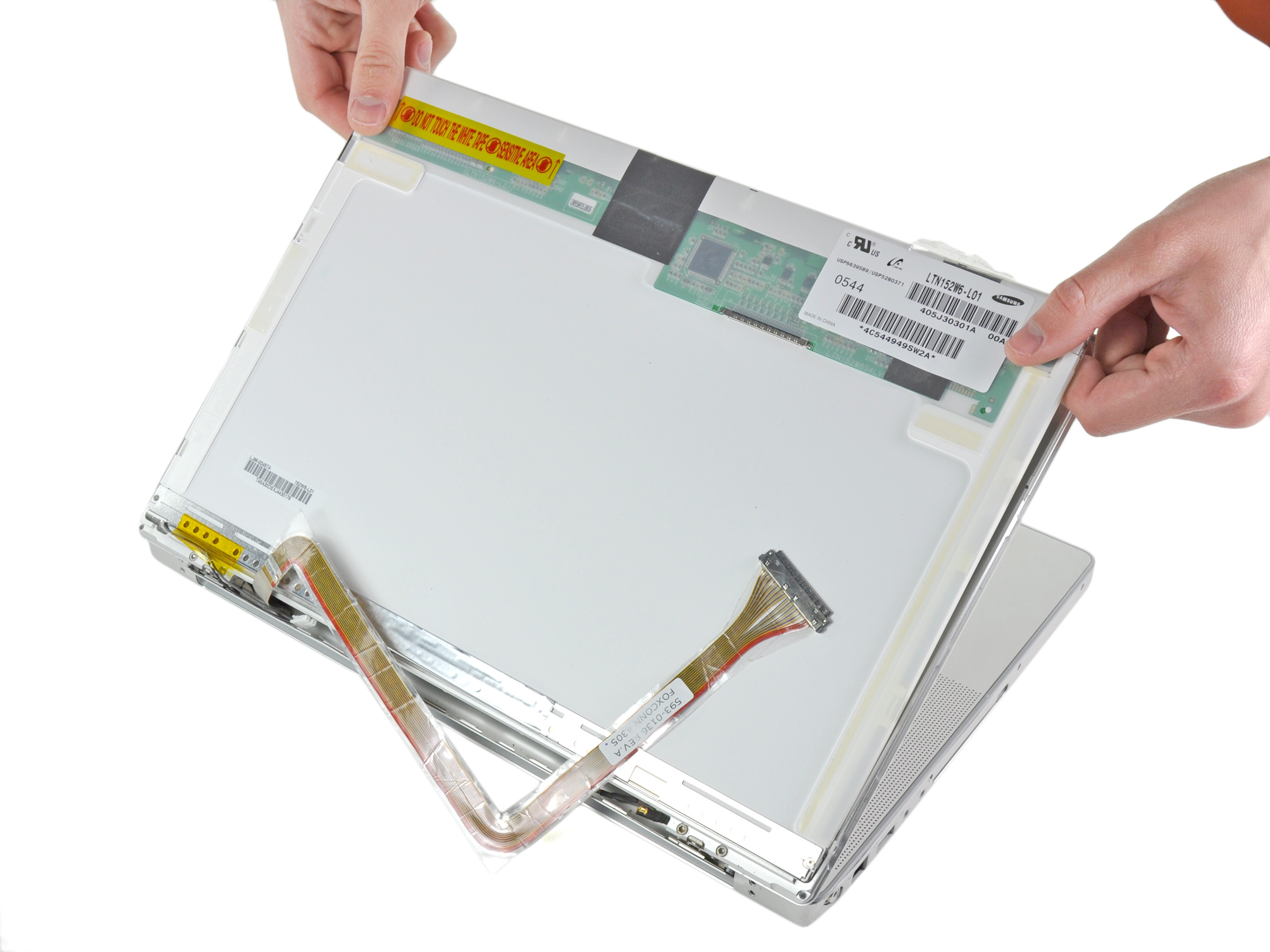

Add Note Edit Step 24  ¶

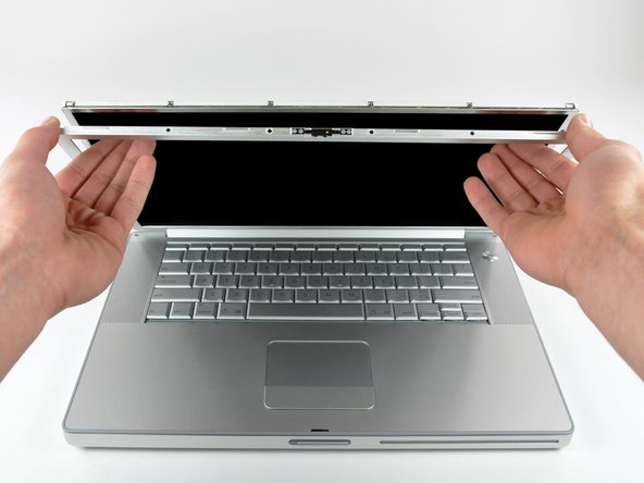

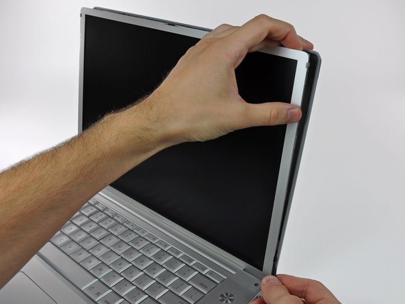

  • Pull the LCD toward the top edge of the front display bezel, minding any cables that may get caught.
