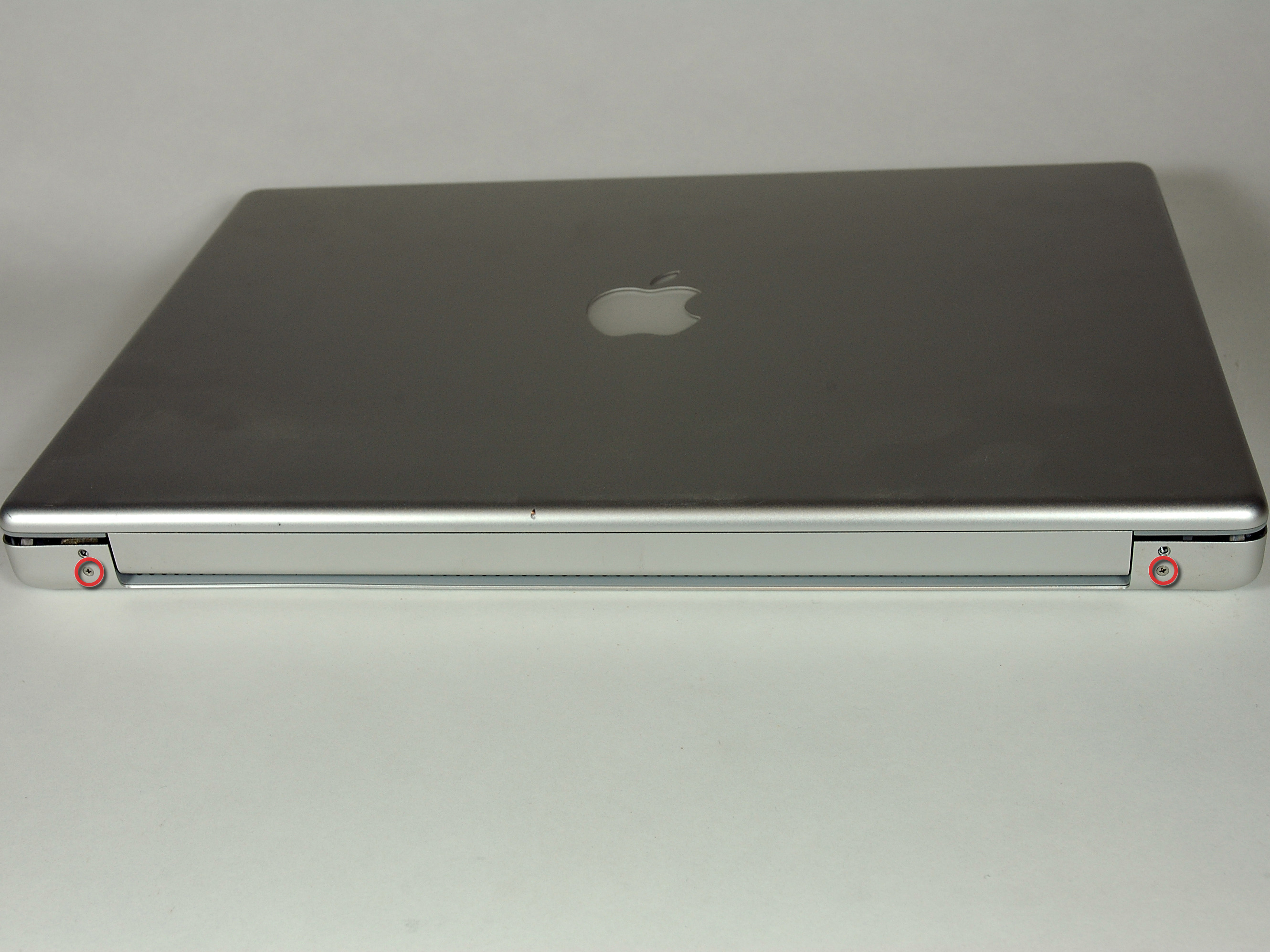

Add Note Edit Step 17 — Display Assembly  ¶
  • Close the display and turn the hinge side of the computer to face you.
  • Remove the remaining 5.2 mm Phillips screws on either side of the hinge (two screws total).

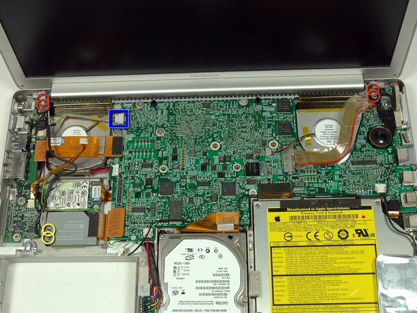

Add Note Edit Step 18  ¶
  • Support the display with one hand as you remove the remaining T8 screws.
  • Remove the upper two full thread 10 mm T8 Torx screws from each side of the display, then the two lower shanked 13 mm screws (four screws total).
  • When replacing the display, make sure that the correct screw pins down the ground loop from the display data cable.
  • Disconnect the two antenna cables from the airport/bluetooth card (shown in yellow circles), as well as the display cable (wide connector right hand upper corner) and the cable on top left corner of the logic board (shown in blue square).
Image #1
Add Note Edit Step 19  ¶
  • Lift the display assembly off the lower case.
