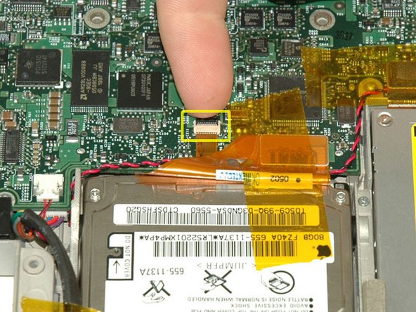

Add Note Edit Step 14  ¶
  • Use your fingernail to flip up the black plastic flap locking the modem cable in place.
  • Slide the modem cable from its connector.
Image #1

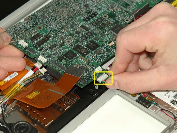

Add Note Edit Step 15  ¶

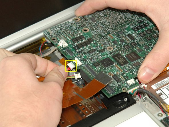

  • Disconnect the 13 indicated cables, removing tape as necessary.
  • When re-installing the board, make sure the two small connectors at the right hand side are above the board before inserting the screws.
Image #1

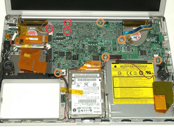

Add Note Edit Step 16  ¶
  • Remove the following 8 Phillips screws from the logic board:
    • Three 6.5 mm in the upper left corner.
    • Five 4.5 mm around the edges.
Image #1

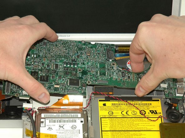

  • Grasp the logic board at the left edge with one hand and at the thinnest section with the other hand. Lift the left edge of the board up to approximately a 30 degree angle (if you don't have your protractor handy, just lift until the DVI port clears the right hinge).
  • Once the logic board clears the ports, slide it out to the left.

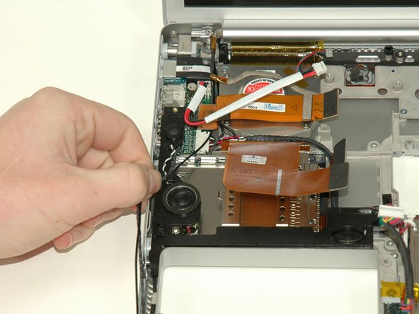

Add Note Edit Step 23 — Speakers  ¶
  • Remove the two 3 mm black Phillips screws from the left ambient light sensor board.
  • Lift the left ambient light sensor board out of the computer, removing tape as necessary.
Image #1
Add Note Edit Step 24  ¶
  • Deroute the Bluetooth and RJ-11 cables from around the left side of the speaker.
Image #1
Add Note Edit Step 25  ¶
  • Disconnect the speaker cable from the DC/Sound card.
Image #1
Add Note Edit Step 26  ¶
  • Remove the 4 mm hex nut from below the left speaker.
  • Remove the 3 mm black Phillips screw from bottom left corner of the speaker assembly, to the left of the battery compartment.
Image #1
Add Note Edit Step 27  ¶
  • Lift the speaker assembly (including the right speaker) out of the computer.
Image #1

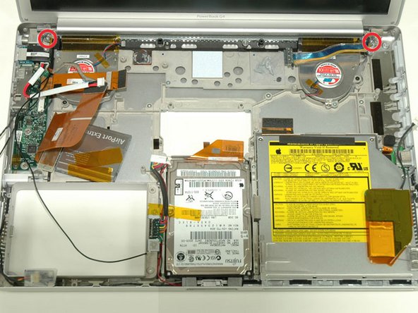

Add Note Edit Step 34  ¶
  • Close the display and turn the hinge side of the computer to face you.
  • Remove the remaining Phillips screw on either side of the hinge (two screws total).
Image #1

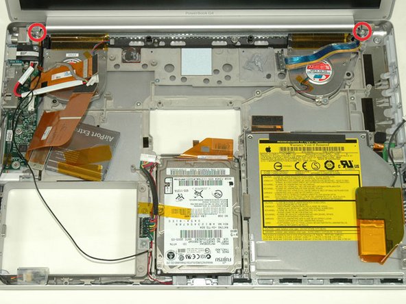

Add Note Edit Step 35  ¶

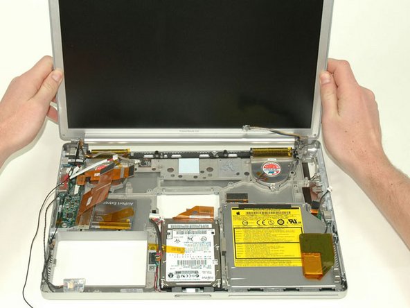

  • Open the display and turn the computer so the screen faces you.
  • Remove the 10 mm T8 Torx screw closer to the display on either side of the hinge (two screws total).
  • When replacing the display, make sure that the right screw pins down the ground loop from the display data cable.
Image #1

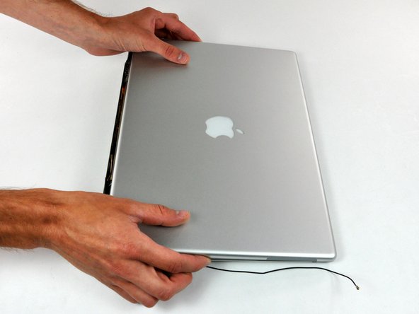

Add Note Edit Step 36  ¶
  • Be sure to support the display with one hand while removing the final two screws.
  • Remove the longer 13 mm shouldered T8 Torx screw remaining on either hinge (two screws total).
Image #1
Add Note Edit Step 37  ¶

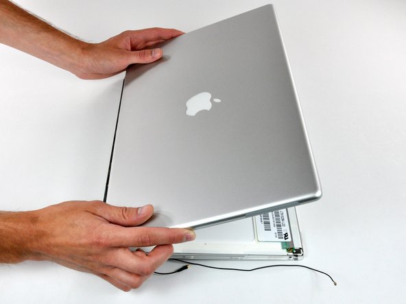

  • Lift the display off.

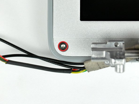

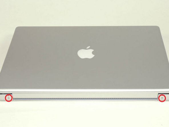

Add Note Edit Step 38 — Rear Display Bezel  ¶

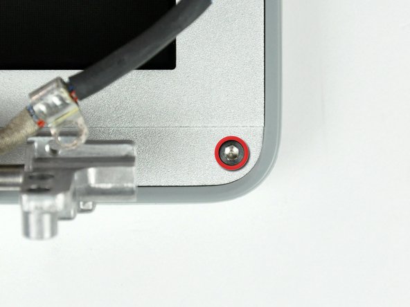

  • Remove the two 11 mm X 1.5 mm hex screws near the lower left and right corners of the display.
  • A T6 Torx screwdriver works just fine.
Image #1

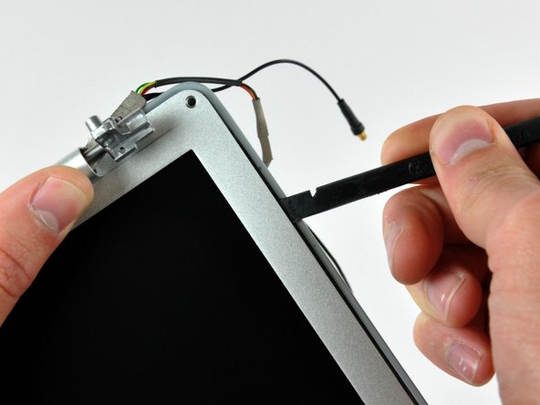

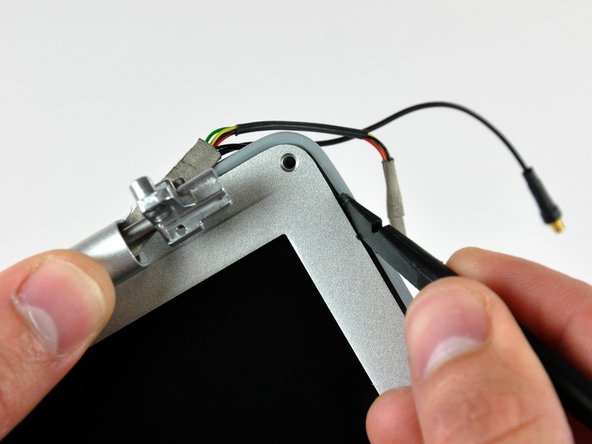

Add Note Edit Step 39  ¶

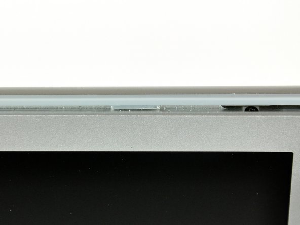

  • Insert the flat end of a spudger between the front display bezel and the plastic rim attached to the rear bezel near the lower left corner of the display.
  • Do not insert the spudger between the plastic rim of the rear display bezel and the aluminum rear display bezel plate.
Image #1 Image #2

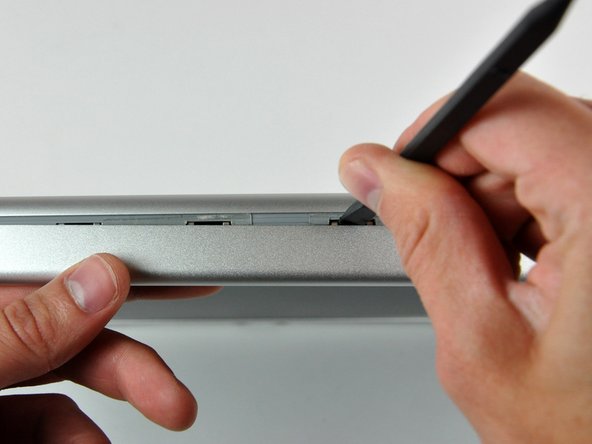

Add Note Edit Step 40  ¶
  • With your spudger still inserted under the front display bezel, run it around the lower left corner of the display.
  • Rotate the spudger away from yourself to pry the rear display bezel off the aluminum tabs on the front display bezel.
  • Work your way down the side of the display until the rear display bezel has been separated from the front display bezel.
Image #1

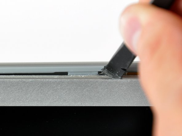

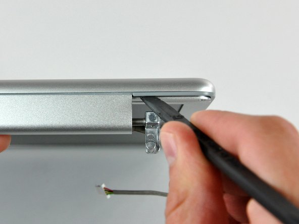

Add Note Edit Step 41  ¶
  • Insert the flat end of a spudger between the rear display bezel and the clutch cover.
  • Twist the spudger to unclip the rear bezel from the clutch cover.
Image #1 Image #2
Add Note Edit Step 42  ¶

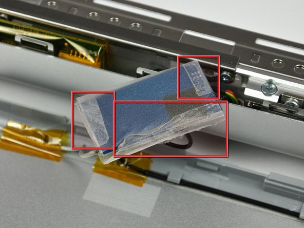

  • Repeat the previous steps to separate the right side of the rear display bezel from the display.
  • Use your spudger to pry the plastic retaining clips on the rear display bezel over the raised aluminum tabs on the front display bezel.
  • At this point, the clips on the left and right edges of the rear display bezel should be free from the raised aluminum tabs on the front display bezel. If they are not, use a spudger to pry them past the front display bezel.
Image #1 Image #2 Image #3

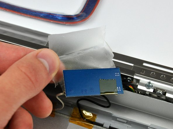

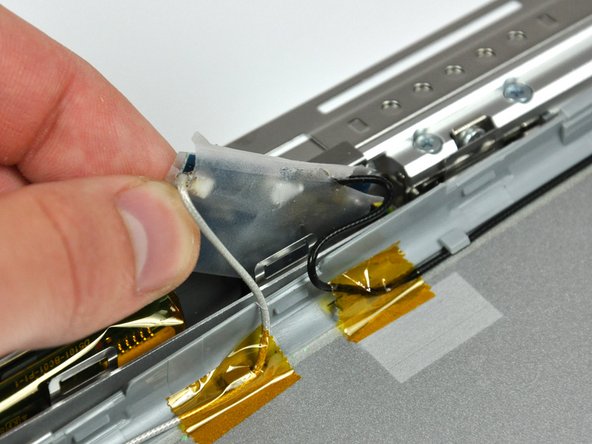

Add Note Edit Step 44  ¶
  • Lift the antenna board out of the clutch cover.
Image #1 Image #2
Add Note Edit Step 45  ¶
  • Peel back the three edges of the antenna board cover and remove it from over the antenna board.
Image #1 Image #2
Add Note Edit Step 46  ¶

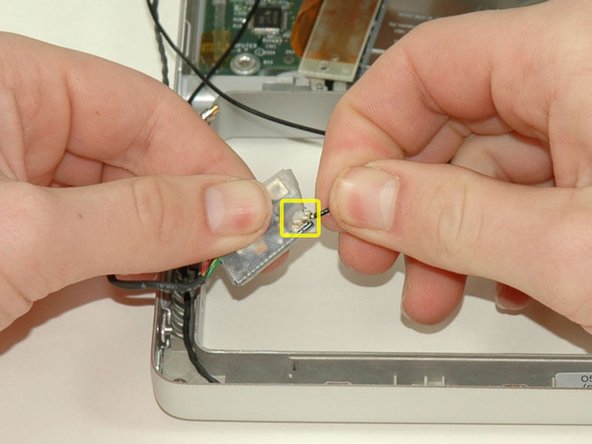

  • Use the flat end of a spudger to pry both antenna connectors up off the antenna board.
  • The black antenna connects near the center of the antenna board.
Image #1

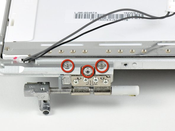

  • Remove the three T8 Torx screws securing the right clutch hinge to the front bezel.
Image #1
Add Note Edit Step 54  ¶

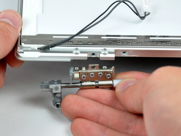

  • Remove the right clutch hinge from the front bezel.
