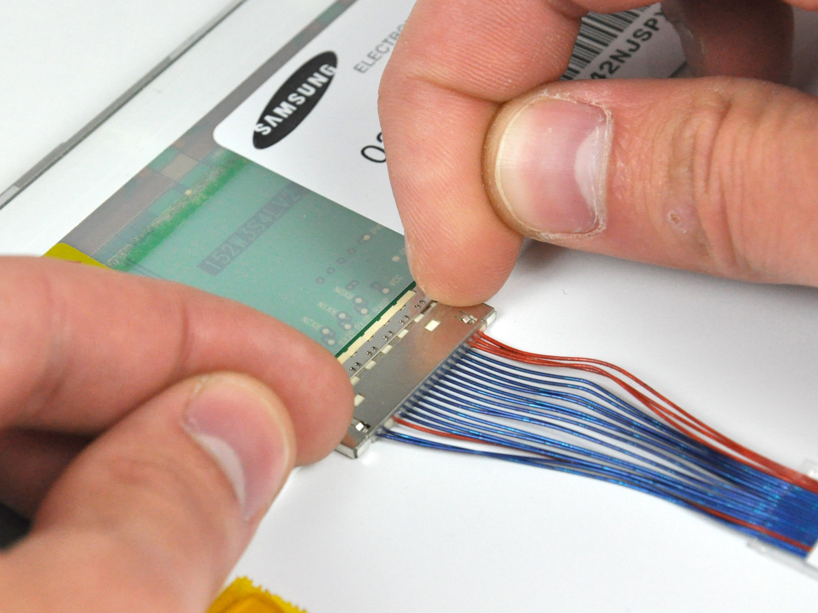

Add Note Edit Step 53 — Display Data Cable  ¶
  • If necessary, remove the piece of tape covering the display data cable connector.
  • Pull the display data cable connector away from its socket to disconnect it from the LCD.
