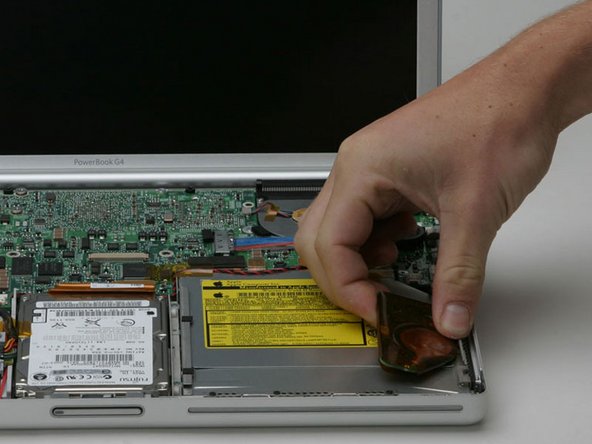

Add Note Edit Step 15 — Optical Drive  ¶
  • Use a spudger to pry up the PRAM battery from the optical drive.
Image #1
Add Note Edit Step 16  ¶
  • Do not disconnect the PRAM battery from the logic board, but simply place it aside, allowing access to the optical drive.
Image #1

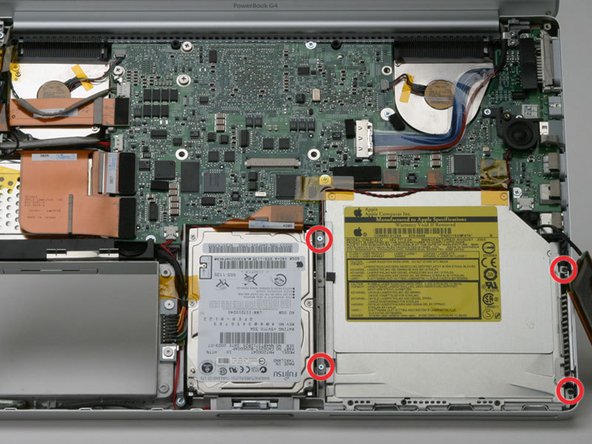

Add Note Edit Step 17  ¶
  • Remove the two short black Phillips screws from the right side of the optical drive.
  • Remove the two longer silver Phillips screws from the left side of the optical drive.
  • Peel back the orange tape from the optical drive.
Image #1

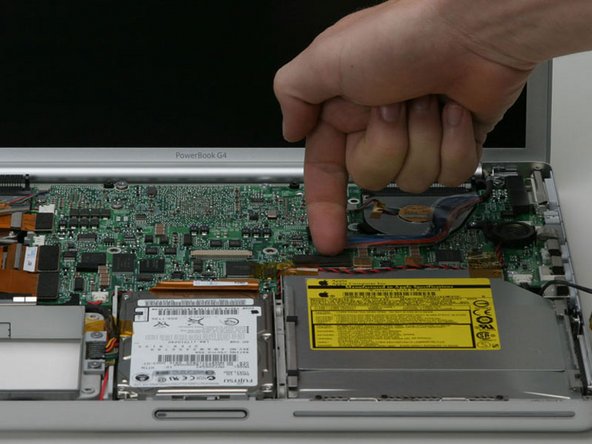

Add Note Edit Step 18  ¶
  • Disconnect the large black connector from the logic board and get out from under the red and black speaker cable.
Image #1

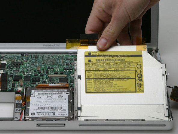

Add Note Edit Step 19  ¶
  • Lift the optical drive out of the computer from the side with the connector on it (mind the small metal bracket that pops out with the drive, keep this with the optical drive).
  • Don't forget the bracket when reassembling the computer.
  • If you have a CD or any other object jammed in your optical drive, we have an optical drive repair guide.

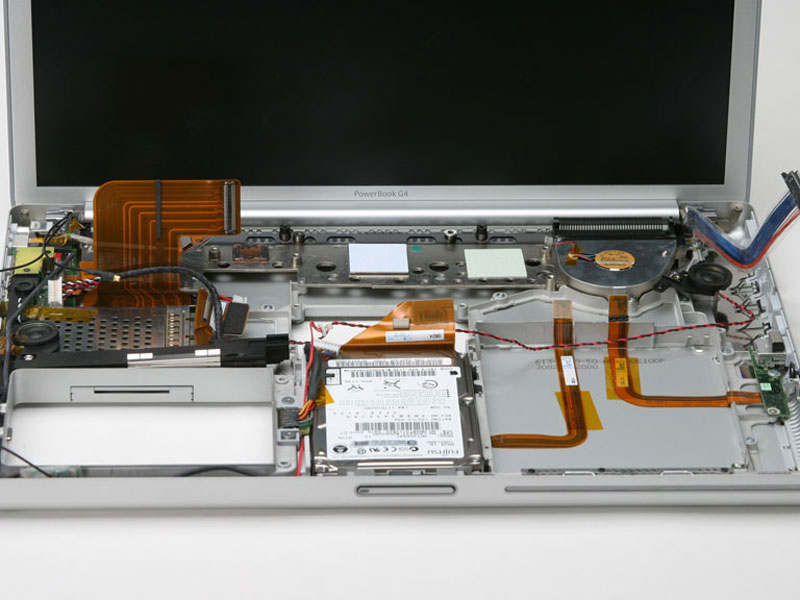

Image #1

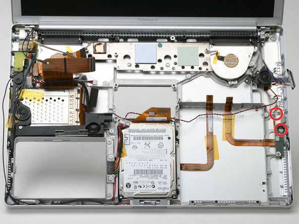

Add Note Edit Step 29 — Right USB Board  ¶
  • Your laptop should look approximately like this.
Image #1
Add Note Edit Step 30  ¶
  • Remove the two Phillips screws from the USB board.
Image #1

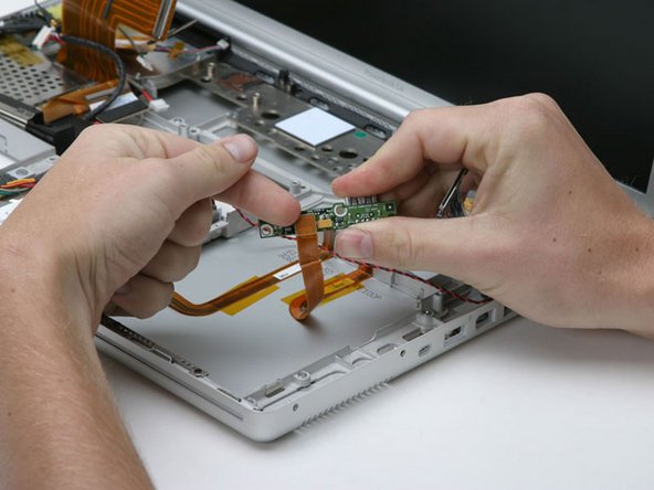

Add Note Edit Step 31  ¶
  • Lift the USB board up and disconnect the orange ribbon cable from beneath it.
