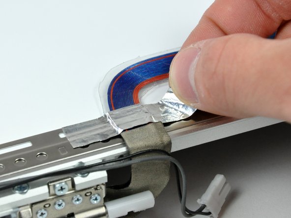

Add Note Edit Step 41  ¶
  • Remove the piece of foil tape securing the display data cable to the LCD frame.
Image #1

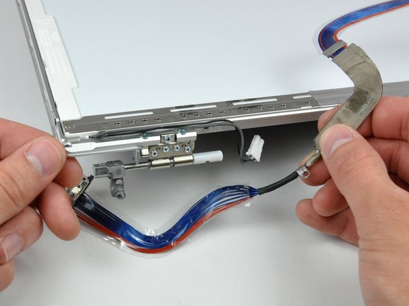

Add Note Edit Step 42  ¶
  • De-route the display data cable from the right clutch hinge and lift it out of the display.
