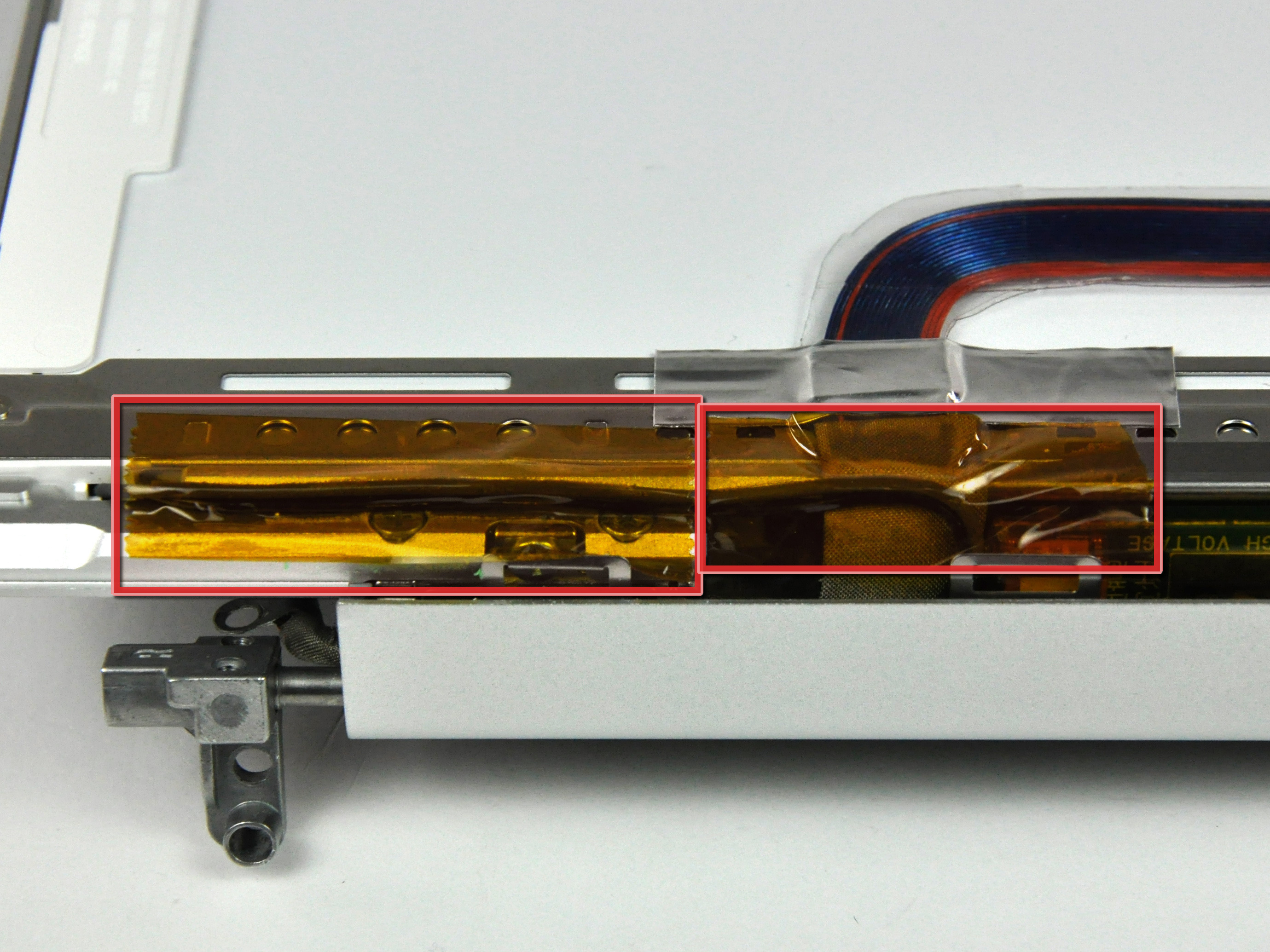

Add Note Edit Step 34 — Clutch Cover  ¶
  • If necessary, remove the two pieces of tape covering the inverter leads.
Image #1 Image #2
Add Note Edit Step 35  ¶
  • The inverter is an extremely thin circuit board that is very delicate and easily cracked. Take care when handling.
  • Use a spudger to raise the end of the inverter out from the clutch cover.
  • Lift the inverter enough to access both cable connectors.
