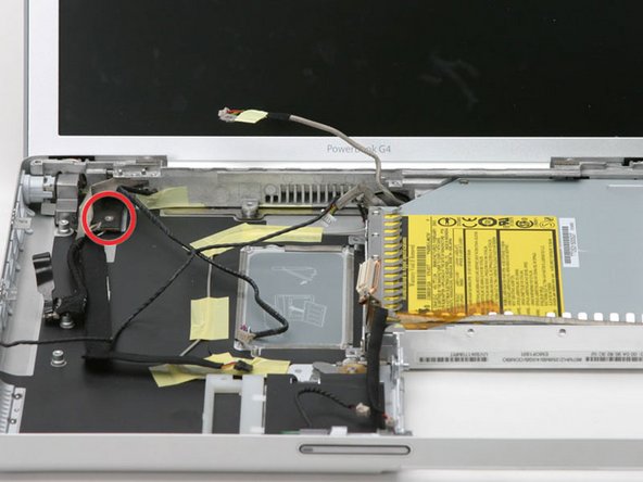

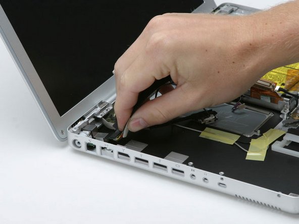

Remove the single Phillips screw securing the hall effect sensor board to the optical drive.
Remove the following five secrews/standoffs from the DC-to-DC board:
One 3.5 mm Phillips in the lower right corner.
Two 3 mm Phillips on either side of the battery contacts.
One 10 mm Phillips in the upper right corner.
One 14 mm long 4 mm standoff in the upper left corner. You can remove this standoff either with a 4 mm nut driver or needlenose pliers.
Remove the following nine screws:
Four 3 mm Phillips allong the left edge and near the fan.
One 4 mm Phillips in the bottom left corner.
Two 6 mm Phillips near the left hinge.
One 9 mm Phillips in the top left corner of the fan.
One 12 mm Phillips just above where the hard drive was located.
Remove the single Phillips screw that attaches the DC-In board to the lower case.
