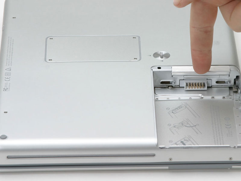

Install an Airport Extreme 802.11g card internally.
With the HTML code below, you can embed this guide as a small widget on your website.
Use a coin to turn the battery locking screw 90 degrees to the right.
Lift the battery out of the computer.
Flip down the door on the right side of the battery compartment.
Use a spudger or flathead screwdriver to disconnect the Airport antenna from the card.
Grasp the plastic tab and pull the card out all the way.
