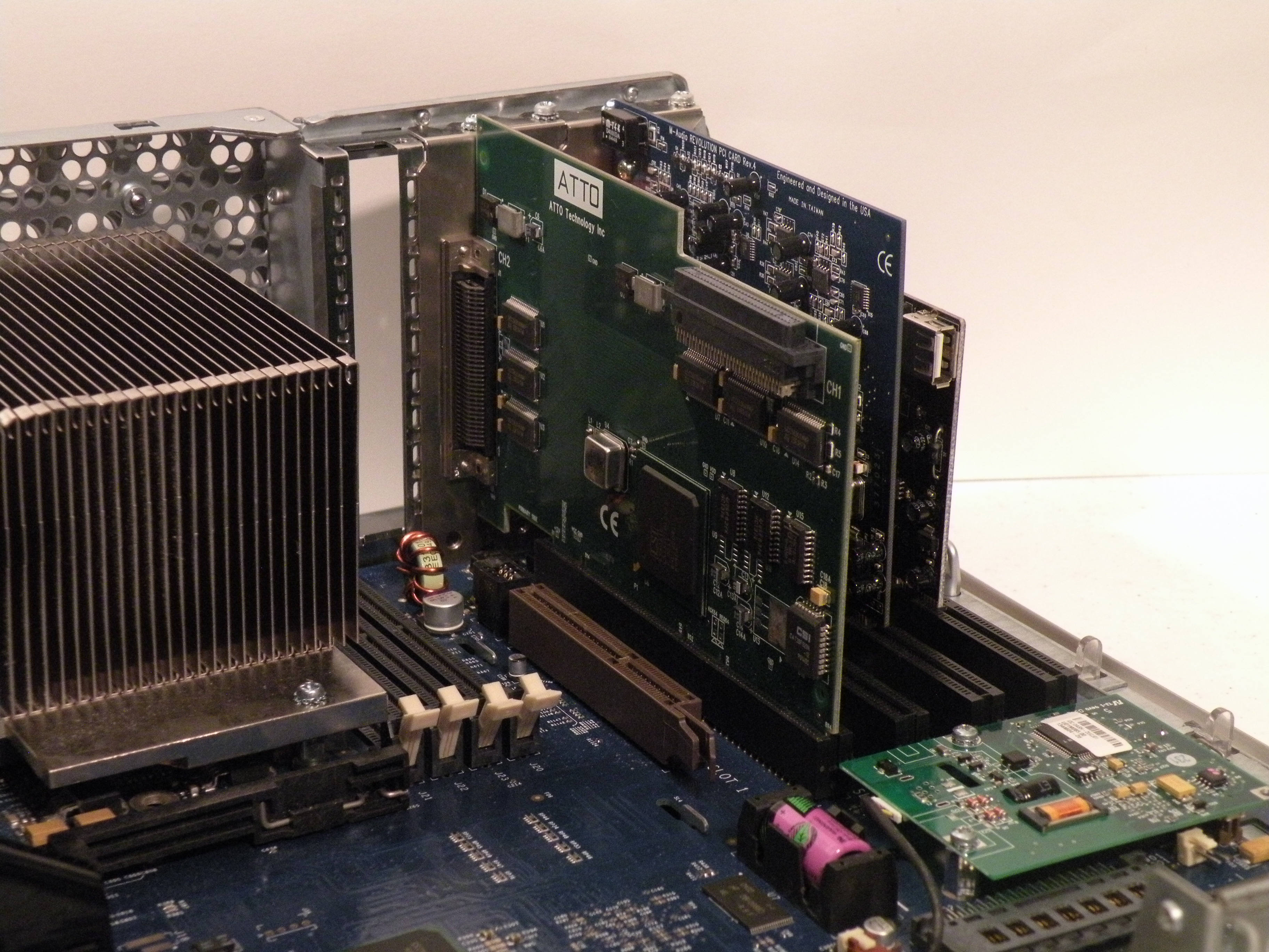

Add Note Edit Step 7 — PCI Cards  ¶
  • The Power Mac G4 MDD Supports four PCI Cards, allowing for SCSI, sound, wireless networking (only AirPort compatible clones) USB, FireWire, etc. The PCI slots do not, however support PCI graphics.
  • Remove the screws for any occupied PCI bays.
Image #1
Add Note Edit Step 8  ¶

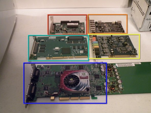

  • Once the screws are removed, pull each card straight up and out of the computer one at a time.
  • The Cards:
  • Adaptec SCSI 50-Pin
  • Adaptec SCSI 68-Pin
  • USB/FireWire Expander
  • M-Audio HD Sound Card
  • NVIDIA GeForce4 Titanium (Mac Edition) DVI & ADC
