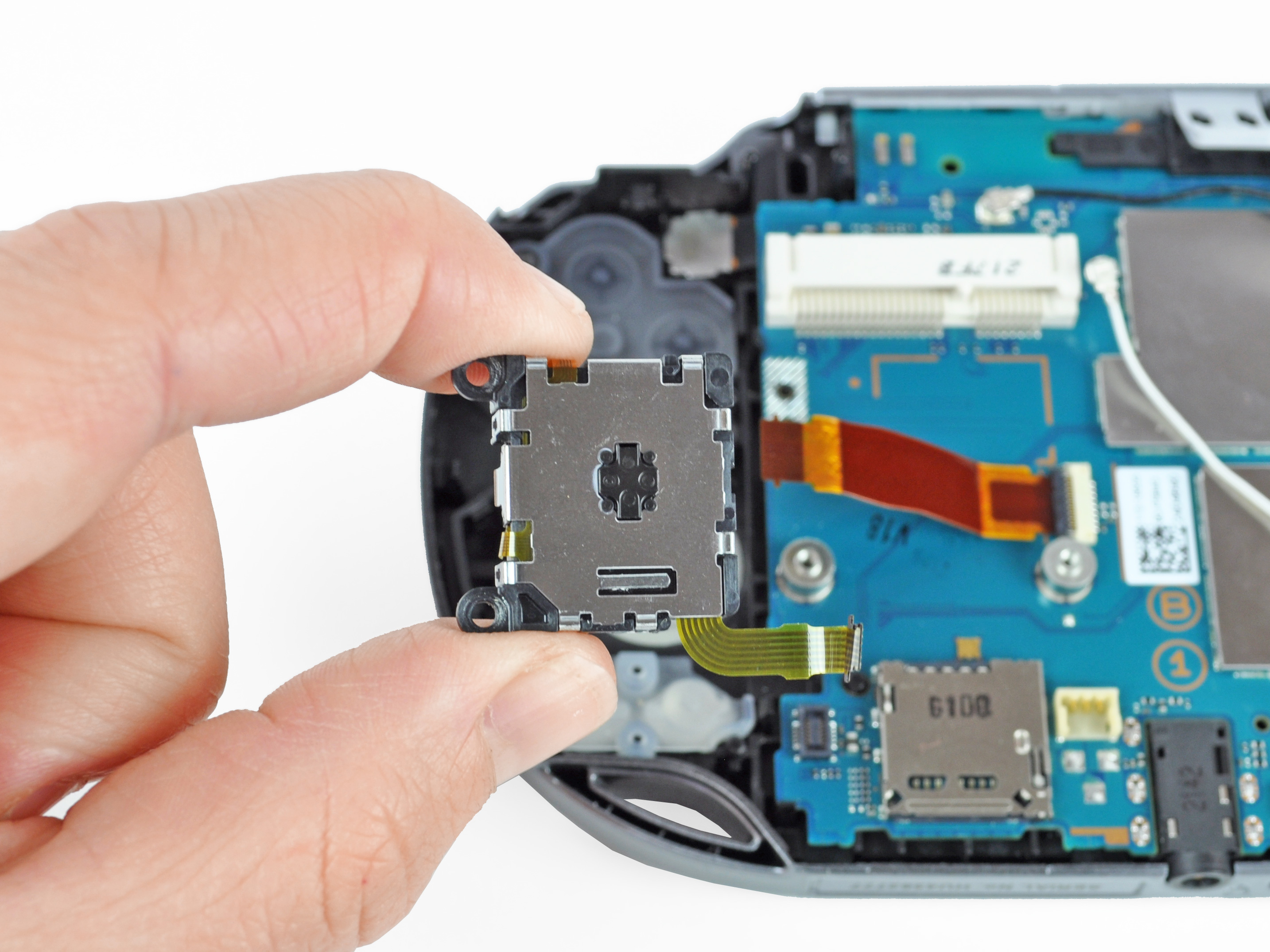

Add Note Edit Step 21 — Right Joystick  ¶
  • Using a Phillips #00 screwdriver, remove the two 5.0mm, blue screws from the right joystick.
Image #1 Image #2 Image #3
Add Note Edit Step 22  ¶
  • Using a spudger, gently pry the joystick out of the back casing assembly.
