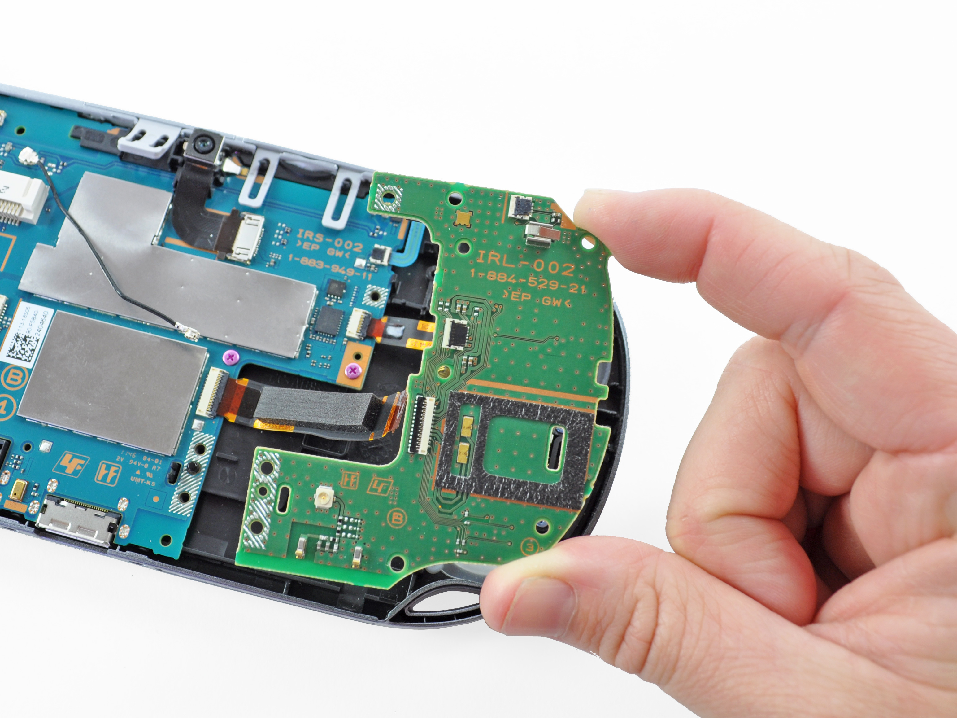

Image #1 Image #2 Image #3
Add Note Edit Step 19  ¶
  • Starting from the upper left corner, use a spudger to pry up and remove the left button board.
