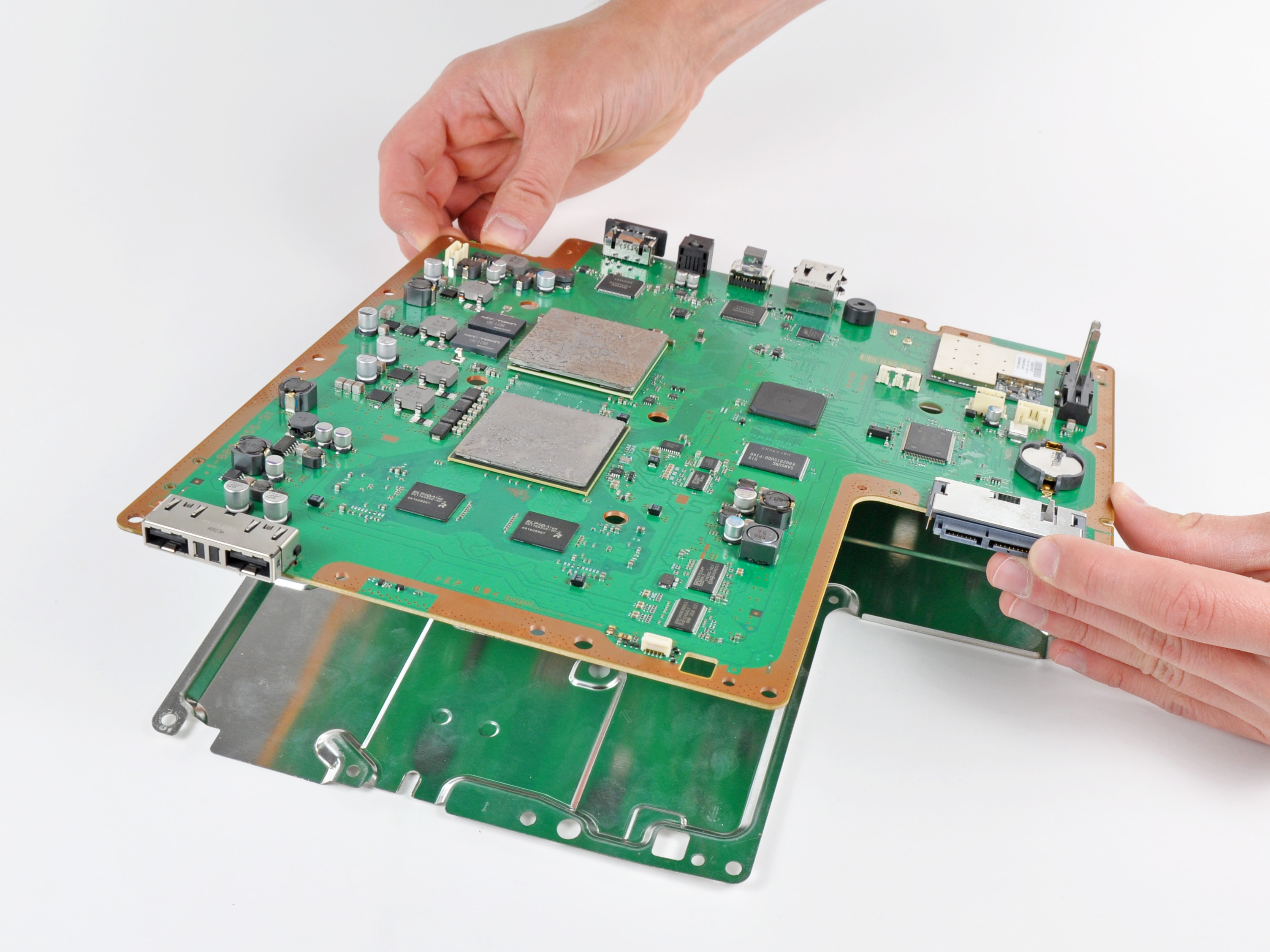

  • While holding the plastic retainer down against the board, use the tip of a spudger to pry the PRAM battery out of its housing.
  • Failure to hold the plastic retainer down during the prying process may result in it tearing off the motherboard.
  • Before installing the heat sink onto the motherboard, it is essential to apply a new layer of thermal paste. This guide will show you how to do it.
