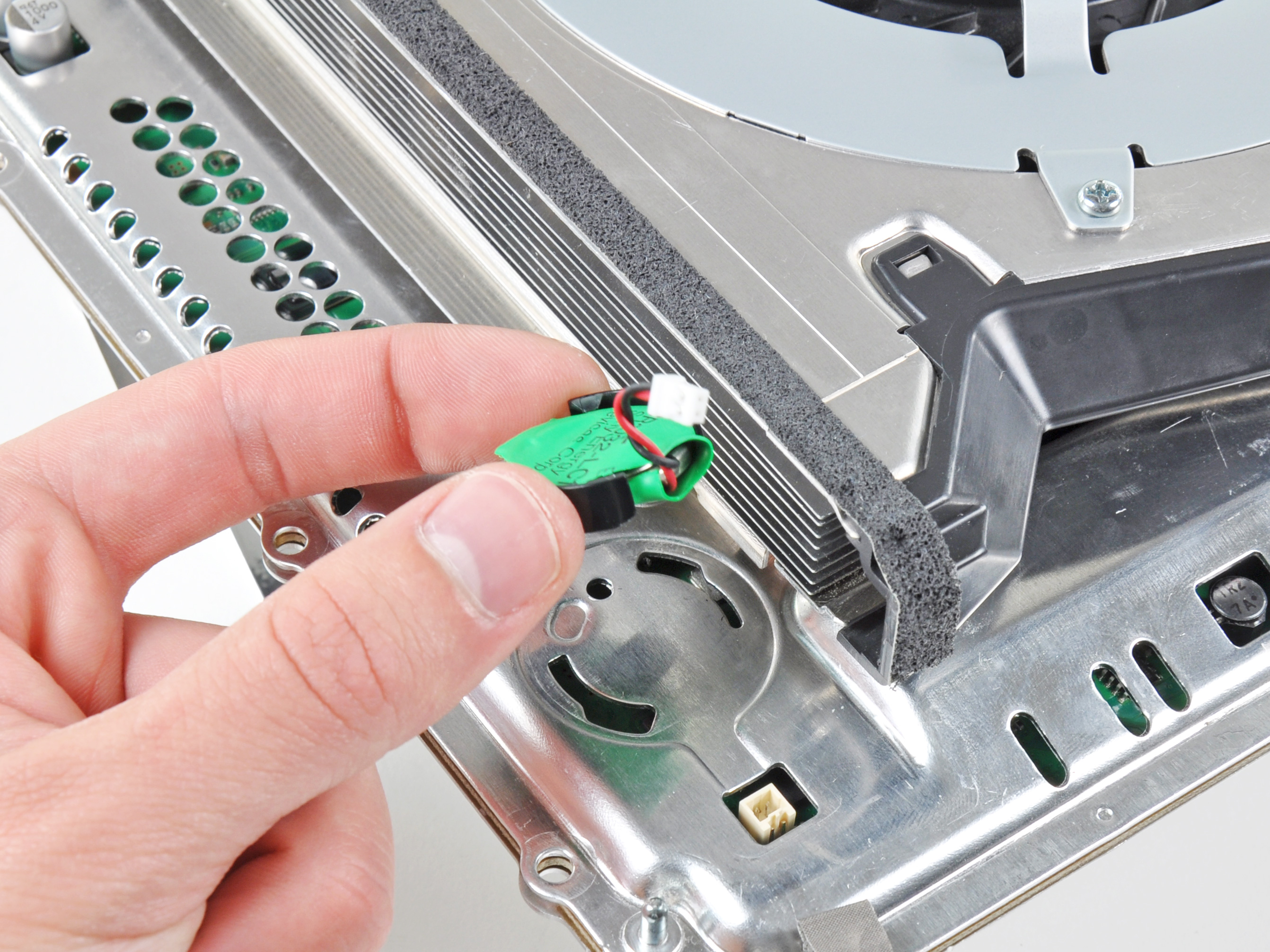

Add Note Edit Step 16 — PRAM Battery  ¶
  • Disconnect the PRAM battery from the motherboard.
  • Be careful when separating the connector from its socket, as the socket easily breaks of the motherboard. If possible, hold down the socket as you lift the connector.
Image #1 Image #2 Image #3
Add Note Edit Step 17  ¶
  • Rotate the PRAM battery counter-clockwise and remove it from the chassis.
