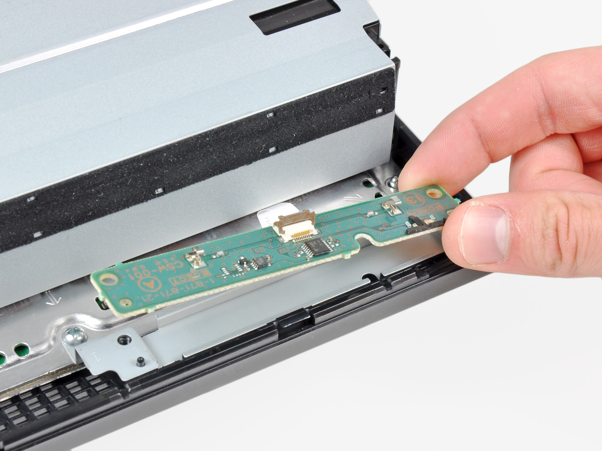

Add Note Edit Step 7 — Control Board  ¶
  • Use your fingernail to flip up the retaining flap on the control board ribbon cable socket.
  • Be sure you are prying up on the retaining flap, not the socket itself.
  • Pull the control board ribbon cable out of its socket.
Image #1
Add Note Edit Step 8  ¶
  • Remove the two 12 mm Phillips screws securing the control board to the lower case.
Image #1
Add Note Edit Step 9  ¶
  • Remove the control board from the lower case.
