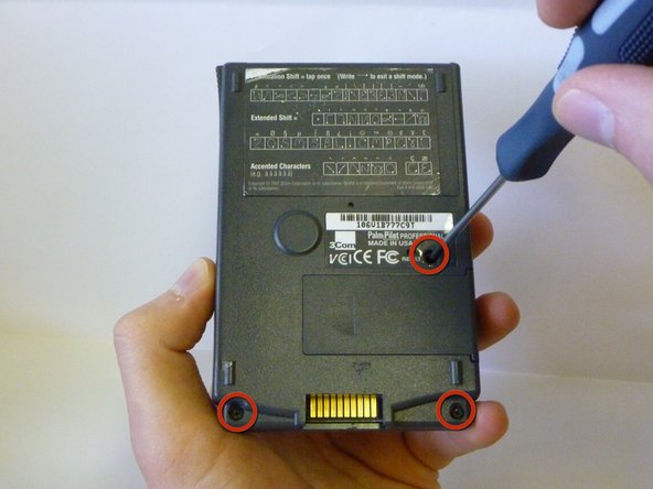

Add Note Edit Step 1 — Keypad  ¶
  • Unscrew the three screws on the back of the Palm Pilot.

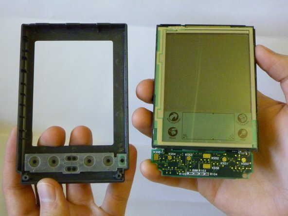

Add Note Edit Step 3  ¶
  • The front plastic cover is now free to be removed from the rest of the device.

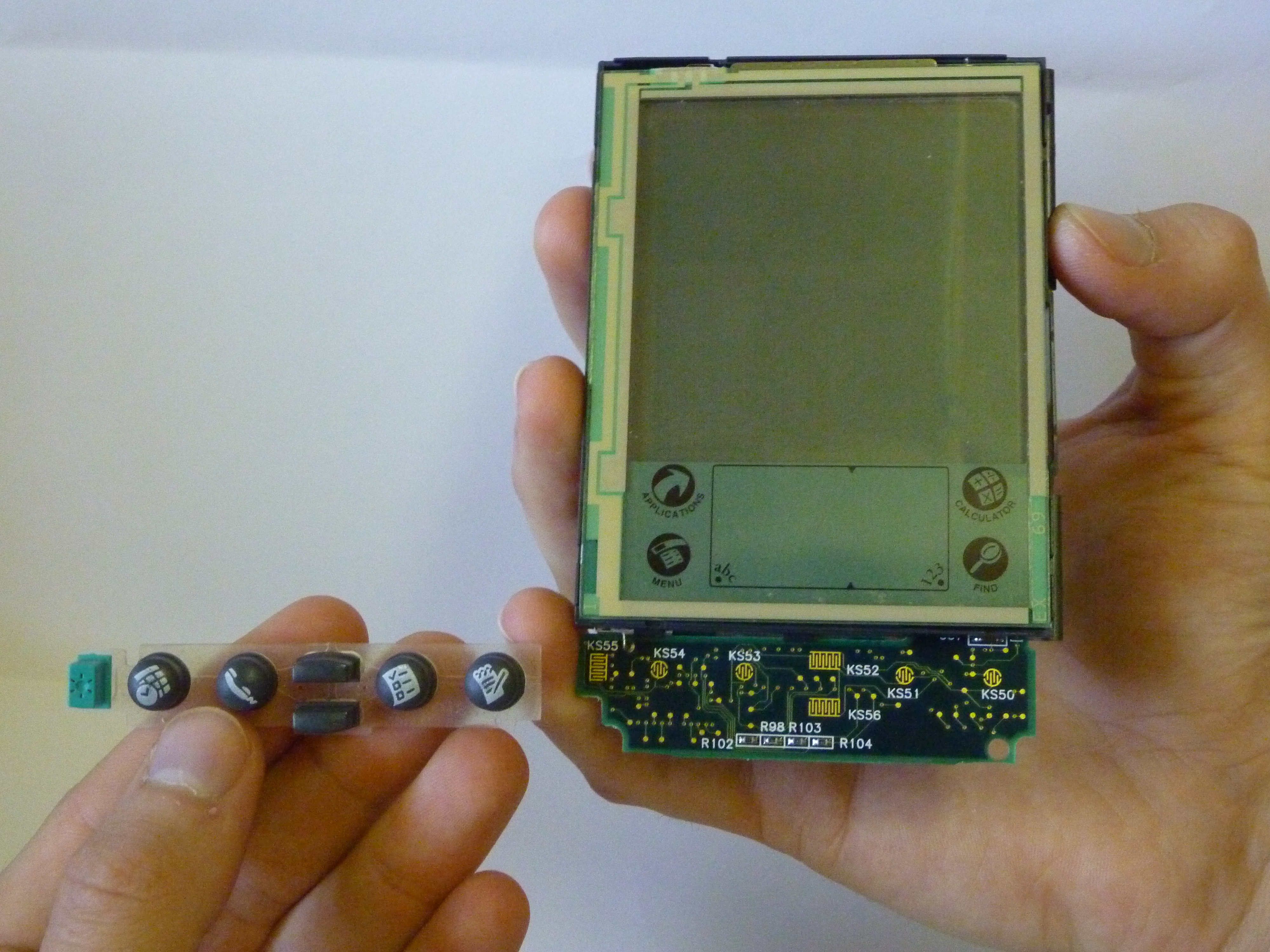

Add Note Edit Step 4  ¶
  • The keypad is now free to be removed from the rest of the device.
