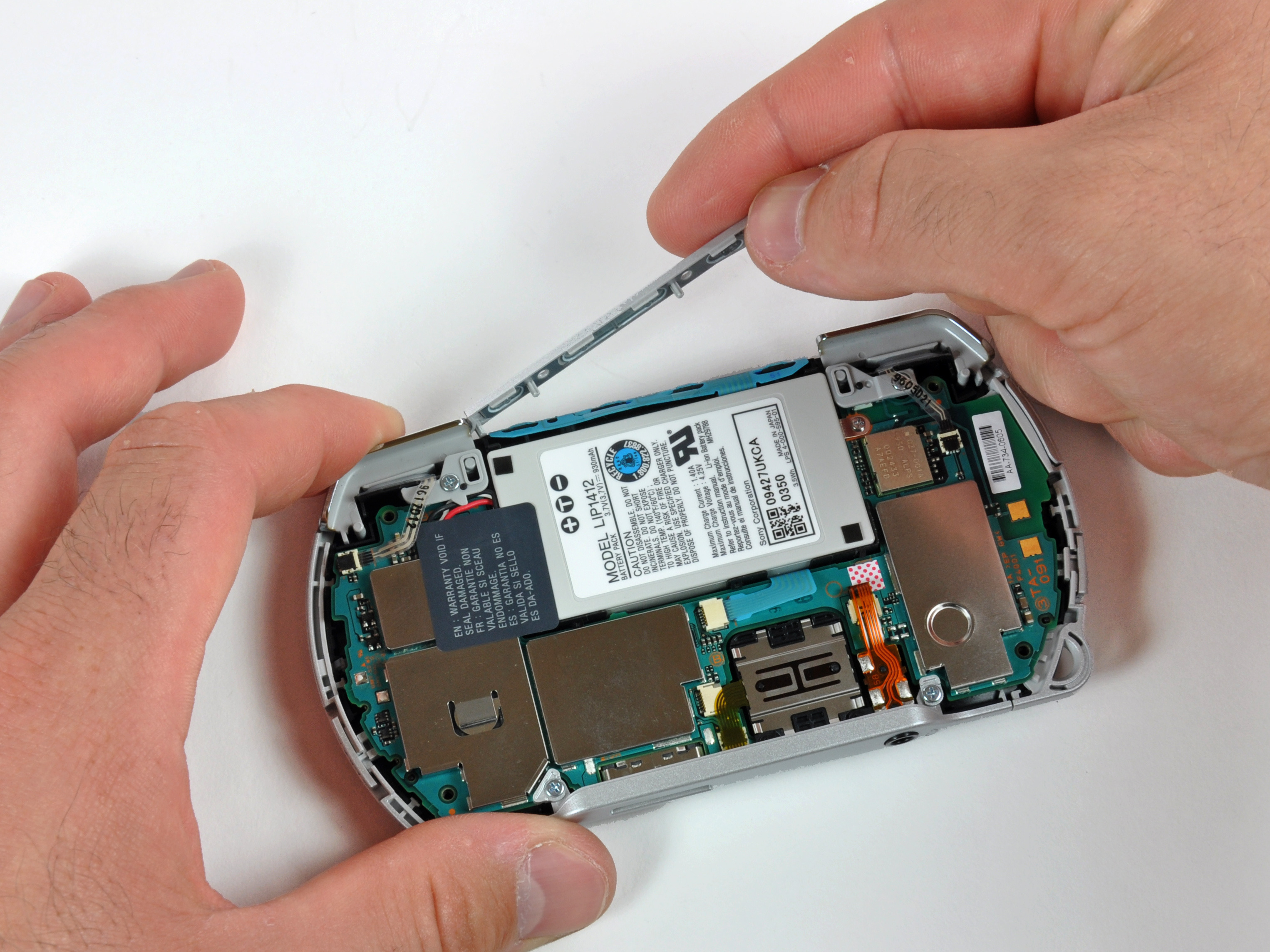

  • Use an PSP Go opening tool around the perimeter of the back cover to loosen it on all sides.
  • Open the back cover by gently lifting the right side, and rotating it to the left side (as if you were opening a book).
  • Be careful not to rotate the back cover from the bottom, as you will break the plastic screw holes on top of the device.
