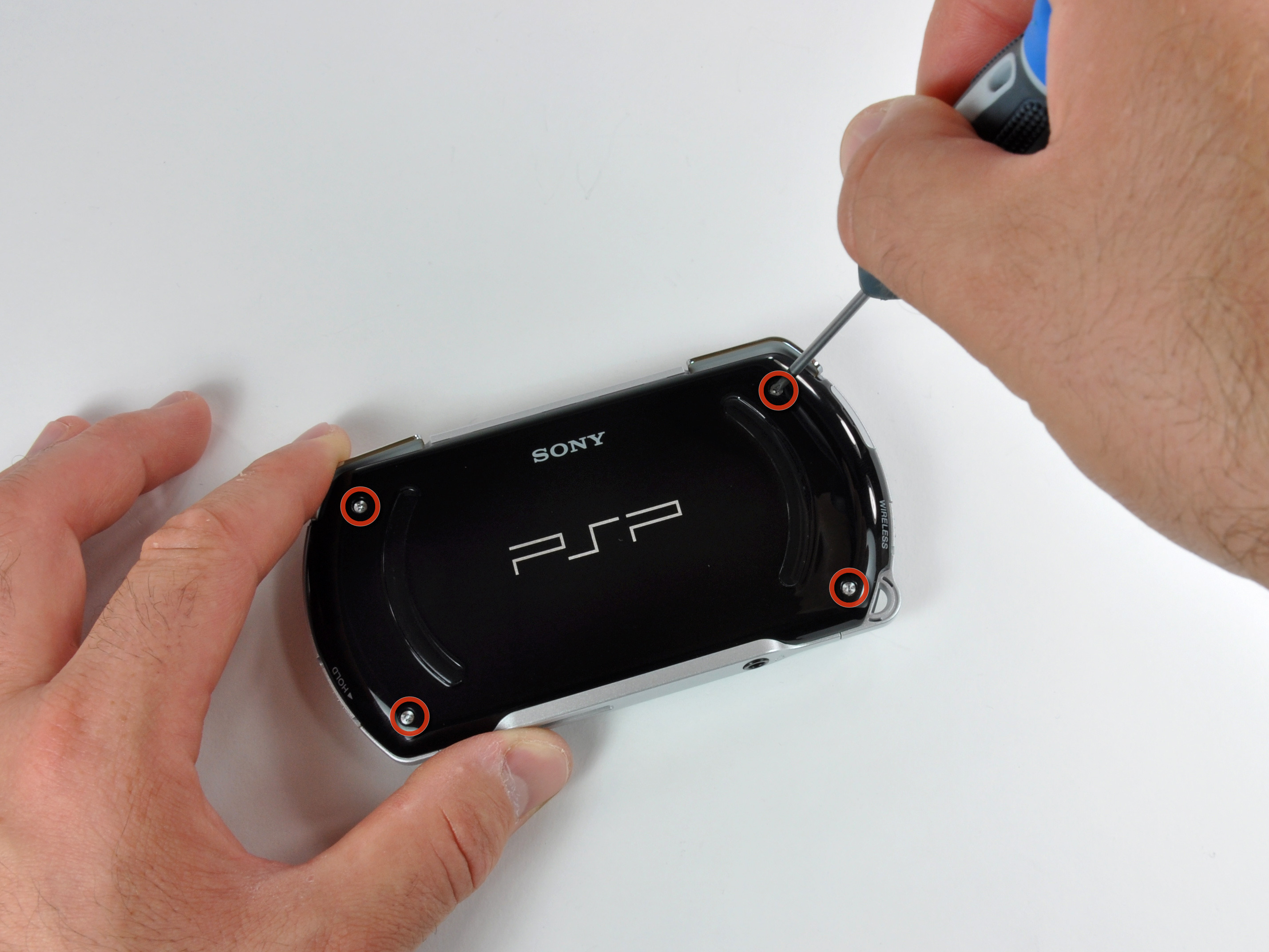

  • Unscrew the four Phillips screws on the back of the PSP Go.
  • Rotate the PSP so you can see the top of the device.
  • Unscrew the two Phillips screws next to the volume buttons.
Image #1 Image #2
Add Note Edit Step 2  ¶
  • Use an PSP Go opening tool around the perimeter of the back cover to loosen it on all sides.
  • Open the back cover by gently lifting the right side, and rotating it to the left side (as if you were opening a book).
  • Be careful not to rotate the back cover from the bottom, as you will break the plastic screw holes on top of the device.
