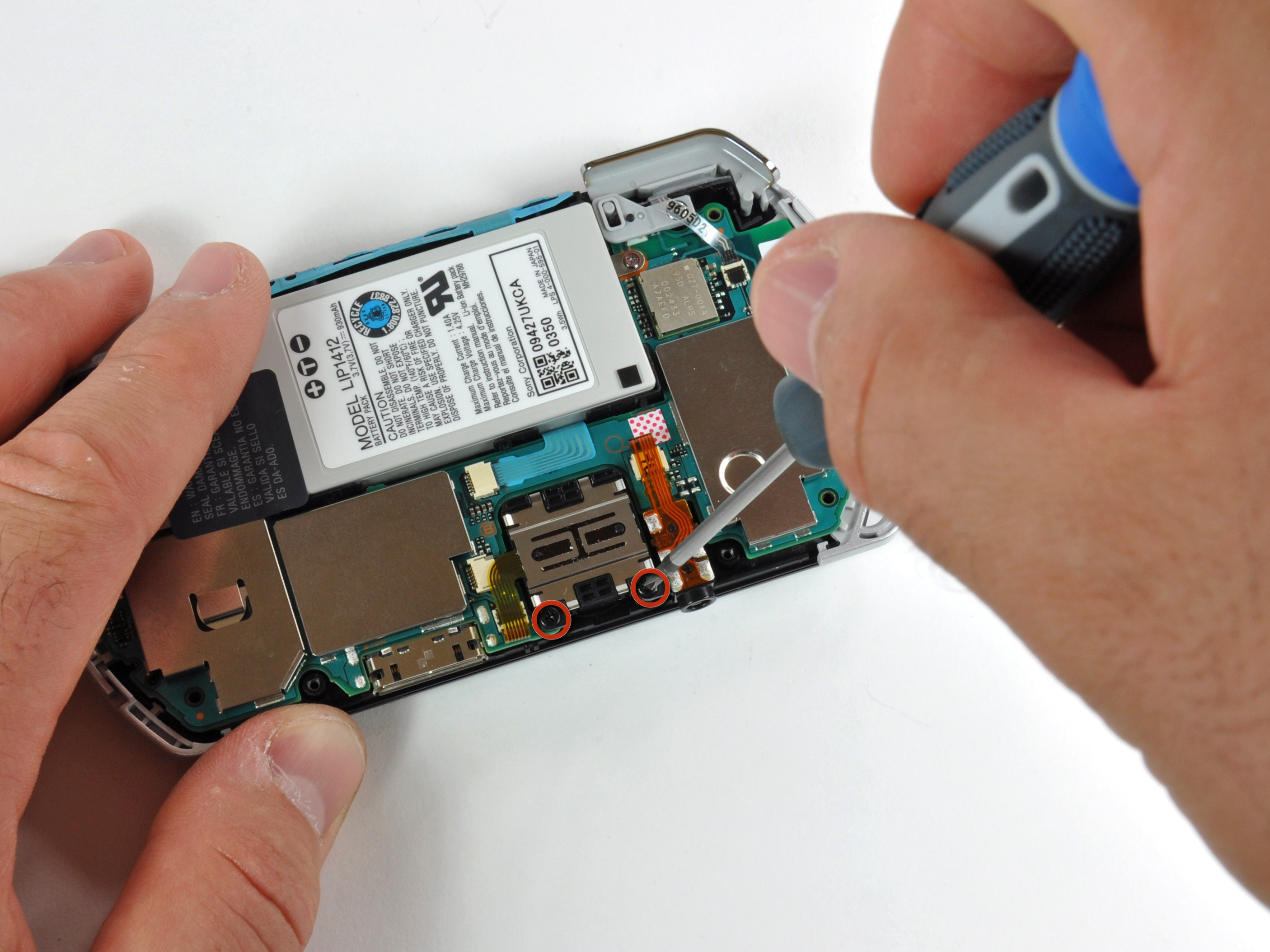

Add Note Edit Step 5 — Analog Joystick  ¶
  • Use a #00 Phillips screwdriver to remove both screws holding the analog joystick in place.
Image #1 Image #2
Add Note Edit Step 6  ¶
  • Use a PSP opening tool to gently flip up the analog joystick's cable connector.
  • Use your fingers or tweezers to gently pull out the analog joystick cable from its connector.
