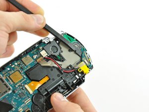

Add Note Edit Step 7 — LCD  ¶
  • Remove a single Phillips screw securing the home bar to the PSP 300xc.
Image #1 Image #2
Add Note Edit Step 8  ¶
  • Push the home bar to the right about 1cm to release a tab, and begin to lift the right end of the home bar slightly.
  • Do not attempt to remove the home bar yet, it is still attached to the PSP 300xc.
