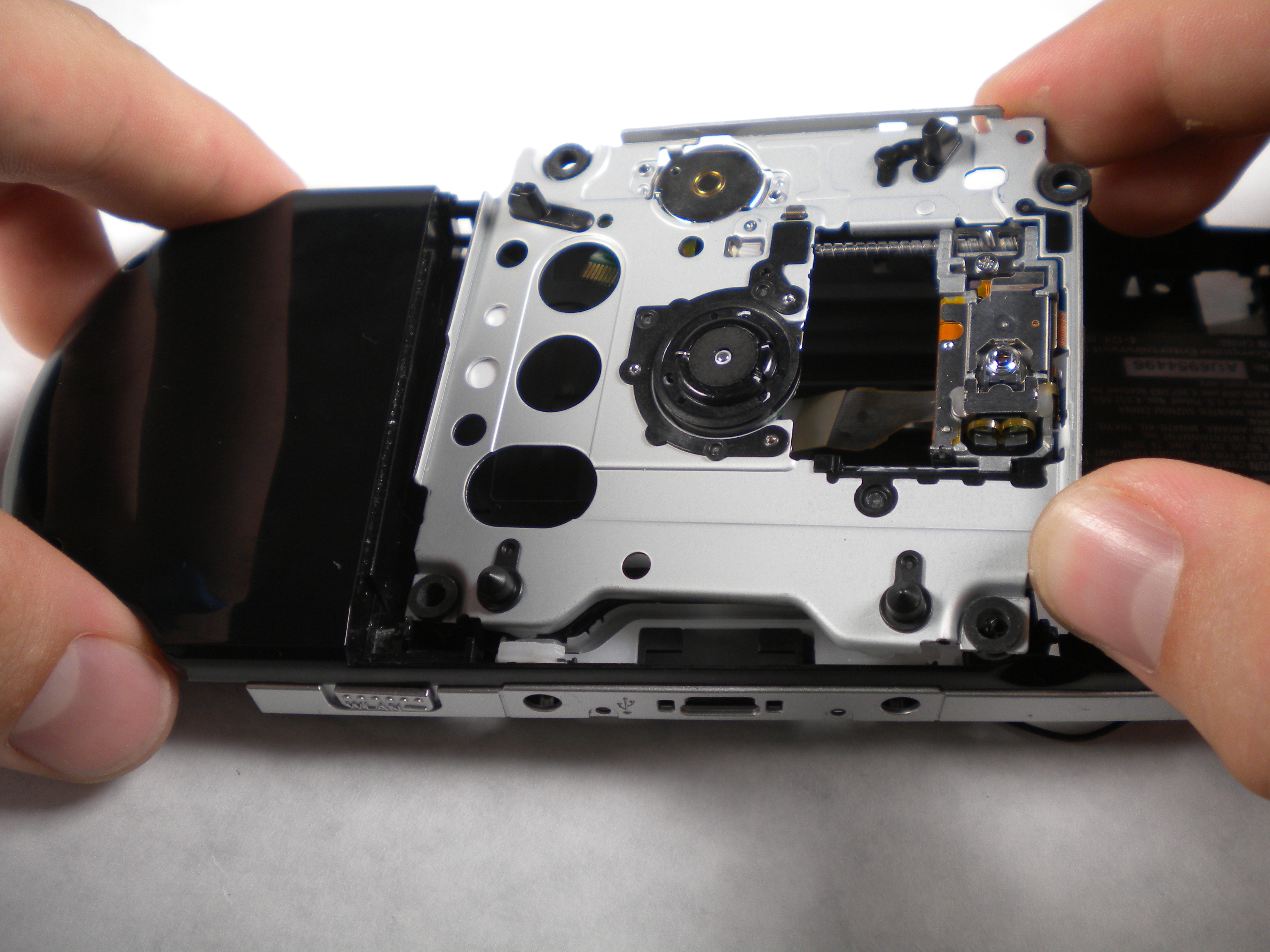

  • Grabbing the PSP with both hands, gently pinch the UMD lid towards the right side (the side without the battery).
  • Pull up and the the left side carefully to remove the lid from the PSP. (The casing may have to flex a little bit to allow this)
Image #1
Add Note Edit Step 42  ¶
  • Remove the four screw from the UMD drive.
Image #1
Add Note Edit Step 43  ¶
  • Remove the UMD Drive.
