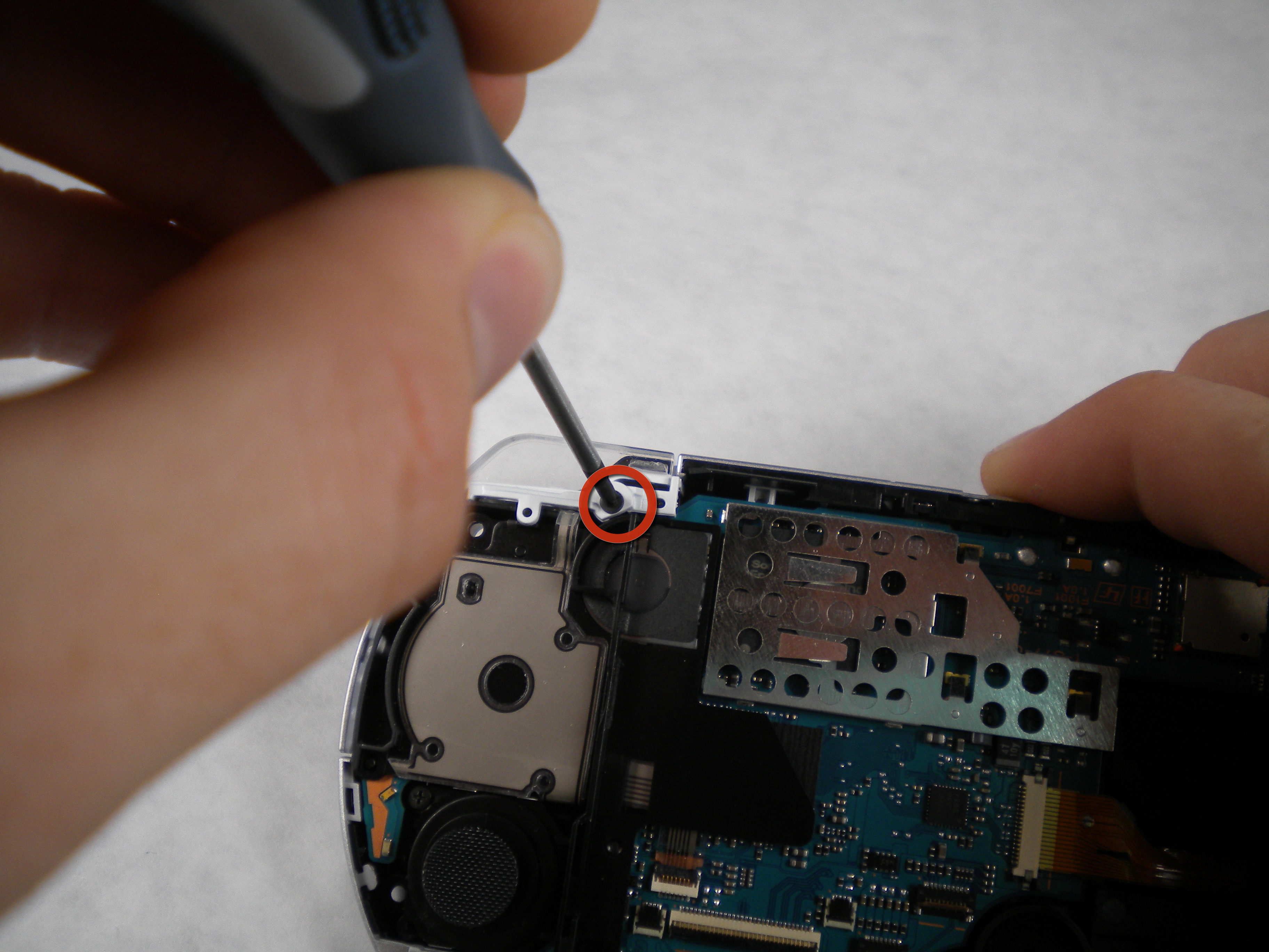

Add Note Edit Step 12 — Trigger Buttons  ¶
  • Remove the screw securing 'L' trigger to the PSP.
Image #1
